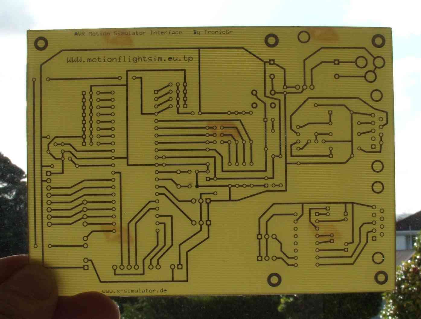

  5. egoexpress
    egoexpress Active Member
    Dec 13, 2006
    3,839
    Germany - Frankfurt/M
    421Coins
    +10 / 1 / -0

    @egoexpress - Nice little piece of pcb! So now we soon see a video of a working SimForceGT?
    BTW: How many working x-sim's are there? I miss some videos of a D.I.Y frex style sim. :wink:
  7. tronicgr
    tronicgr
    Hi Ego, The PCB looks good!
    Can't wait to get mine too! :eek:

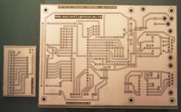

  8. tronicgr
    tronicgr

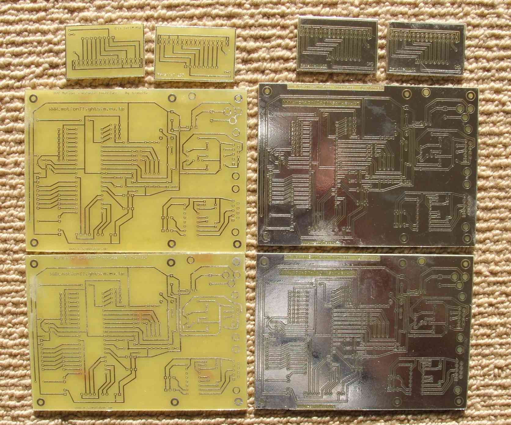

  12. EvanF
    EvanF Member
    Jun 10, 2007
    199
    Multimedia Producer
    New Zealand
    423Coins
    Hi Thanos,
    Probably a dumb question and one asked before. And if I was etching it I would have trialed the sizing manually with paper before printing out onto iron-on transfer but...
    The photoetch company I am getting to etch has asked if the PDF is 1:1 ratio.
    BTW: He is charging NZ$61 for the job not including drilling, so I am happy about that!
    Please let me know soon so I can give him the go ahead!
    thanks
    EvanF

  14. EvanF
    EvanF Member
    Jun 10, 2007
    199
    Multimedia Producer
    New Zealand
    423Coins
    Awesome, thanks!!! I will organise the board to be etched on Monday.
    EvanF

  17. EvanF
    EvanF Member
    Jun 10, 2007
    199
    Multimedia Producer
    New Zealand
    423Coins
    Tada! :razz:
    Christian may have been the first but I have 4!! :twisted:
    But seriously the etching company just etched page 2 of Thanos' PDF and fit it on a standard size sheet twice and charged me NZ$25 for the film work and NZ$25 for the board. Bargain!!
    So a question...which one should I use? The one with least foil or the one with more foil? Does it matter. Shielding consideration?
    And if there are any kiwi's out there who want a board made up I have the filmwork on file at Advanced Circuits so let me know and save some money!
    EvanF
  18. egoexpress
    Dec 13, 2006
    3,839
    421Coins
    +10 / 1 / -0
    Nice! Hurry up with the assembling ;D
    The one with less foil needs more etching fluid. But its easier to DIY and its easier to solder, because you dont shortcut that easy to ground. But in general it makes no differnce which one you use.
  19. tronicgr
    tronicgr
    Hi Evan,
    The PCB's looks good, and they are tinned too! Yes the price was pretty cheap!!!
    Now have patience with the drilling process!!
    I haven't received mine yet... :(
    Thanos
