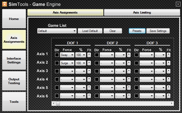

    Fully agree. Only when you have 6 completely independent axis – which is certainly not the case with a Stewart platform – you can use the 3 rotations and 3 accelerations straight out of the plugins. Otherwise you will first have to translate them into the position of the 6DOF platform. And this is where a math plugin would come into play.
  6. yobuddy
    51,704Coins
    +5,204 / 19 / -0
    Because you can mix the outputs in SimTools itself, One motor can output multiple DOF's.
    let's take for example a Rock'n'Ride vs SimForceGT (frex)
    Let's take an old Rock.n.Ride as an example.
    It would use 2 motors - one for Sway and one for Surge.
    The axis assignments would look like this.
    Now take a SimForceGT style char (frex).
    Where they have 2 motors in the back.
    The motors need to work together to achieve Sway and Surge.
    So the axis assignments would look like this.
    Both simulators produce the same output to the rider, but both simulators have their motors in completely different spots.
    I hope this helps!

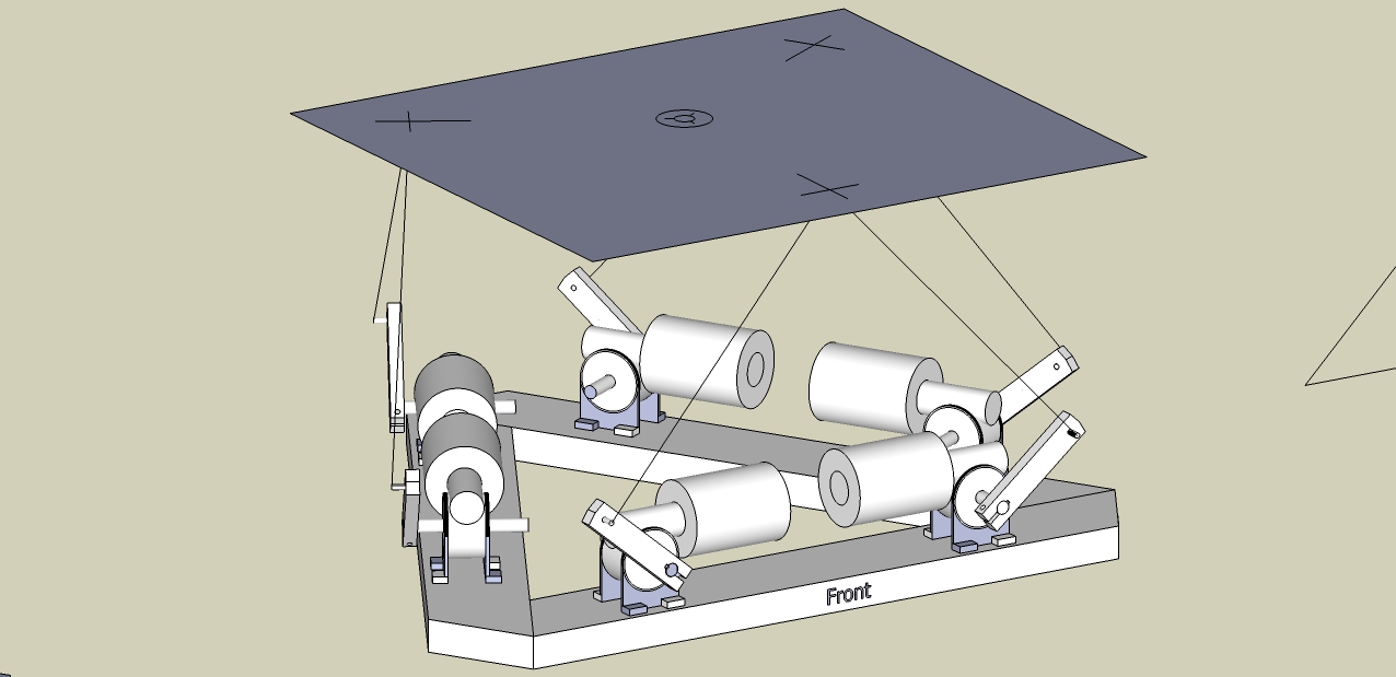

    Hi
    @yobuddy YES PLEASE !!
    At the moment I have a design where the base motor pairs use the same pivot point on the top platform, so in theory without the 6 dof math's, I can use 4 dof, The two that are a problem are Surge and Sway. But with a plugin I can use all six.
    regards Terry

    Not taking anything away from the wiper motor rig its a great effort, but there must be some mixing of the dof outputs, the demo video that best shows the 6 dof independently is this
    Sim Tools makes available the 6 dof force values, but for a true stewart platform these values need to be processed to give the required platform movements without one dof affecting the other.
    I'm not dissing anyone's efforts to create a 6dof platform just using Sim Tools but there must be some interaction and stress on the motors.
    regards Terry

    Imho, the 6dof, as implemented here, is only possible due to its limited range of movement with short levers, and the motor connection points at the platform being spread out evenly and far apart, which allows equal distribution of the platforms weight, but further limits movement while allowing more overshoot/undershoot the system can handle without binding up. I would be willing to bet though, if you could track its motion, it does not track accurately and gives false cueing. Without a math plugin making minor adjustments to all the motors allowing them to work properly in unison, the lack of such adjustments must be borne out in the motion instead!
    But that’s not to take away from the excellent results achieved without using 6dof math and just making a few minor adjustments in the SimTools axis settings!
