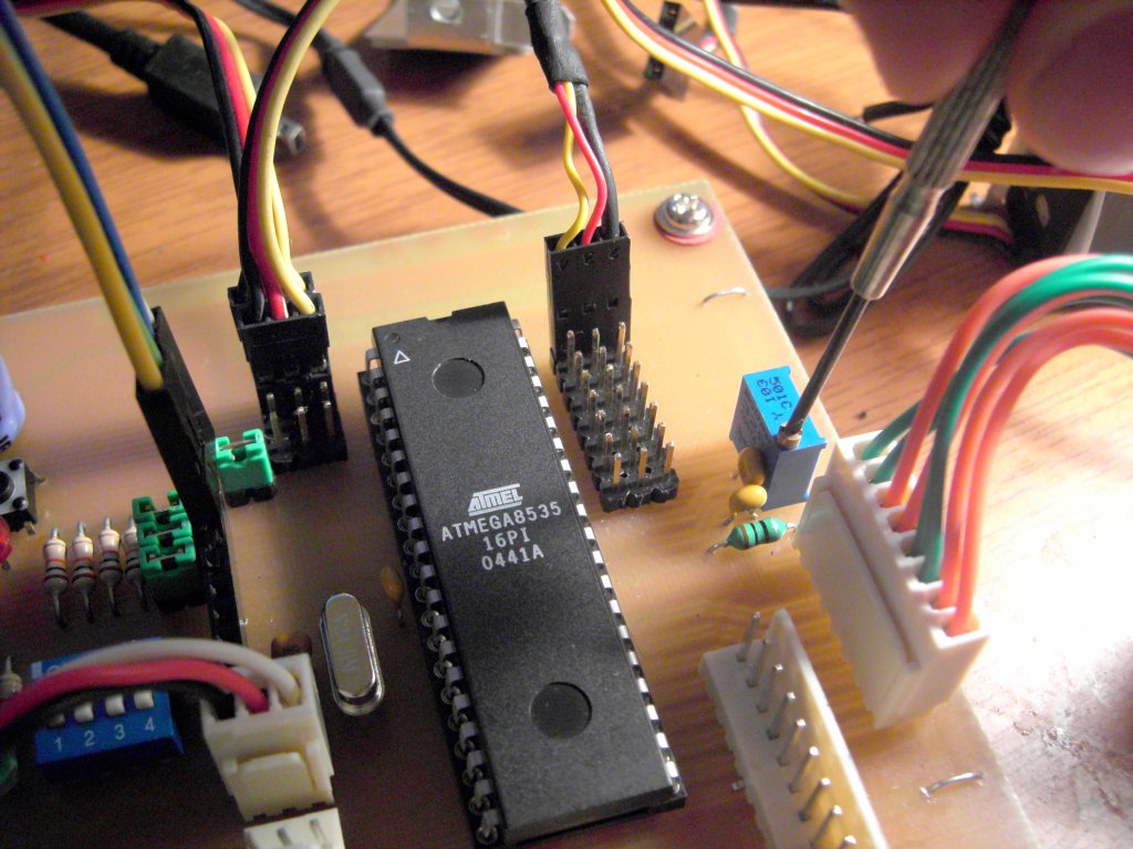

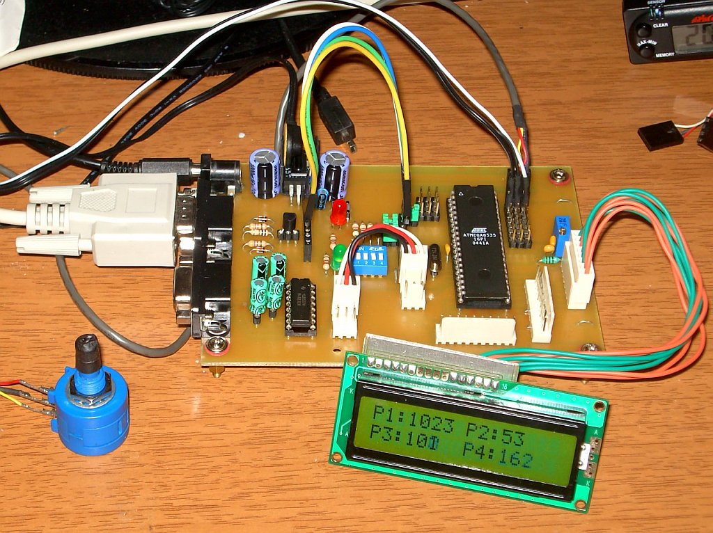

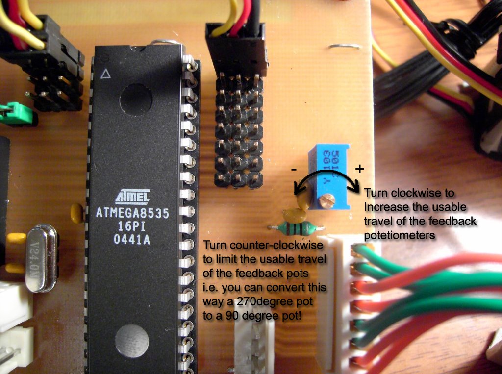

    I want to mention a function about the feedback potetiometers that is very handy in same cases.
    I didn't wanted to show you this function before, since I wanted to verificate its working ok first.
    On the AVR motion controller board there is a 10k multiturn potetiometer that its function is to limit the upper voltage level sended to the ACD comparison circuits of the Atmega8535. This means that you can scale down the usable reading range of the ADC. So you can reach the max (1024 value) by turning less the potentiometer.
    Such scale down can be usefull in multiturn pots that we want to perform less turns than they provide. Thus you can convert a 10turns potetiometer to a 7turn or 5turns or even a 1turn if you like!
    But the most usefull application to me is that you can convert the conventional 270 degree potetiometers to a 90 degree pots!!!!! I use 90 degree pots on my joyrider sim and lots of people asking where I got them. So instead of hacking toy RC receivers they can now use normal 270 degree potetiometers and limit their travel to 90degree by scalling down the ADC trim pot on the avr motion controller!!!
    To be able to calibrate yourself the max travel of your pots I compiled a firmware that displays the ADC values of the 4 feedback pots on the LCD. Except of that you can use this to calibrate them on their actual position on your simulator to ensure that they don't go over the normal values. You should set them in such way that they provide values from 0 to 1023 for the full travel of motion of your sim.
    [​IMG]POT_CALIB_HEX.zip (1.61 KB)

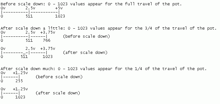

    To visualise how this scale down of the ADC affecting the pots trave see the below graph (sort-of).
    In every case, the scale down will affect the positive leg of the pot, meaning the 0 value will start normally from the physical start of the Ground leg.
    Here is the way to convert a 270degree pot to a 90degree pot by using some math:
    Since the ADC has 10bit resolution it will show 0 - 1023 points for any potentiometer, so in a 270degree pot:
    1023 points / 270 degrees = 3.788 points per degree
    Now if we multiply the step for the degrees we need:
    90 degrees * 3.788 points = 340 points
    So to limit the max travel of a 270degree pot to 90 degrees, we turn the potentiometer until it shows the value 340. Then we turn counter-clockwise the ADC scale down potentiometer (that will slowly rising the value) until it reaches the 1023 value!!! Thats it, you now have a 90 degree potentiometer!!
    One thing you might forget it that my controller doesn't need end stop switches for the motors as it will never reach the end stops!! As long the potetiometers provide correct feedback for the position they will stay within limits no matter position command is received by the computer. If communication with the computer is lost, i.e. the game was crashed, the avr motion controller will maintain the last position commanded.

    The four 3 pin molex headers connect the max232 circuit to the microcontroller.
    For now we need only to connect a cable between the two 3-pin headers named as RX.
    This will enable the receiving of the serial data thru the I/O data input serial port.
    I connected it as seen in the following photo:
    The other two TX headers are there for future use to send back in the computer info about the position of the motors or the rest potetiometer inputs for fine tuning during play.
    For Simforce sims, the max difference between the actuator positions will be adjustable by fine tunning it with a potetiometer from the rest unused pot ports.
