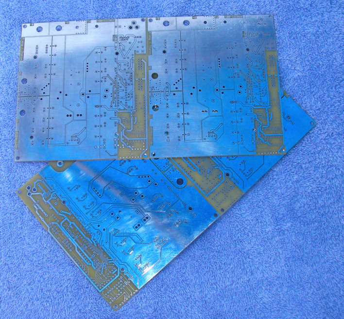

    Okay...the cat is out of the bag, so here is your teaser!
    Presenting the HPMhb-150A...

    Actually the prices are really good for double sided boards... If you live in USA !!! R-eng ordered them for me and achieved better price per board by ordering four of them. 25 euro per double sided board with with all holes plated through isn't bad at all!!!!!
    The ACS75xxxxx is actually the ACS754 pachage CB-PFF.
    R-eng choose ACS754KBC-150-PFF for 150A, and I choose the ACS754LCB-100-PFF as I don't intend to push any of my motors with more than 100A current!! The limits will be calculated as percent of the 0-5v output of the ACS754 so no firmware variations needed for different current sensors of this type.

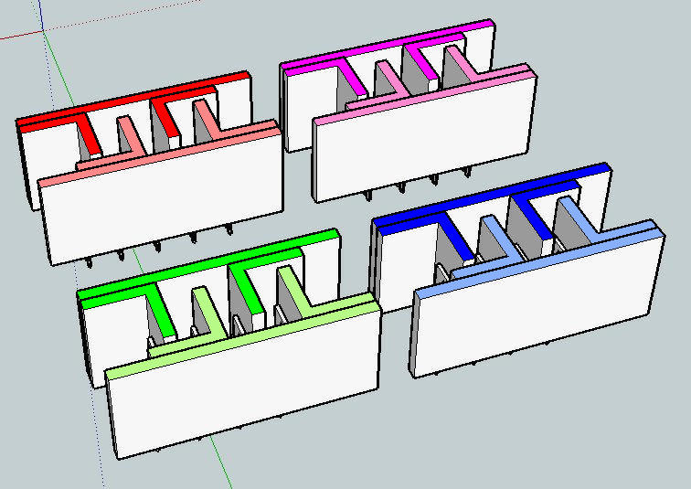

    BTW- This is my design of the heatsink for the 16 MOSFET layout. It will be assembled from aluminum bar and angle of 0.125 in. Well balanced with a heatsink bank for every 2 MOSFET, lots of surface area, and lots of thermal mass. It will be cooled with a 92mm PC fan directly over them. With some clever tabs, one could even mount a 120mm fan.
    All the parts can be sourced from Mouser and DigiKey in the US.

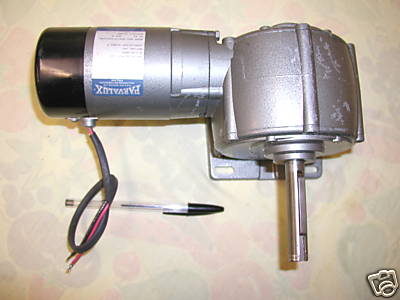

    Hi Thanos Been awhile but have always been checking out developments here, and eargerly awaiting the next gen H Bridge, As you may remember i am still working on my 2DOF motion platform and recently won a bid for 3 Parvalux P3 LWS gearbox/Motor Combination units I Knew when i placed the bid that the Gearbox Output sped was Low at 8 RPM but the Torque was 51Nm so i figured i may be able to Change the Motor at some point and get better speed, My main question is i have the Controller recommeded By Ian at Budggies Built for fun but as money is getting tighter i would like to use Your H bridge PCBinstead of the MDO3 Motor controller Ian used.. I Have enough parts left over to Build another H Bridge and so Have one for Simforce GT Project and A seperate One for the Flight sim, As Ians System uses i2C protocol to drive the MD03 controllers i was wondering how and if i could Connect your H Bridge to do the same thing but without i2C.. is this Possible ?? i ask mainley becuse you did some testing and wondered if you went down the road of using your hardware instead of buying another Controller ..:) :cheers: By the way i am thinking of initally driving the motors at a higher voltage than the factory specs just to see if i can bump up the output speed before i dismantle the units :lol: will post the Pics when i get to the workshop .. (well it's a Shed Really but i have big visons for it :) ) Motor Specs 24VDC MOTOR GEARBOX MADE BY PARVALUX ENGLAND BOURNMOUTH
    TYPE PM 3AWS/601254/3M
    24VDC, 8 AMP, 120 WATT, RPM 2800 motor, RATED INT, INS CLASS F
    GEARBOX Nm 51, RPM 8, RATIO 12/24
    SHAFT DIA 15mm x 75mm LONG

    Hi wannabeflyer.
    You cannot use Ian's Picaxe controller with my DSMhb1.2b. As you said, Picaxe just sends I2C data signals to the MD03 that has no relation to the PWM pulse signals that DSMhb uses. The MD03 have onboard microcontroller that translates the I2C data signals to PWM signals for the h-bridge chip it has. Thats why MD03 is so expensive.
    If you study more the way Picaxe works you will see that it doen't actually do many things apart from converting the serial data to I2C signals for the MD03 and send back to the PC the potentiometer position feedback data. All calculation are implemented in software!!!!
    I'm not saying that Ian's way isn't good, in fact he made some cool addon's lately, but his electronics works only in conjunction with his BFF driver.
    On the other side, I try to implement everything on hardware side keeping as simple is possible the serial comm part for speed and compatibility reasons.
    BTW good luck with those motors. You need much more RPM output for a motion simulator. 40 - 60 PRM atleast.

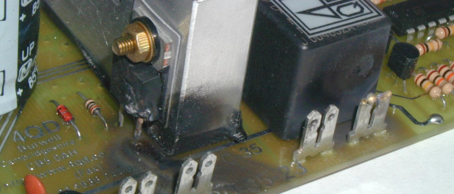

    Hi Senetor,
    And Hi too to all those who have, or are intending to, build the Simple Mosfet Tester. Please read this!
    There is an error in the Circuit Diagram, hence all the weird results I was getting. The explanation part of the PDF page states that IC1, the first 555, is a 2 HZ astable oscillator, while the second is just an inverter---in short, when the output of IC1 switches LED1 on, LED2 will be off, and viceversa. In my case, with the circuit wired exactly as in 'Simple Mosfet Tester.pdf'', there was no alternate flicker of the LEDs at all. Either they were both on at the same time, off or some erratic in-between state. What I finally did, after a lot of checking and substituting (mucking about!!), was simple. Just reverse the polarities of LED2 and D2, leaving the polarities of LED1 and D1 as shown in the Diagram--that's it!!
    While strictly not necessary, there are a couple of other things you can do. The green ON indicator light was far too bright. Increase it's 330 ohm resistor to 1 Kohm. LED1 and 2 are quite dim. Their 330 ohm resistors were reduced to 220 ohms.
    The 4 tests applied by the Tester to 8xIRFZ44N's and 7xIRF4905, reveal that one each of IRFZ44N and IRF4905 is bad (Gate to Source short), and the 13 others are OK!! (One got lost!!). At least I can now put these onto the board with some measure of confidence! One gets pretty wasteful without a Tester!! The corrected Circuit Diagram is attached here.

    Glad to see you got it working, the Mosfet Tester was posted in Circuit Notebook by a reader, not Silicon Chip itself.
    Did you open any of the dead Mosfets yet, to see if they are the real deal and not counterfeits.
    Also did you read the article on Mosfet Failure Mechanisms as it explains how brush and commutator noise can kill Mosfets.
    It also talks of blocked motors and how disconecting a motor lead will blow mosfets, so do not put a fuse on the motor leads, just the H-Bridge power lead.
