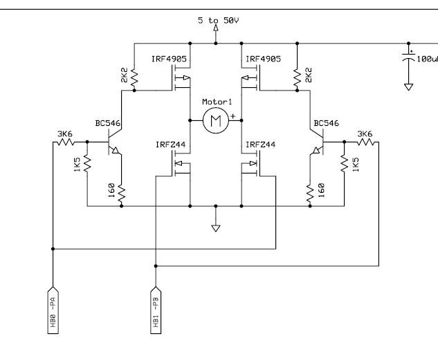

    Tronic, I have just noticed, that when you upgraded the v1.0 H-Bridge to v1.2b, you have reversed the Drain and Source connections of the IRF4905 mosfet and now the drains of the IRF4905 and IRFZ44 are connected together. In the H-Bridge Schematic it shows the Drain of the IRF4905 connected to the Power supply.

    When using two different power sources, a car battery for the H-Bridge and a transformer or a plugpack for the AMC1.5, how does the Gnd from the 74HC08 connect to the Gnd of the H-Bridge to complete the circuit of the 74HC08.

    I think I have found the reason why so many people are having so many problems with the N-Channel Mosfets.
    On the schematic and parts list you have the N-Channel Mosfets listed as IRFZ44, they should be listed as IRLZ44N which are logic level Mosfets, which will turn on fully from the 5v signal from the 74HC08.
    The IRFZ44 Mosfets require 10v to turn on fully, and require a dedicated driver to turn on, and because they cannot turn on fully with the 5v from the 74HC08 get too hot and go up in Smoke. Therefore Logic Level Mosfets must be used to be able to fully turn on.
    R-eng used STMSTP80NF55-06 Mosfets and raised the voltage to the 74HC08 to 6v to try to compensate.
    I am using the STP80PF55 for the P-Channel and STP80NF55L-06 for the N-Channel which are logic level Mosfets.

    I found a schematic from an app note from Unitrode Texas Instruments, U-102. If you want to experiment and try to low the heat in the IRFZ44N try to modify it with this circuit, adding NPN transistor Q3 and Q4 to the N-Channel Mosfets, instead of driving them direct from AND gates (74HC08).

    Hi everyone and especially Tronic.
    I'd done the H-bridge and the AMC to adapt to my cockpit.
    But since the AMC works correctly, I'v got one issue with the h-bridge.
    I works correctly with smalls dc motors, but when i attach the wipper motor to test, two mosfets are broken.
    The power supply are 33A and it's start the wipper motor without problems when i attach the wiper motor directly to the power supply.
    Can you help me?
    Any ideas to look at?

    What power supply do you use? Is it a switching power supply? Did you tried with a common car battery?
    Are you mosfets labeled IRFZ44N ???

    Yes, it's are switching power supply, i don´t try with battery car, but the power supply can start the motors instatly when directly connect to it.
    Yes, IRZ44 are the ones I use.
    A lot of overheating are generated and the motors turns his rotation so slowly.

    Can you post a photo of the mosfets label? Its important!
    There is difference between IRFZ44 and IRFZ44N !!!! You need the IRFZ44N ones!!!!!!
    The ones without N are not able to fully turn on by the 5v logical system of the h-bridge!
