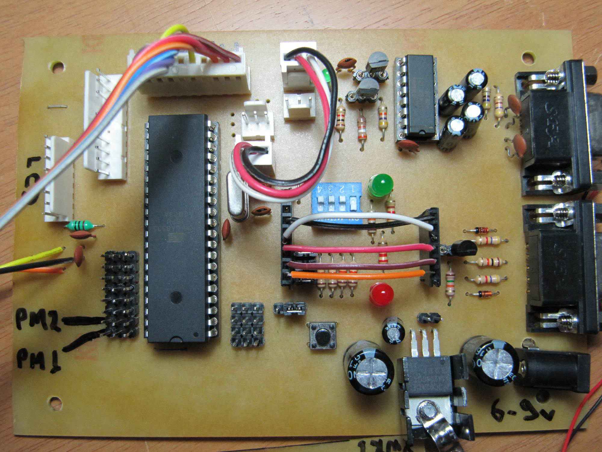

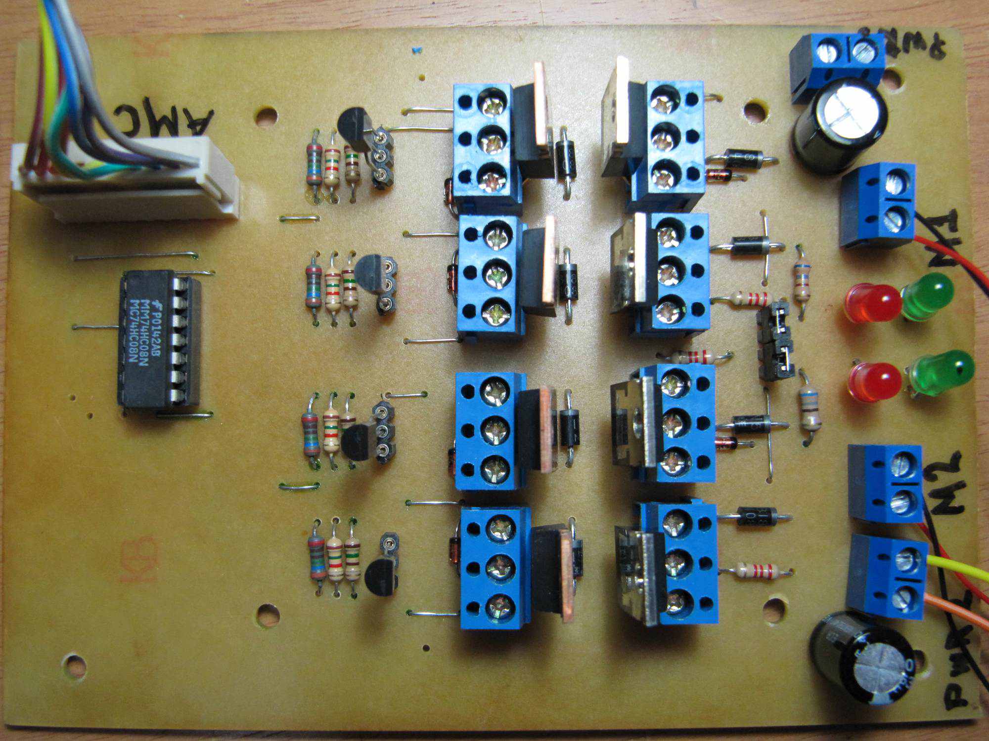

    Hi, today I finally assembled everything together (cockpit+boards+software) but my 74HC08 chip is gone again. (to buy it again I have to travel 70Km so better buy 10 of it!!!)
    It is the third time this happens so I am wondering from where come the problem.
    If anyone can help telling me if the most probable source of the this problem is AMC/ATmega sending bad quality signals or the HB itself would help alot!
    My best bet is that I have bad quality resistors on both boards. Here some pics:
    Tip: When I measure the signals from the cable that come from AMC all seems to be fine. (M1 IN1, M1 IN2, Vcc, Gnd, etc.)
    Note that I know that it is impossible for you to tell me for sure if you are not here :D so that is why I ask for the MOST PROBABLE SOURCE of the problem :cheers:

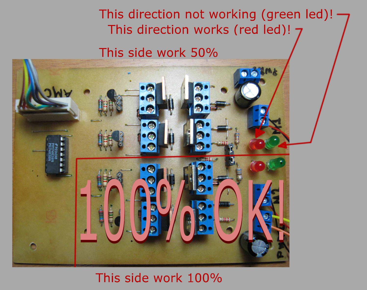

    Hi again! :rofl: (laugh for not to cry)
    I apologize and say that the 74HC08N was not the problem. It seemed the problem because of a damaged mosfet that was interfering on my readings. I did not realize that it could do this backwards to the chip!
    After troubleshoot every area of my HB I have to say that M2 (motor2) is working 100% fine.
    But, M1 is working only in one direction.
    The weird is that everything was working fine before.
    Here one picture that speaks for itself:
    Any idea of what components do the job for the direction I talk about?
    Tip: After I replace the damaged mosfet, the 74HC08N sends the voltages very fine for both directions and both motors!
    regards!

    it could be anything.. :yes:
