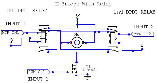

    Hi All, Noob here, first of all I apologize for my grammar and I want to congratulate of Mr Tanos's new place.
    I want to go back to see the basic of making simulator with the least possible cost and maintenance as low as possible. Based on the dual mosfet h bridge's schematic and the output of AMC board, this equipment has 2 inputs to run and reverse the motor direction and 1 input to supply the PWM.
    ( I apologize IF this idea has been in discussed ... please show me the thread ) I think to use 2 DPDT relay to replace the MOSFET and remains 1 FET as a PWM voltage supply.
    there may be from the experts who've tried it, I am waiting for your suggestions.
    Regards, :cheers:
