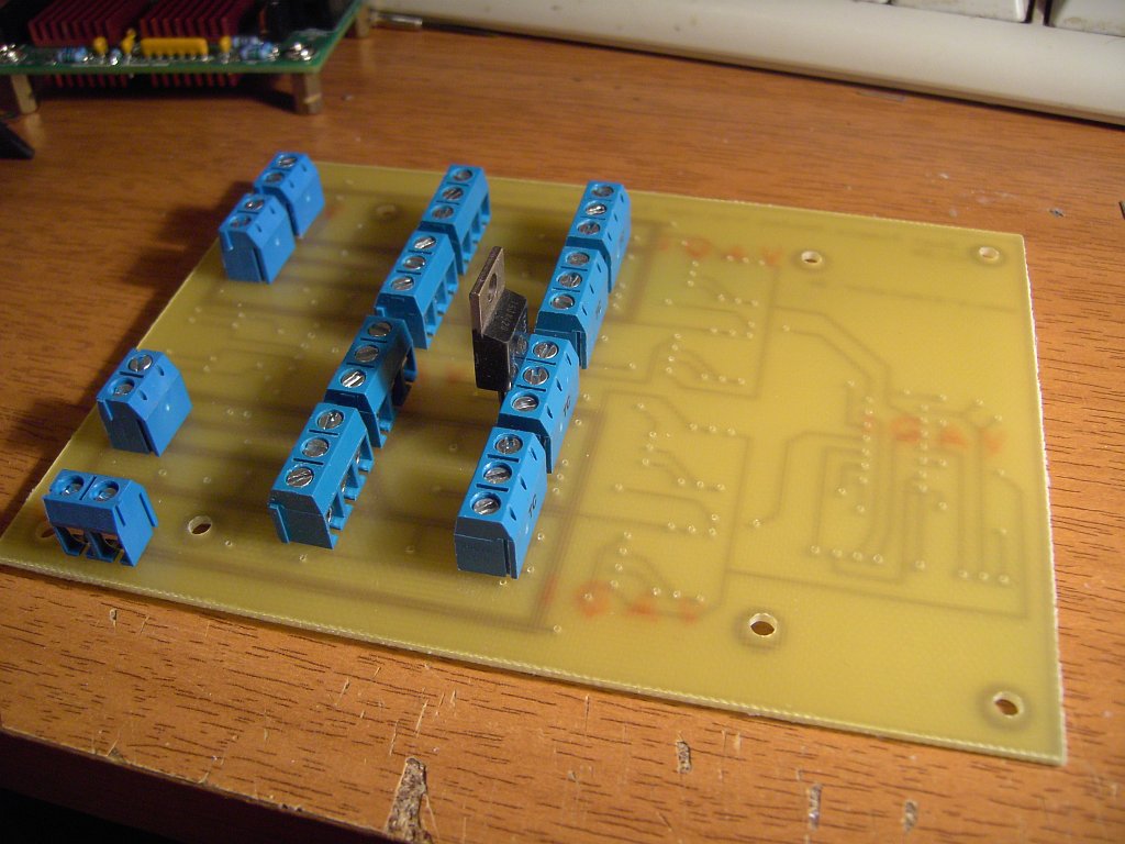

  7. tronicgr
    tronicgr
    Re: Tronic's DIY dual Mosfet H-bridge

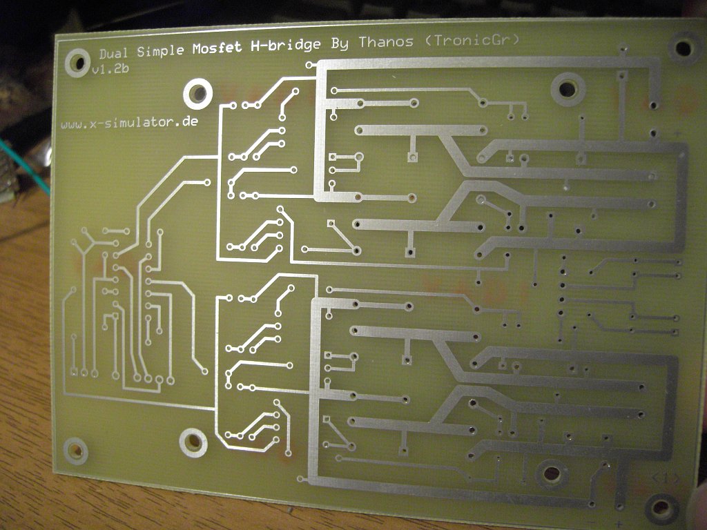

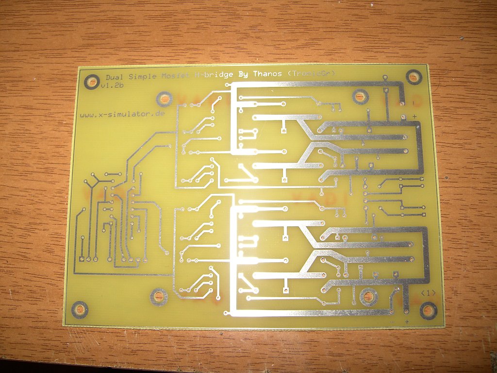

    Yesterday I received the PCB for the dual mosfet h-bridge. Here are some pics of it! :D
    I had to drill little bigger the holes for the terminal connectors but otherwise it looks good! I hope I will solder it and test it soon.
    Regards, Thanos

    looks good ... it is a touch of irony with the RN2 in the background, `cause with the Tronics DIY dual Mosfet H-bridge (TDdmH) it will be obsolete ;-)
    B.T.W all pics in your interface thread are updated!

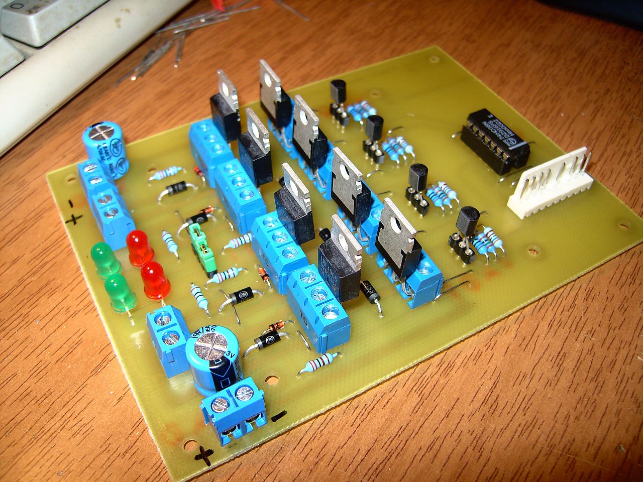

    I completed the first Dual Simple Mosfet H-bridge. I soldered the PCB and it passed the first tests succesfully.
    For the first tests I used 6volt power supply and the 5volt test table motors. It produced proper motion using PWM on 24Khz same as RN-VN2 did. Slow and fast movements were executed as expected.
    I didn't used any kind of cooling on the mosftets but no heating was developed on them during the tests. The motors was free run with no load but I think that even with load will handle amp rates of 5amp with no cooler plated attached on the mosfets. The fan should be mounted on it just in case...
    I didn't dare to put it on the 12volt power and connect it with the wiper motors before attaching the cooler plates on the mosfets. Cutting these aluminium plates is somehow difficult in such small dimensions but it will be done.

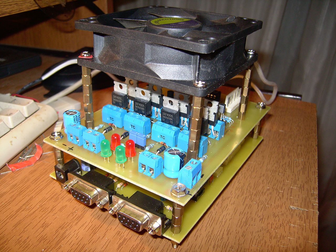

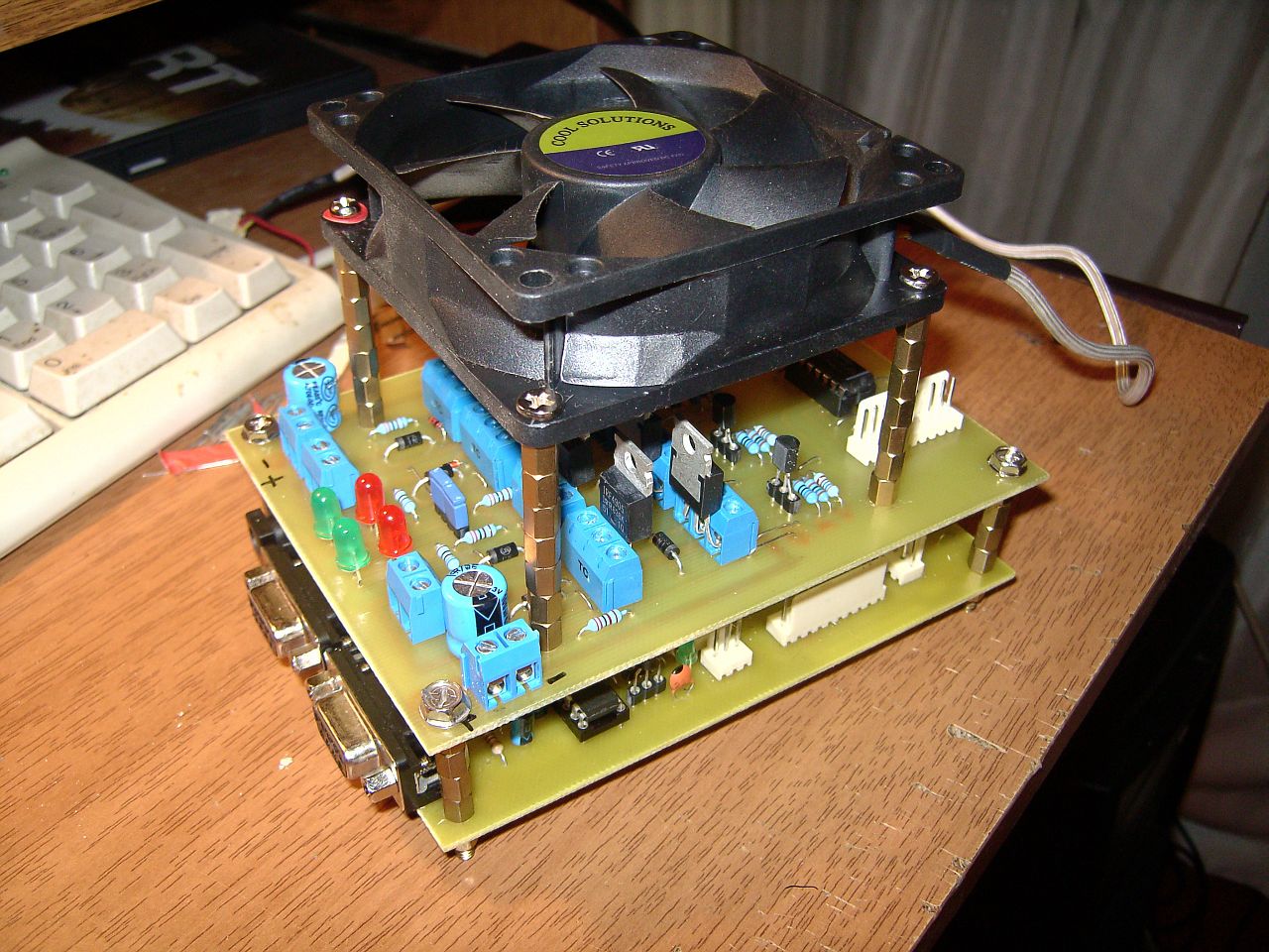

    Here is how you can mount it on the AVR motion controller and place a PC case fan on top of it:
    I reinforced the thick power traces with lots of solder melted in them. I used one meter of solder on them to make them as thick is possible!! Now they can handle Amp rates of more than 30Amp!!!
    During the tests I seen that the status leds were light only one at the time with no motor connected! But with motor connected both status leds were off, when brake was applied and both of them was turned ON during the start of acceleration of the motor. The led that was indicating the opposite direction of the motor was starting to fade only when a certain speed was developed. This lead me to conclude that the motor was backfiring (regeneration) the excess power to the h-bridge in low speeds or during acceleration, and luckily, was directed back to the battery thru the Schottky barrier rectifiers! That's why no overheating was seen on the mosftets!! Wow! Can't wait to see how it reacts on the wiper motors!
    I took a video to see the reaction of the status leds during driving the small test table motor on 6volts power.

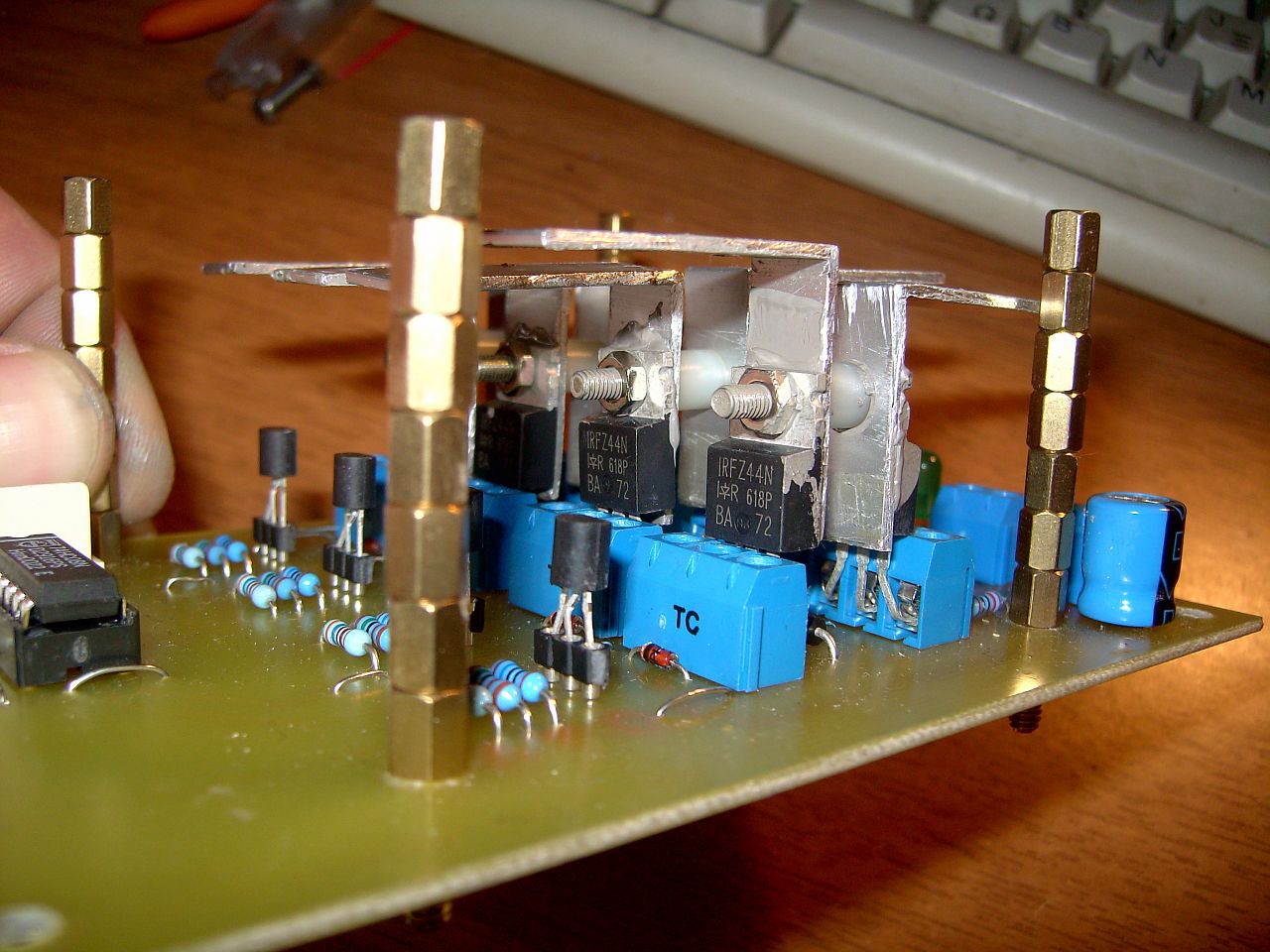

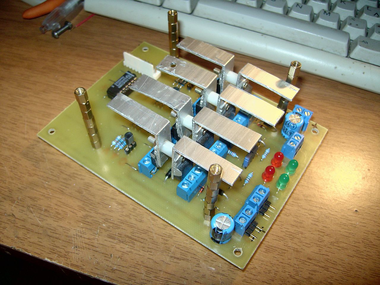

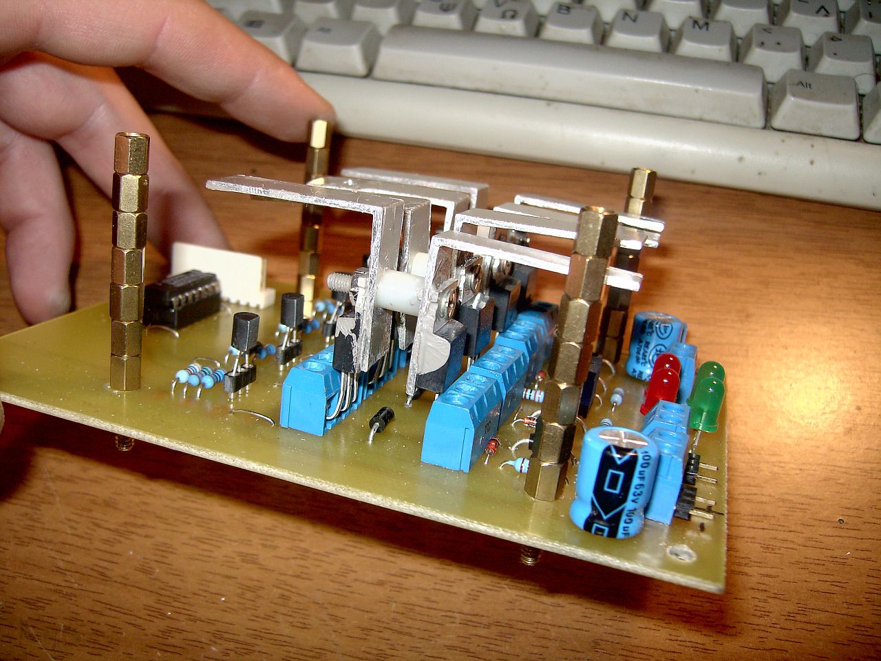

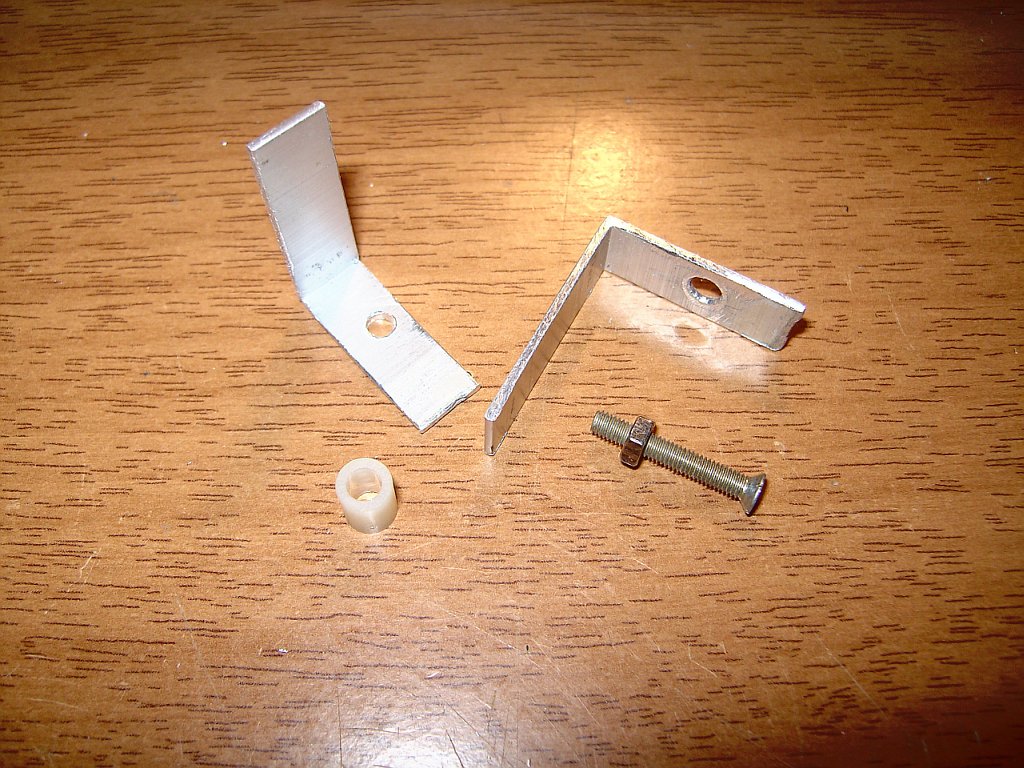

  20. tronicgr
    tronicgr

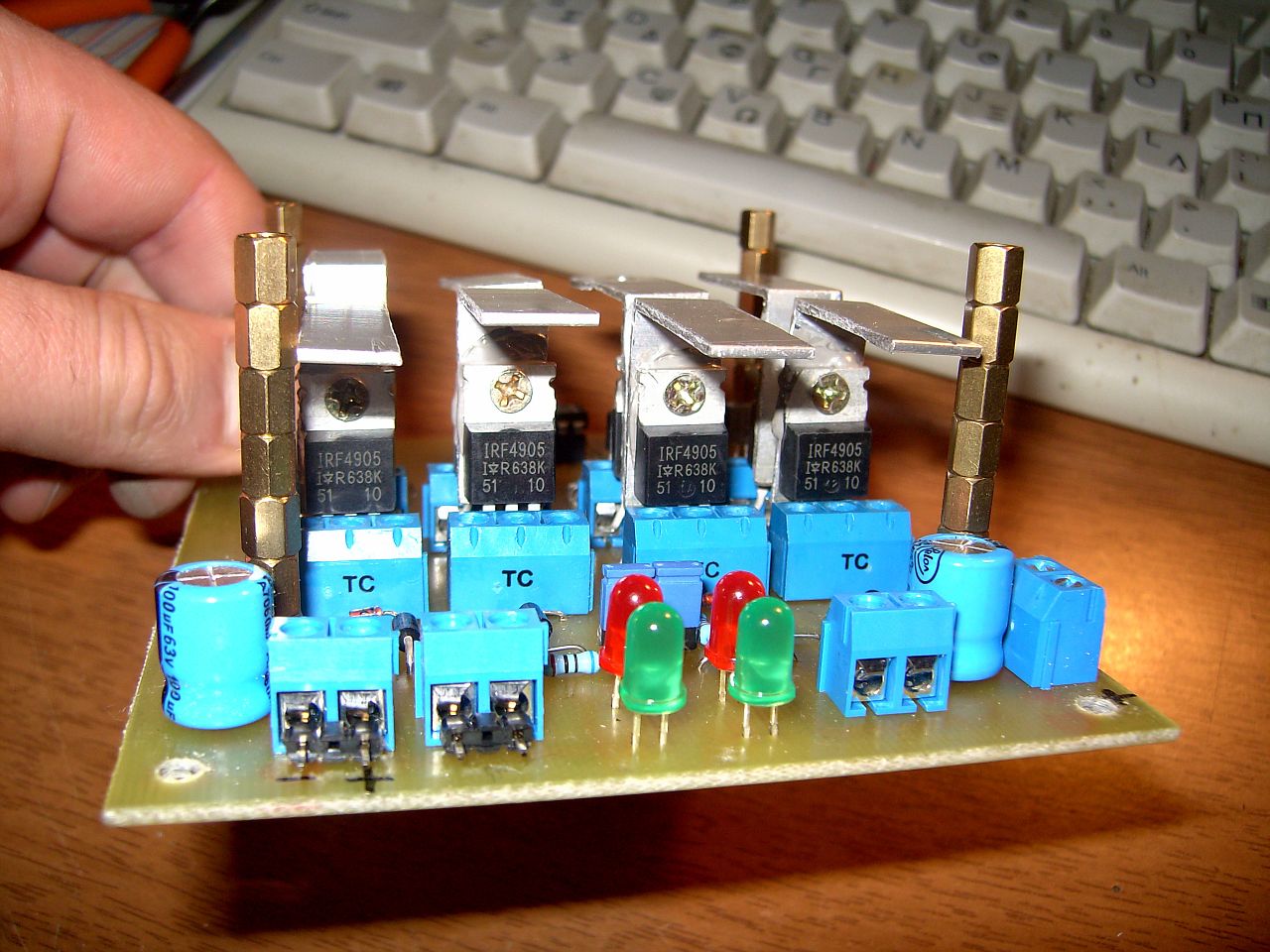

    Yesterday, I have cutted eight small aluminum stripes to use as heatsink on the mosfets. They are small cause I could not find larger pieces around the house but I think they are enough.
    As you can see in the photos, I used just one bolt with a plastic distance holder, that holds the pieces pretty strong against the mosfets. Between the mosfets and the heatsink pieces I used polysynthetic silver thermal compound (particularly the Arctic Silver5) that is usually used in computer CPU coolers!
    Haven't fire it up yet, with wiper motors, but it will be done the next days I suppose.
