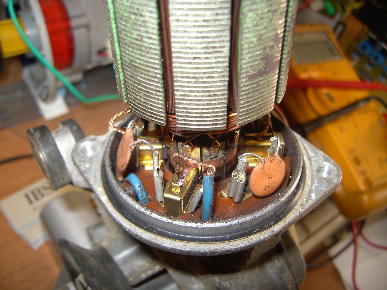

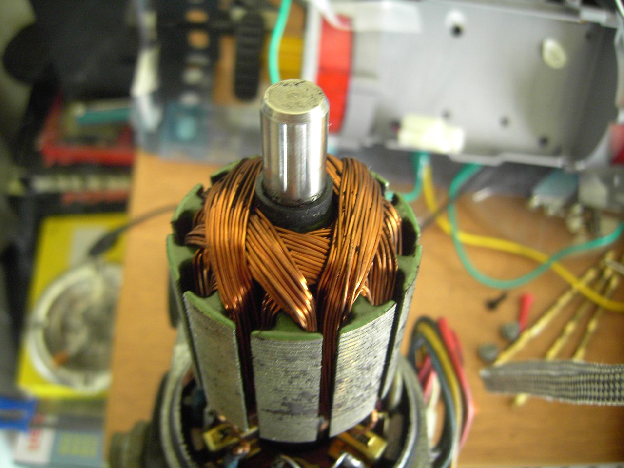

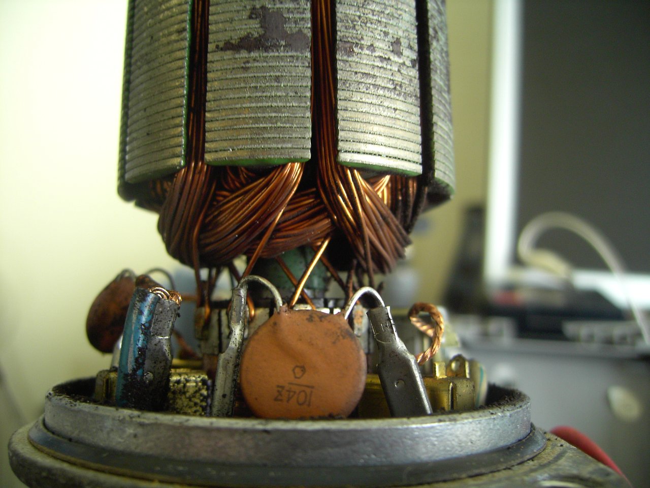

    I did some very interesting comparison tests between the DSMhb (dual simple mosfet h-bridge) and the RNVN2...
    I connected the same wiper motor and 12volt (battery source) to see the difference between them... I found that the 24Khz PWM frequency was affecting the RNVN2 and not the motors!!!
    While RNVN2 produces noise and bad motion during acceleration, the DSMhb was going wonderful! No noise at all and it was keeping the torque on the motor even with slower speeds fine!
    I took a comparison video to see how each one behave:
    http://www.youtube.com/watch?v=xe2v6zZ7P28
    So, I think I made an even better motor controller than a commercial one!! Cool! And it was not even get warm with wiper motors! I think it will work nicely even with larger voltage motors (24volt or 48volt!!!)
    I will lower the PWM frequency of my AVR motion controller down to 18Khz and try again with the RNVN2 later. I altready have two RNVN2 motors controllers, and probably, many of you have also a RNVN2 or other motor controllers with simular PWM freq limitations and I don't want these to go wasted... At least now I know the source of the problem...!
    Another thing I wanted to mention is that looking closer the windings of a wiper motor I saw that its designed to allow more current to one direction than the other. I figured this out also by watching how the contacts of each winding are placed. So as I see it, maybe there is no cure to make the motors turn both directions with same speed unless you rewind it properly.

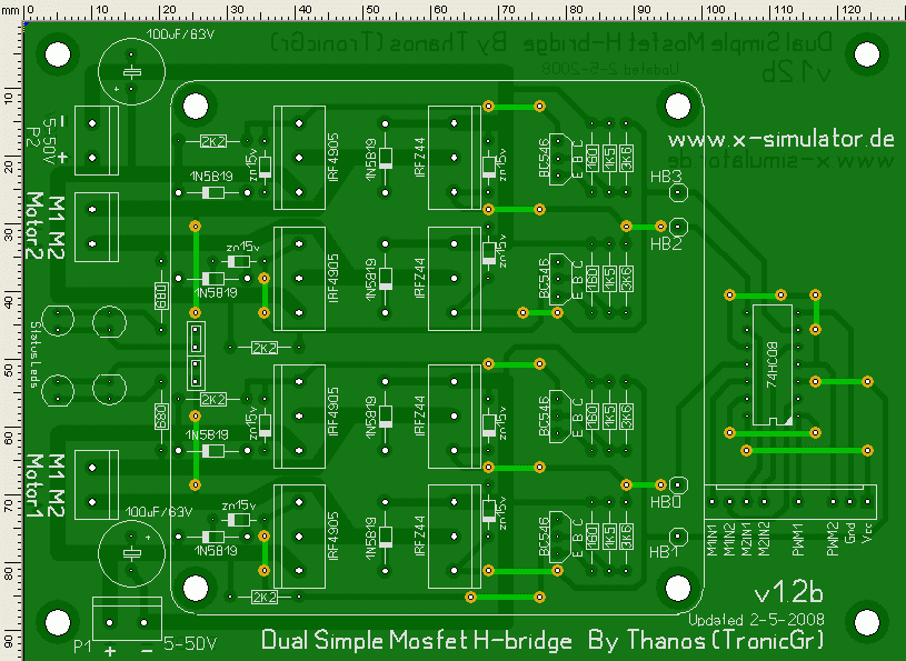

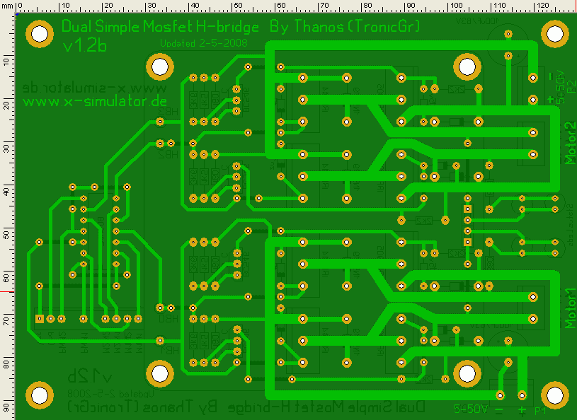

    Here are the updated single PDF PCB layouts for the DSMhb both versions (with or without TC connectors):
    NO TC version v1.2:
    Dual_simple_mosfet_hbridge_1_2.pdf
    dual_simple_mosfet_hbridge_1_2_bottom_single.pdf
    TC Ternimal connectors version v1.2b:
    Dual_simple_mosfet_hbridge_1_2b.pdf
    dual_simple_mosfet_hbridge_1_2b_bottom_single.pdf
    Also included Top and Silk layer for reference reasons only. Use only the PDF that is marked as bottom to send to the etching service.

    Here is the new DSMhb 1.2b layout made with Sprint-layout5. It includes Gerber and Excellon files!
    DSMhb1_2b_sprint.pdf
    And bottom side only:
    DSMhb1_2b_sprint_bottom.pdf
    Here are the gerber and excellon data:
    DSMhb1_2b_gerber_excellon.zip
    And here are some photos of the PCB using the photo function of sprint-layout5:
    Its recommended to use 70um copper-thickness of the lines to be able to achieve 10Amp rate without reinforcing the lines. And if you reinforce the lines with more solder placed on them, you may get up to 25 or 30Amp rate!!!
    Enjoy,
    Regards, Thanos
