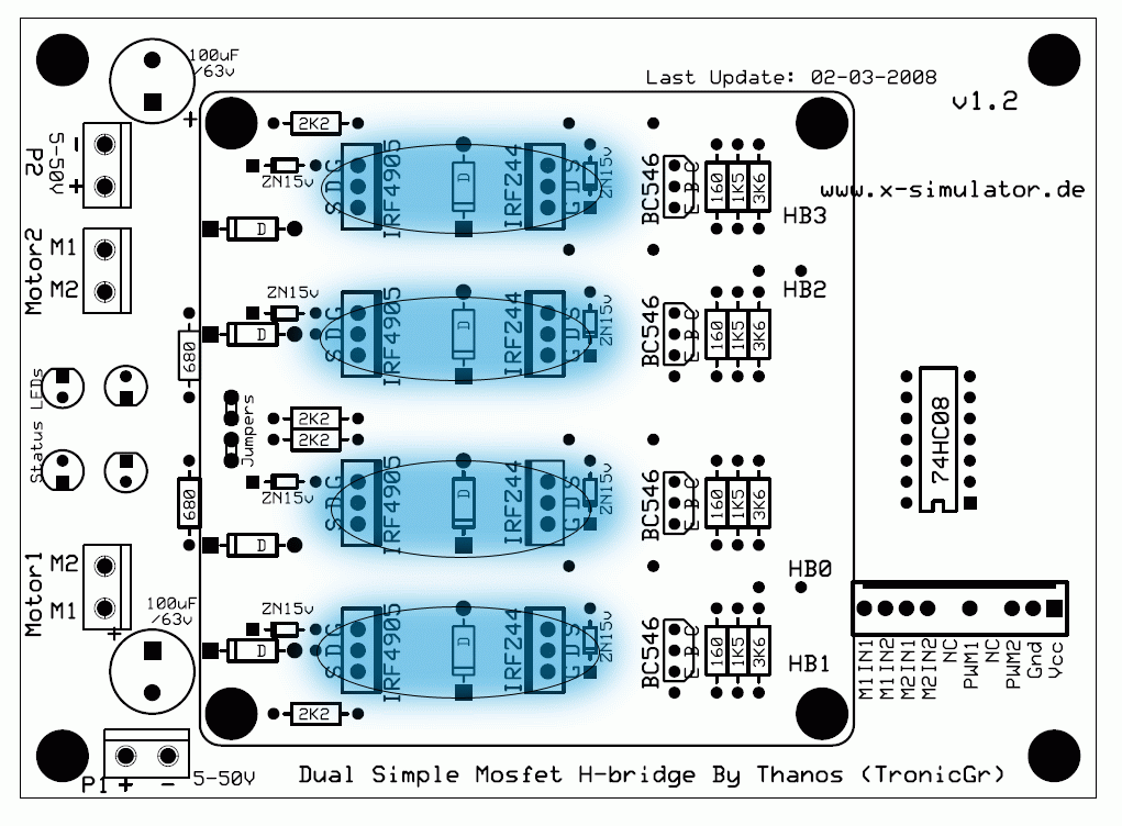

    You can place a cooling plate but it should placed only on opposite placed pairs (one IRFZ44 and one IRF4905). I show in the next photo the pairs that you can connect together (circled and colored blue).

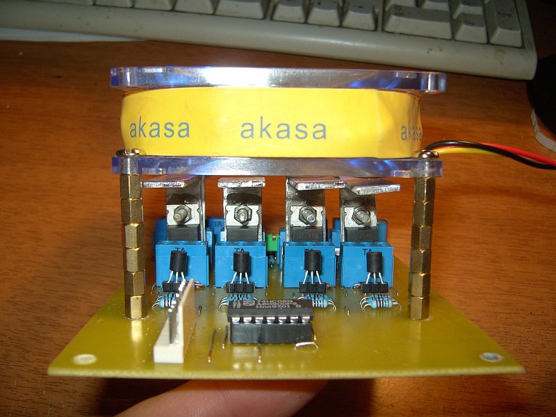

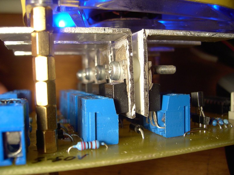

    On the following photos I show how I connected the aluminum plates, bolted in pairs:
    This is the ONLY way that you can connect the cooling plates!!! Any other way will result in short circuit, explosion, or even fire.
