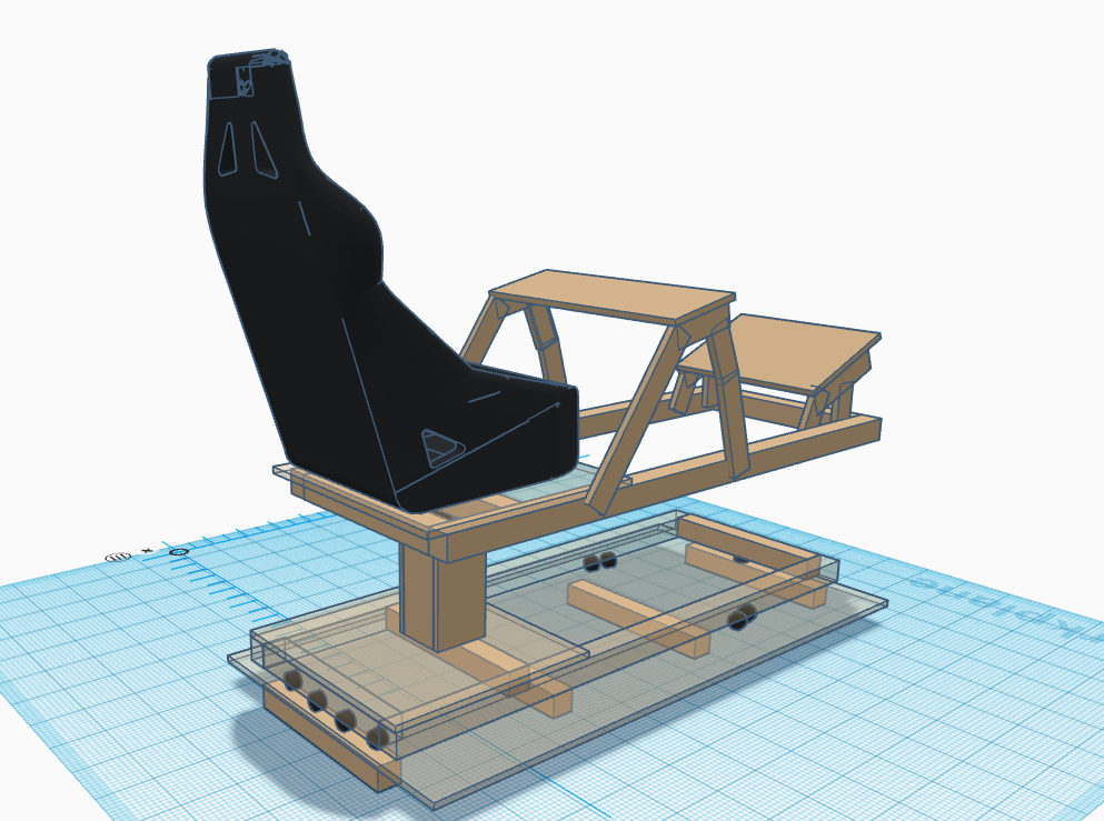

    I was thinking about something like (this design is very similar to the design by mikeyearly on youtube):
    But since I don't have any VR equipment, it might just be too tall, I might have to reduce its height and length (I don't have large monitors or TVs available).
    But one thing at a time, first the motors, then the wood work :)

    I will still try to use the AS5600, the reference that I got for the hall pots was 35 € each (at amazon) do you have a cheaper reference in ali express or some other site? (if you find something cheap that works, please let me know :).
    I will have to go a different path from yours, my motors don't have a "rear" shaft, just a front one, so, my design will have to be different, already saw a lot of users using a set of wheels with a belt and then placing the hall sensor beside the shaft.
    I may have to change the initial design inspired by the great design by mikeyearly. He uses VR so, he is able to lower the top part where the wheel is placed and his sitting position (making it look like a F1 seating position), because he doesn't need to have clear path to the monitors. I already lower my wheel support but to make the build compatible with most of the monitor stands or tables I must lower the top part a bit more.
    That's still a few weeks away :)
