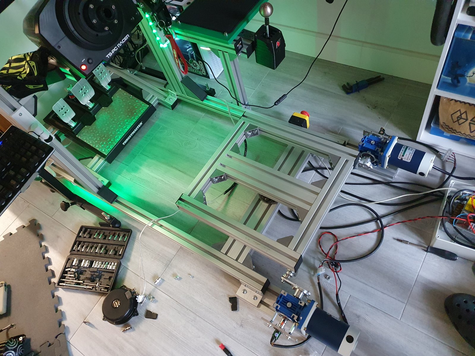

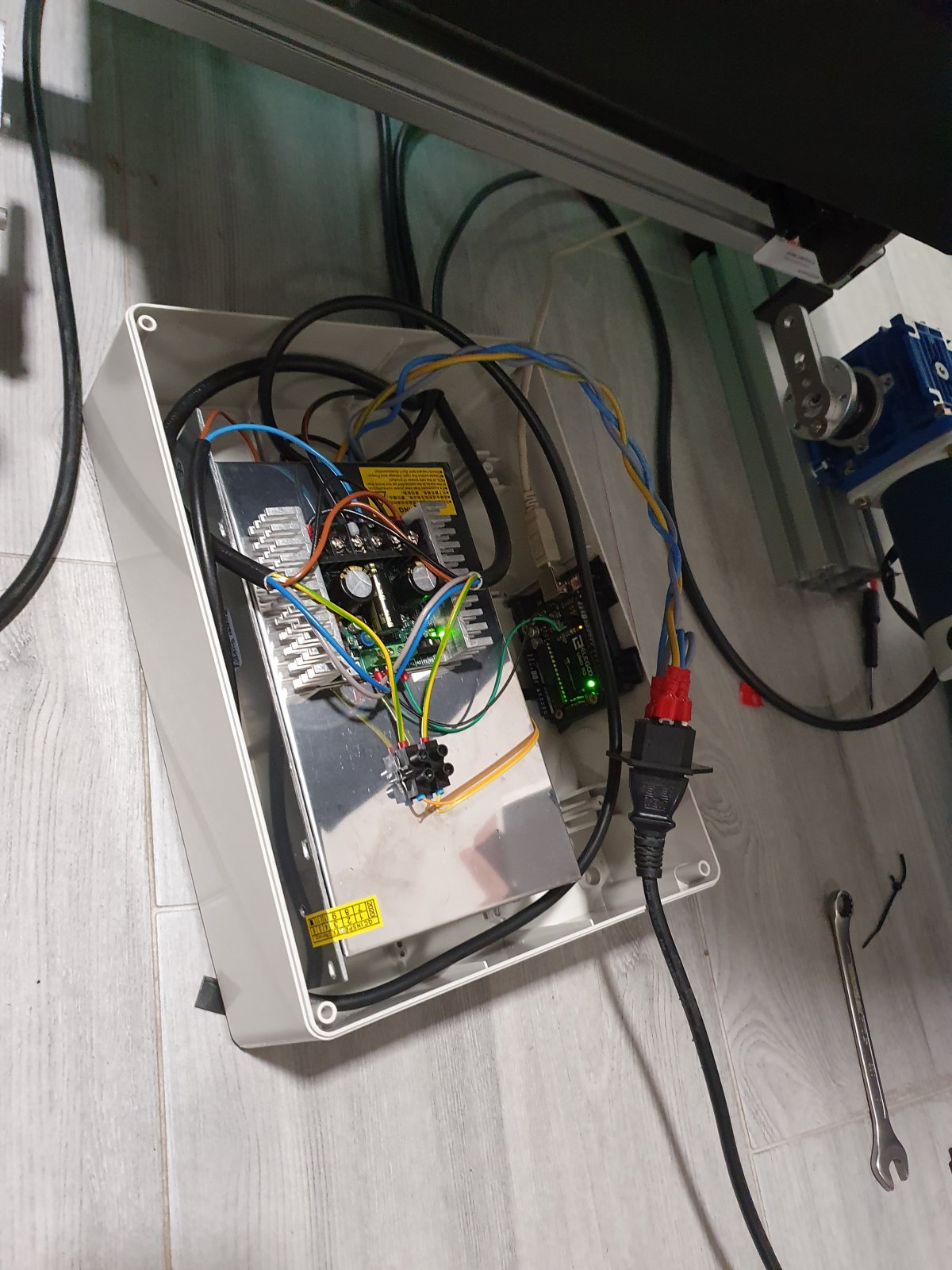

    I mount all and it works but the pots now has a bit of noise i try with 20khz 25khz 30khz and 35khz with similar results.
    Pid also modify with same results.
    Maybe the noise is generated by the wires? I use 5 wires together 2 for the motors and 3 for the pots.
  2. Turbaso
    Turbaso New Member
    Sep 21, 2021
    26
    Mechanic
    San sebastian
    113Coins
    The platform is working!!

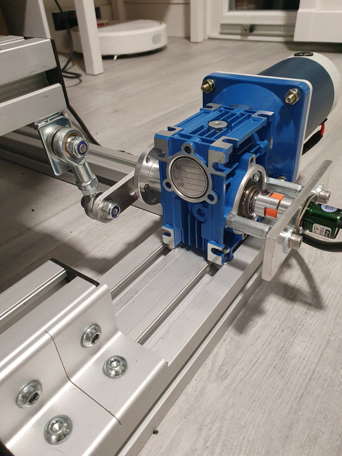

    Maybe those wormgear has a more than expexted slack.
    And if i could chose again i will get 1/30 ratio for the wormgear to be more powerfull

    Rhe only noise it has is about the slack of the wormgear... they are bad quality but this weekend i will change them.
