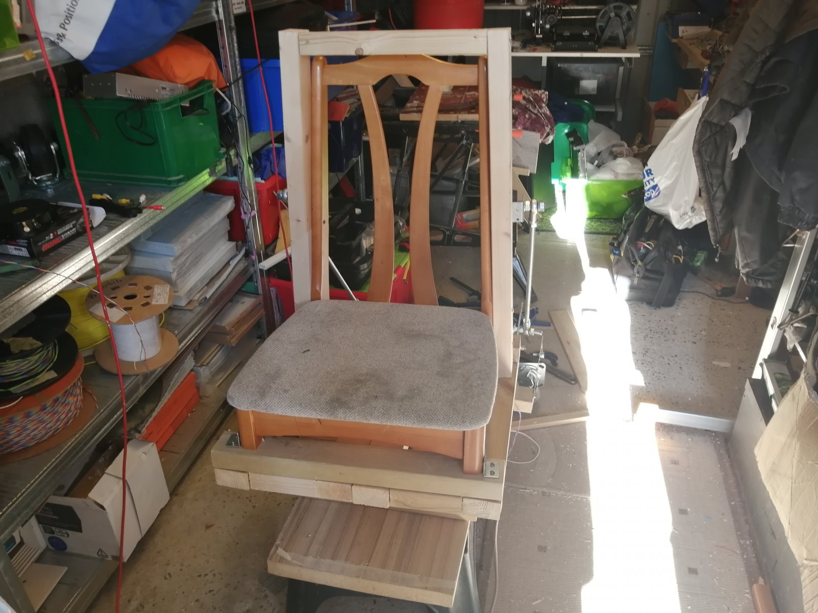

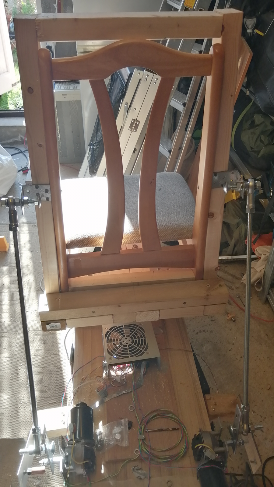

    Just finished completing the wooden chair platform. This platform has space underneath the chair to fit the bass shaker. This fixed all the problems I was having with pitch not working. (No conductors between the motors) It is working great. Some pictures: [​IMG]
    I've also added new potentiometers and wheels for transportation . I have got IBT_2 motor drivers but will replace later along with the new 12v PSU.
