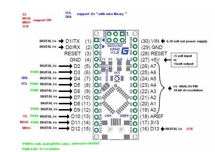

  6. Roadster2
    Roadster2 Member
    Apr 20, 2007
    170
    UK
    1,197Coins
    +42 / 2 / -0
    Hi Martin. In your wiring diagram that you kindly attached, can you confirm the signal names for the pin 8 and 9 connections - based on the attached pinout diagram - D8 and D9 ?
    (just want to make sure I don't screw anything up).

  8. eaorobbie
    20,506Coins
    +1,687 / 23 / -2
    You can easily change the pin names in the code to where you have the signal wire hooked in, its all changeable.

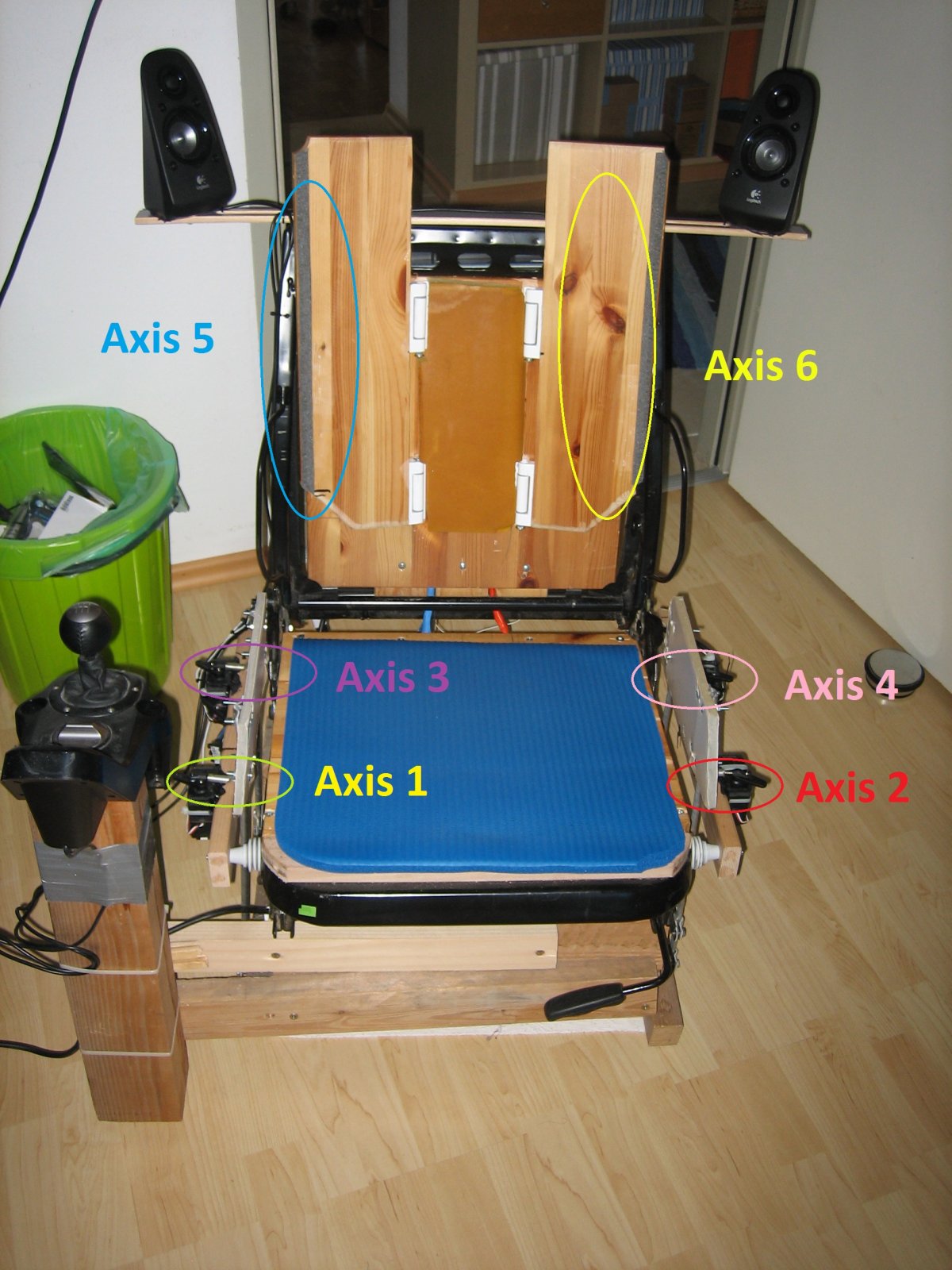

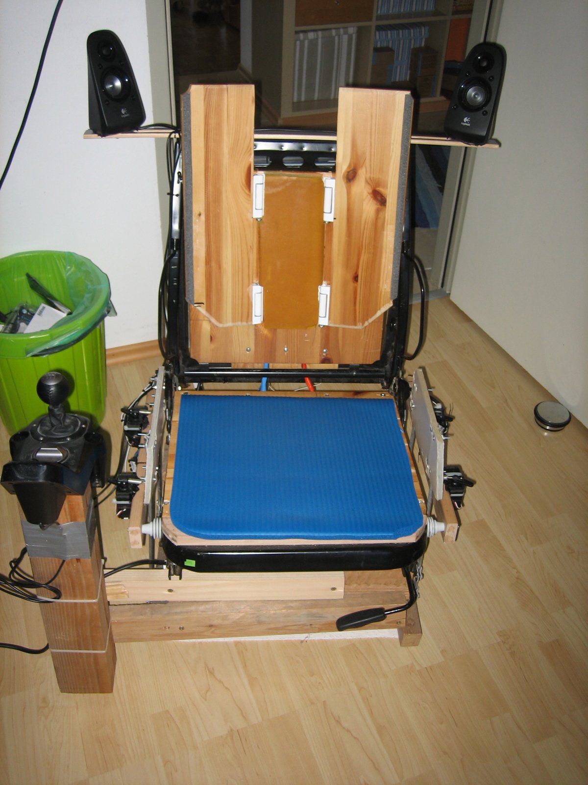

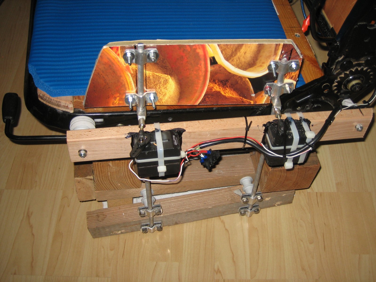

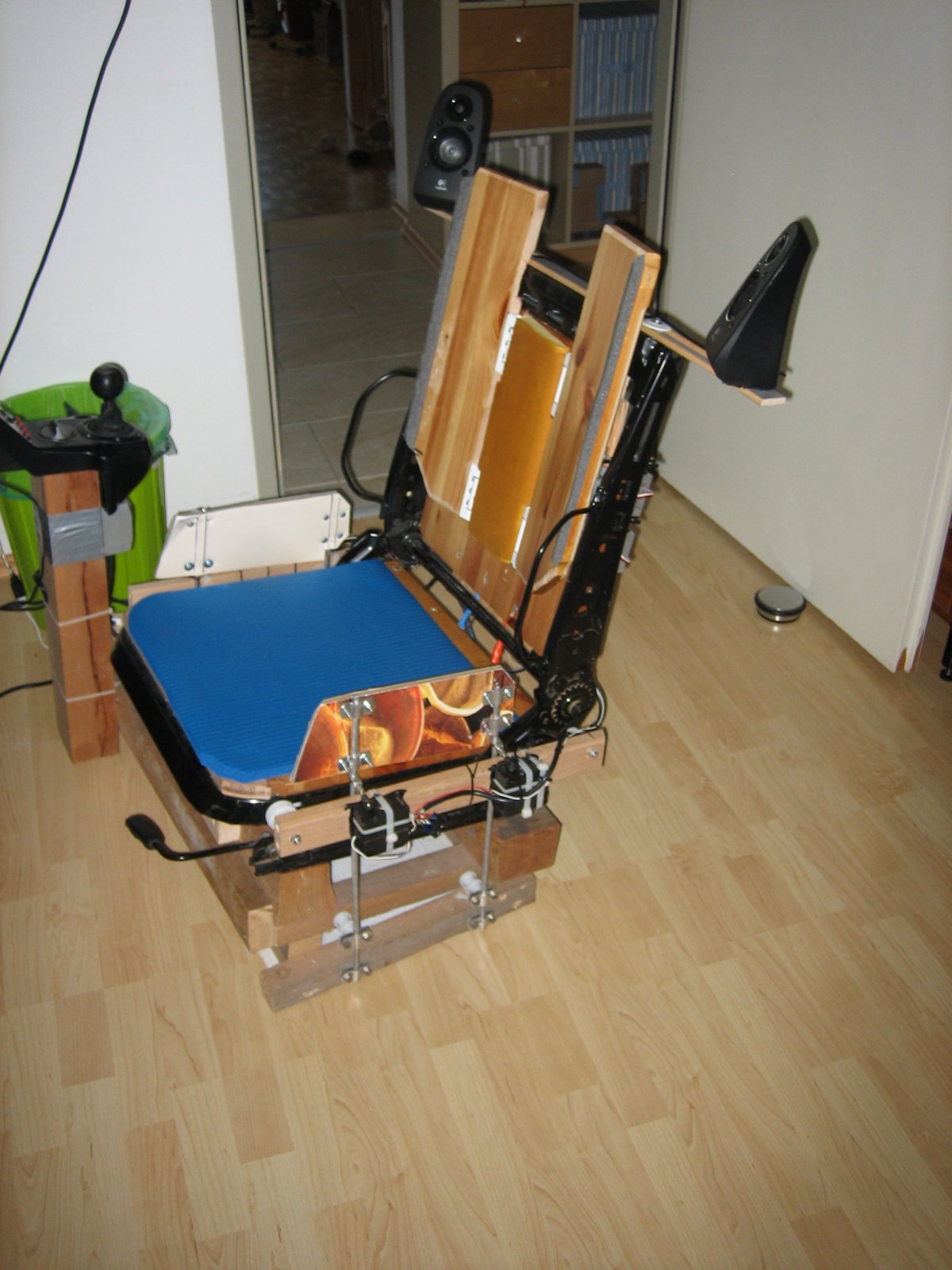

    Hello fellas!
    I'm back with changes on the seat.
    The bottom-plates are history - long sessions on the butt hurts more and more - I moved them to the sides to get pressure on my upper legs and save 2 servos as well. The back-plates are also updated. I get much more feeling in the longitudinal and transverse directions , therefor i loose the heave axis, but thats no problem for me. photos will follow tonight - currently i´m seating in the office.

  16. RiftFlyer
    RiftFlyer Active Member Gold Contributor
    Apr 15, 2014

  18. Schluzu
    Schluzu New Member
    Mar 5, 2014
    27
    37Coins
    +23 / 0 / -0
    Arduino, 6DOF
    Hi guys
    so as promised, the photos and a short video
    NOTE this is a Beta-Version, if i satisfied with it i will posh th seat up.
