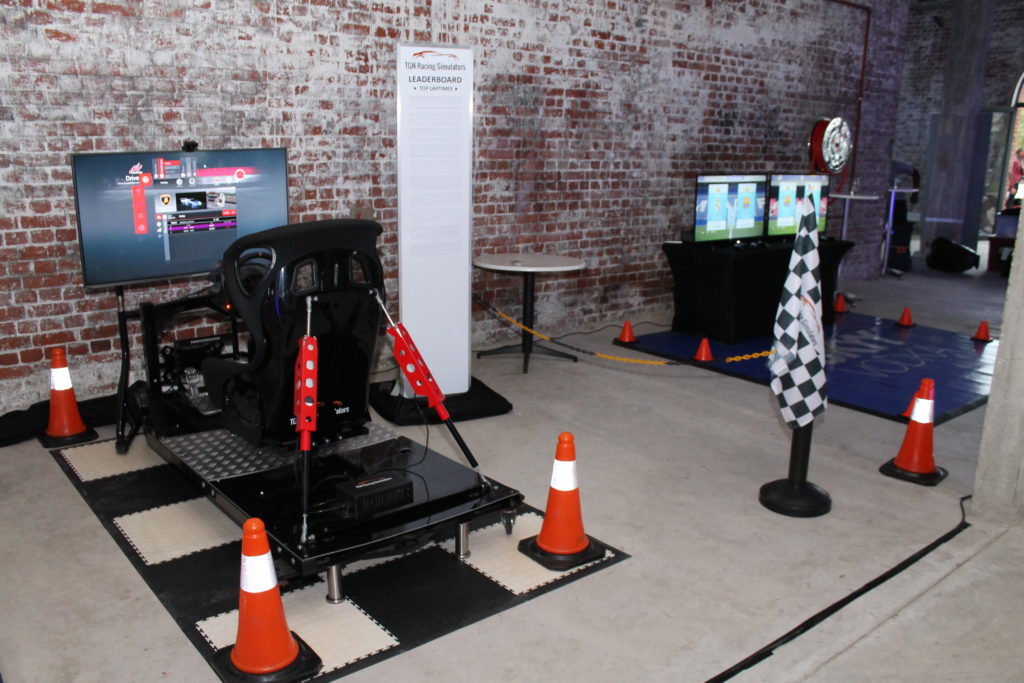

    So as it turned out I went on Friday night to pick up the fiberglass seat, it's small so I want to see if I can convert it into an adjustable seat, anyway so the guy selling it is in the simulation business and this simulator is standing there, and I thought hey let me ask him about it... Says he sells them for $37500 "It's a full motion simulator".... Nice guy but I couldn't believe the price, I was too shocked to even ask if it's imported or if he has it built locally.
    What do commercial units go for?
