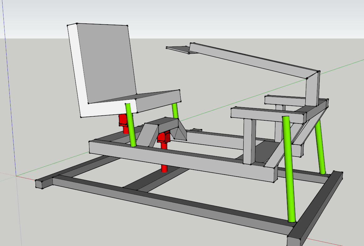

    It's best to have the UV joints pivot point as close as possible to the center of gravity vertically, correct?
    What do you guys think of the location of the pivot point in this drawing (for the frame). Does it make sense to raise it like this?

    Ok the frame your looking at will have more roll than pitch actually a massive difference. Bottom uni will be close but a test can be done to find its final position. The Seat uni in the wrong place, will load the motors with all the weight of the seat plus the driver.

    The pitch and roll difference can be compensated for with the software though, right?

    yes, my foot motor frame had big roll, so i fixed the profile to make it even

    Yes you are correct the beauty of SimTools is that we can decide on how much % of the Axis movement will be used by each force.
