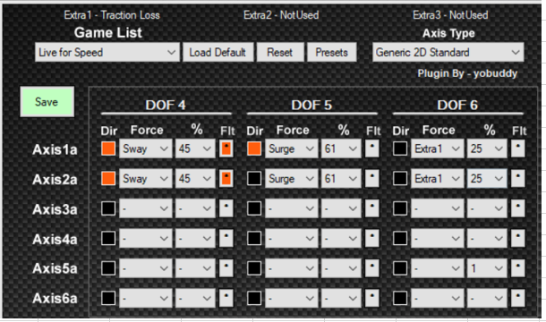

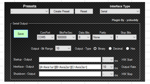

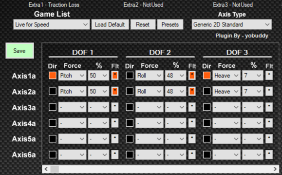

    Now, I run into some setting issue...Hope someone can guide me here....I can't get my 3 rd motor to move (traction loss). It is fine in SMC utility. All motors works but just not in Simtool. I assigned DOF 6 using Extra1 (for traction loss). Doesn't seem to work.
    here are my setting below:
  2. SeatTime
    2,572
    There are no DOFs assigned to Axis 3....

    Do you have any screen shot what Axis 3 should look like?
  4. SeatTime
    2,572
    Were does Axis 3 sit in your rig? If traction loss then add Extra 1 to Axis 3a and remove it from the others.
    22,185
    154,732Coins
    +11,195 / 57 / -2
    Extra1 should be assigned to Axis3a for traction loss with corresponding Interface Settings for the 3rd axis.

    Your Axis Assignment allocations percentage totals are way too high at well over 200%: https://www.xsimulator.net/community/faq/axis-assignment-percentage-totals.120/
