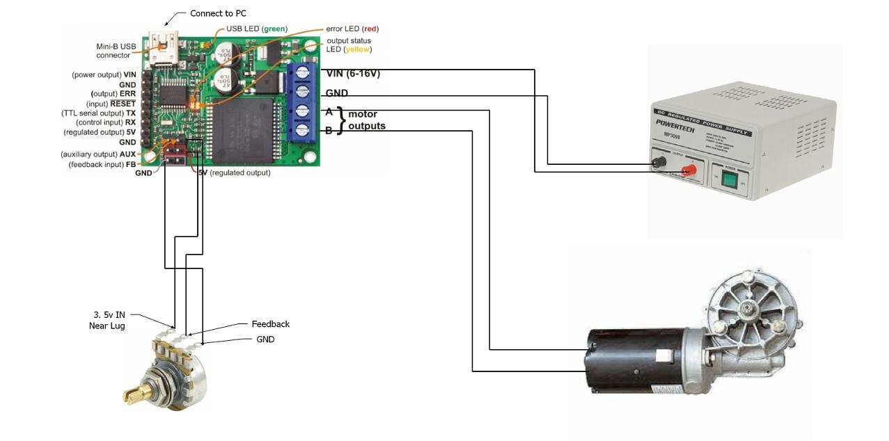

    OK, thanks for posting the videos. Now I can see the problem.
    Firstly,Your pots are NOT being turned by the motors, they are not even connected to them in any way. They are mounted next to the jrk boards.
    Look at the following video
    http://www.youtube.com/watch?v=IdeB29UT ... r_embedded
    The pots have to be turned by the motion of the frame and-or motor. Not by your hand. You have to set up the pots so they are operated by lever system to turn them. This way the pololu boards know where the motors are as they are getting a feedback signal from the pots.
    Secondly, on the motortab in the jrk utility program, LEAVE IT ALONE!!!!! DO NOT TOUCH!!!! Leave the max and min duty cycle alone.
    So you need to set up the pots on a lever operated system first. After that we can go through the process of feedback learning.
    Look at my videos again, at the right hand side of the frame up and near the motor I have mounted a pot with a lever system to the frame. The pot knob turns with the frame up and down. You need to build something like this or as per the video above.

    ohhhhhh!!thanks alot and now new problems born my pot is plastic isnd dangerous to broke the pot my moter?and how long must be the frame?
  5. bsft
    I have used plastic post pots fine. They do not flex as I made a lever system so they turn somewhere between 90 and 180 deg . There is no recommended length of the frame to the pot. Start with this, get a couple of wooden icy pole sticks and work out a lever system and where the the pot can be mounted near the motor. Thats what I did. I moved the frame up and down till I found a good point of leverage. Then I made something more soild up in the leverage set up. I went to a hobby shop and found some lever arms from large radio controlled cars.
    It took a while but I got it. Google leverage if you need to. Look at the videos and you can get an idea of where and how people have placed their feedback pots in relation to the motor position, thats what I did.

  9. bsft
    Read the pdf manual from pololu
    Page 20, set the max current up to around 17amps and try again. There is a chance that the motor is drawing a lot of current and setting off the error. If it keeps doing this , up the current to 18-19amps. Put a small heatsink on the big chip of the board and a fan near it. These boards get hot.
    Page 37,
    Connecting power and feedback

    Read this, work with the max current setting, we are not using these for battle robots that do not use much power, we are using wiper motors that are trying to shift 80kg +. They are going to draw some current. I have mine set at 19amps. It works fine - so far.

    4. Connect your feedback sensor to the FB input. If you are using a potentiometer as a feedback sensor, use
    the AUX pin to power it, and enable Detect disconnect with AUX in the Feedback tab.
    i must to do that?and if yes what thats mean?
  11. bsft
    Look at the photo, wire up the pot as shown. The potentiometer is you feedback sensor. When it moves with the motor - frame, it generates a signal back to the jrk board to tell it where the motor is so it knows how far it needs to turn your frame.
    Yes enable feedback disconnect in the jrk utility program. This is a backup to protect the system in case the pot fails or moves. I know this from experience.

    to set the pot on the motor is hard i think very hard i try 2 deferent way but i amnot ok.The pot if dont move doesnt show stable numbers the numbers at the scaled feedback change every sec up and down that is bad e?
  13. bsft
    remember how you were turning the pot by hand when they were on the box with the jrk boards? They were generating feedback.
    Try this, set the pot up on a right angle bracket near the motor, use the nut supplied to hold it steady. Attach a lever on the end of the pot shaft. When you move that lever, the pot shaft moves.
    Now using another lever, find a way of attatching it to the motor arm. So when the motor arm moves, so does the shaft of the pot.
    There is no other way, you have to set the pot shaft to be moved by either the frame itself or the motor arm. If you cannot do this or try to figure out a way, go and buy the simexperience kit http://www.simxperience.com/Products/DI ... fault.aspx and get the motion starter kit.
    No pots to setup, just two actuators and a control box. It will set you back at least $1200, but the simplicity of it may be your answer.
    As you have a couple of jrk boards, advertise them for sale here on the forum. As well as the motors.
    Thats all I can suggest now.
