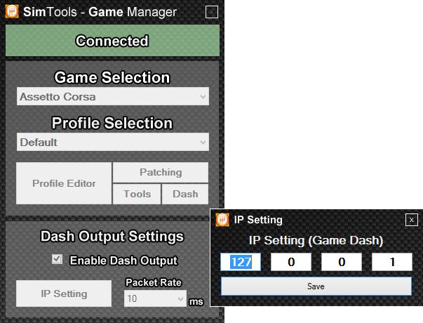

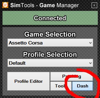

    In the GameManager click on "Dash" to open the dash drawer:
    Define the IP address (by clicking on IP Setting), to where the dash data shall be sent to. If you have a single PC setup, just write 127.0.0.1, if you have dual (or more ;) ) PC setup, specify the IP address of the receiving PC (Windows-key + R – cmd – ipconfig):

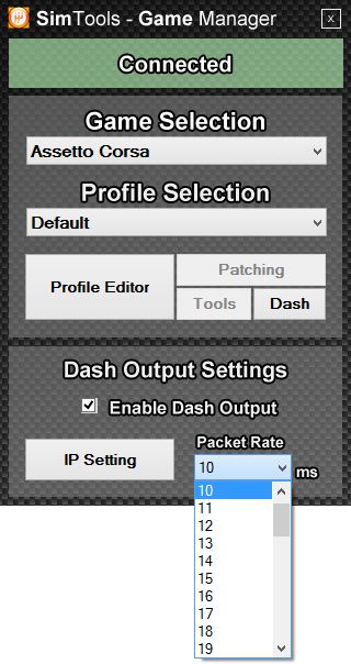

    Now select the Packet Rate:
    and click Enable Dash Output and Dash again to close the dash drawer.
    Done.
