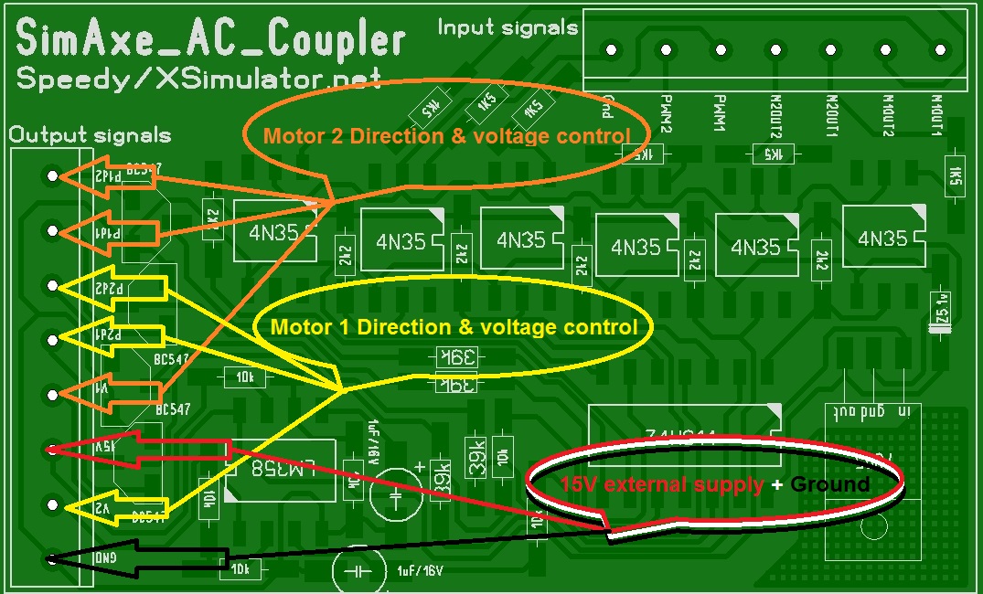

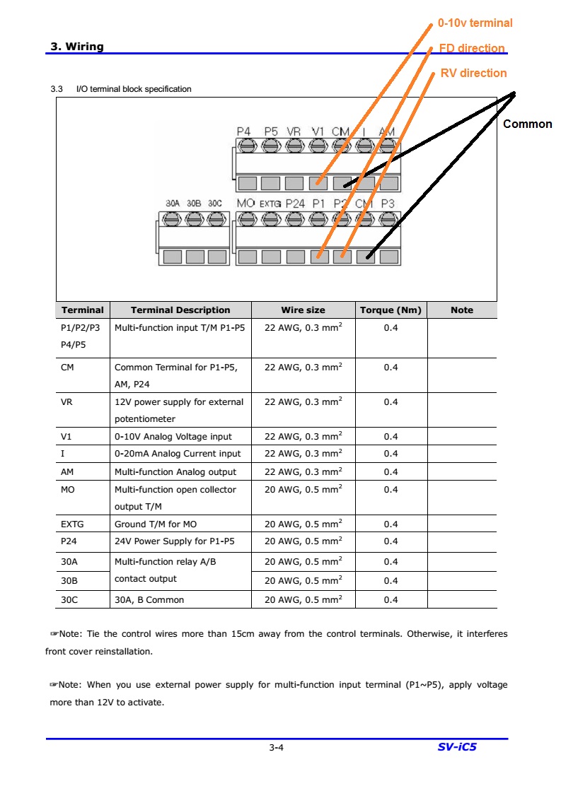

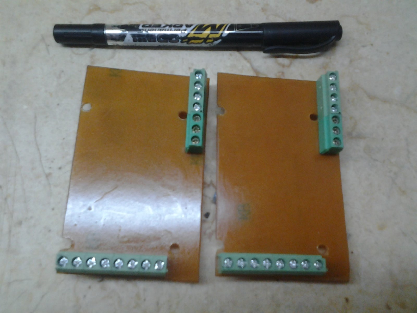

    they are the same @hooshang ...
    But I had to use two wire so to split them [V1 + CM] coming directly from the opt-coupler board output connector for motor 1 ... and [Directions "p1d1 & p1d2" + CM] coming from the limit switches which are connected in series and they are located in the actuator ...

    @speedy
    hello freind
    two questions:
    1-doeas the Simaxe ac coupler board works also with 12 v power supply or its better or have to use 15?
    2-does this board couse some delay?
    thank you
    regards
    Hooshang

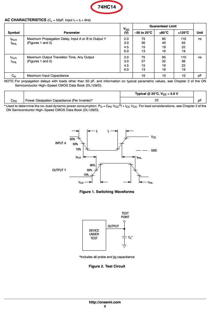

  3. speedy
    speedy Well-Known Member
    Feb 1, 2012
    1,193
    Alexandria , Egypt
    7,944Coins
    +1,287 / 10 / -0
    Hi @hooshang ...
    Good questions .
    1- what ever you can use up to 30V ... But be careful that the analog output voltage going to VFD will be related to this input supply voltage .. Ex. [ 12vin > (0-12) V1out] & [15vin >(0-15) V1out] & ...etc.
    2- Nothing is ideal ... and overall time shift/delay is there in the scale of the Nano & Micro second ... which is very very very acceptable .

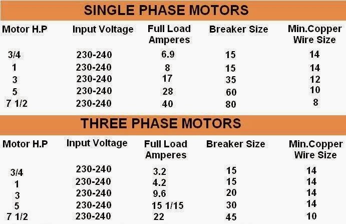

    Just for my future reference for CB and wire sizes.

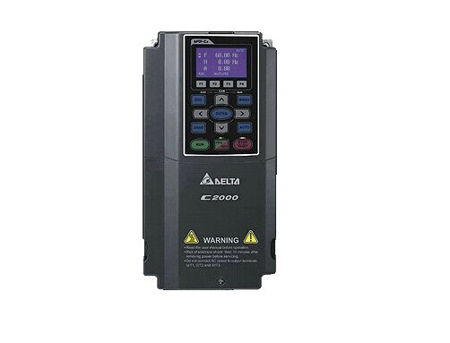

  10. aliotic
    aliotic New Member
    May 30, 2015
    7
    Iran
    293Coins
    2DOF, 3DOF, 4DOF
    I am using Delta VFD-B drives. Each inverter has the appropriate break resistors. Communication is set to Modbsu ASCII with 38400 b/s baud rate. The control loop frequency is around 7 Hz. I have added encoders to the back end of the motor plus encoder extension cards on the drive. my problem is that these drives do not provide position feedback although there is an encoder present speed is calculated via encoder pulses and presented to the user as pulse/sec. in order to achieve position control i integrate the speed value read from the drive (after homing) which has a near satisfactory result.
    The other problem with these drives is that they do not accept CW / CCW motion prohibition like servos. this functionality is important to stop the motor automatically when reaching the limits of the telescopic linear actuators. the drives have a stop input but what we need is the ability to stop the motor in one direction whilst allowing it to accept the other direction. for instance when the actuator reaches the top limit switch it should stop the motor but still be able to move in the downward direction.
    I found the Delta C2000 VFD which is a little bit more expensive but has very good functionality however the problem is that the drive is a three phase inverter which is not suitable for me.
    at the moment I am trying to implement @speedy 's advice and have bought arduino boards. An Arduino Nano board to read the encoders (used as counters) and one Arduino Mega 2560 to implement the controller and generate pulse direction signals for the drive. I have not completed so I can't provide further info.
  11. speedy
    Feb 1, 2012
    1,193
    Alexandria , Egypt
    7,944Coins
    +1,287 / 10 / -0
    Hi @aliotic ...
    Good job so far :thumbs ...
    And to keep it simple so others can benefit from the concept ... As you can see normal affordable VFD's used here are NOT for tracking speed or position ...
    I use/consider them just as a 3-phase H-Bridge for AC motors ...
    The controller is a totally separate board + the opto-coupler VFD interfacing board .
    FYI: We have a very good powerful code projects for Arduino's ... as I may suggest SMC3 is a simple and Big project with one Arduino Uno board to fully position control 3 motors at the same time with a normal 10k pot as position feed back signal ... read post 1 and post 2 for more information ...
    And that is really Good Sophisticated Expensive piece of equipment ...

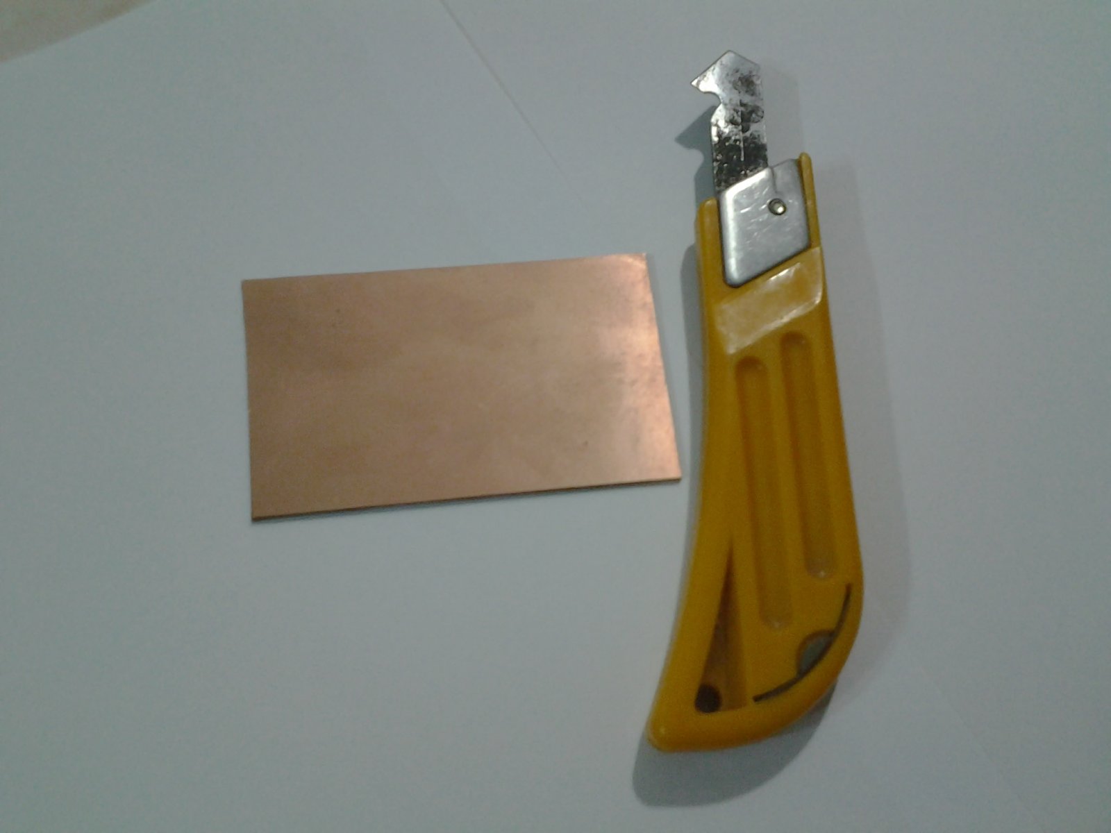

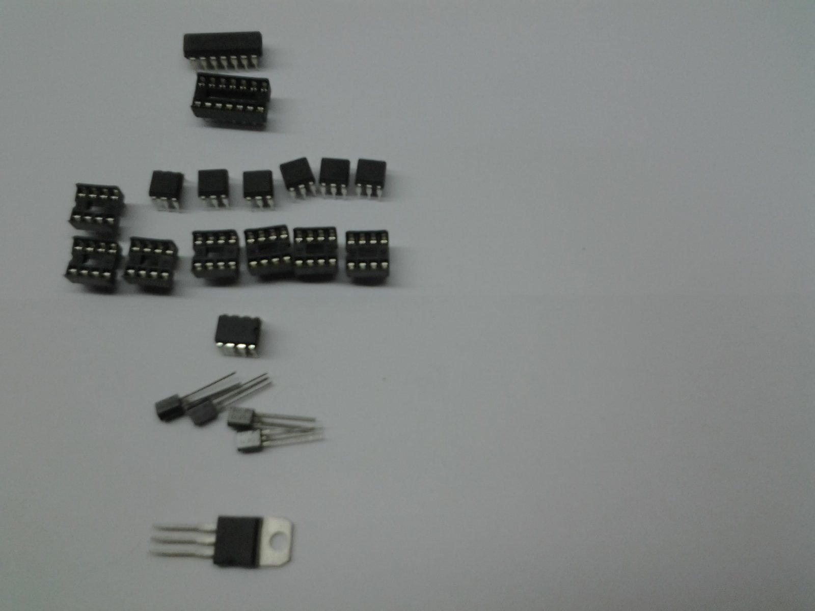

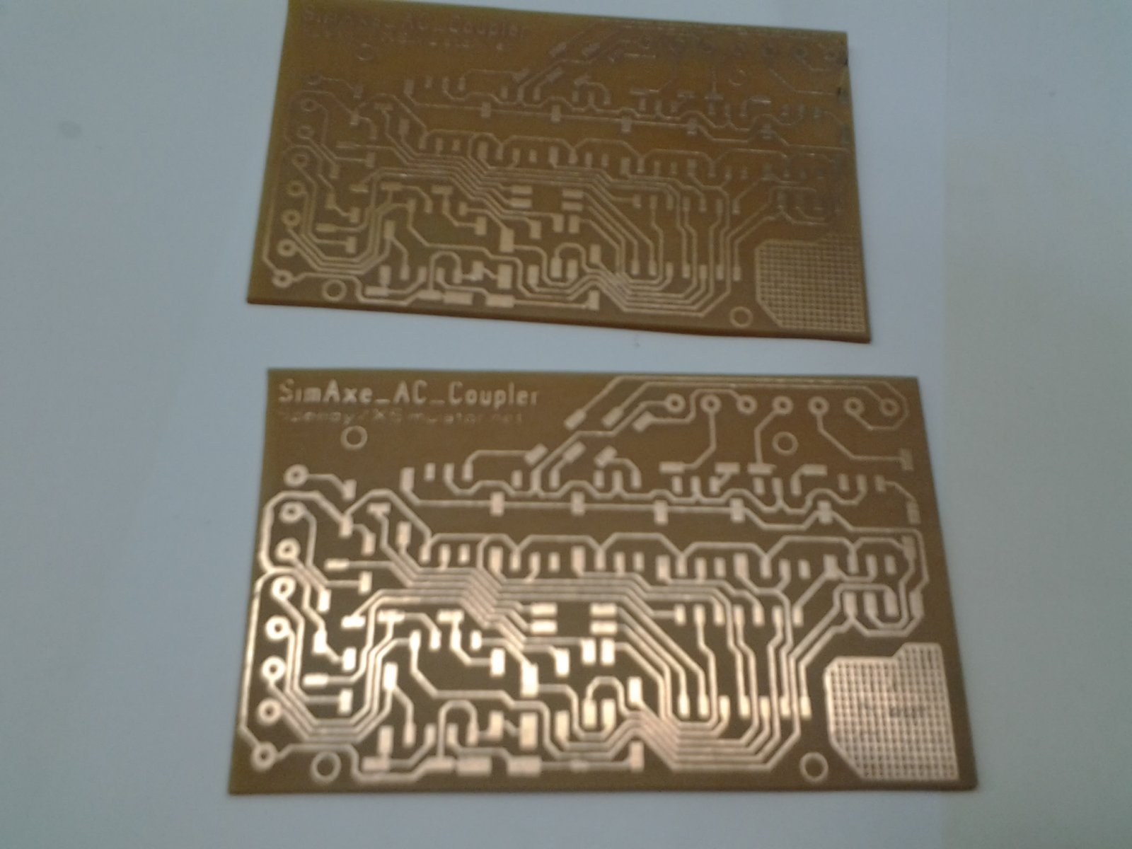

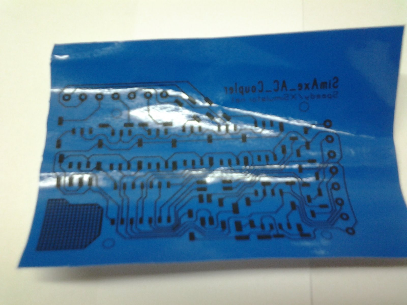

  13. speedy
    Feb 1, 2012
    1,193
    Alexandria , Egypt
    7,944Coins
    +1,287 / 10 / -0

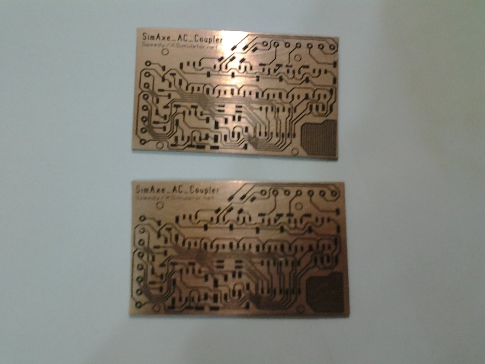

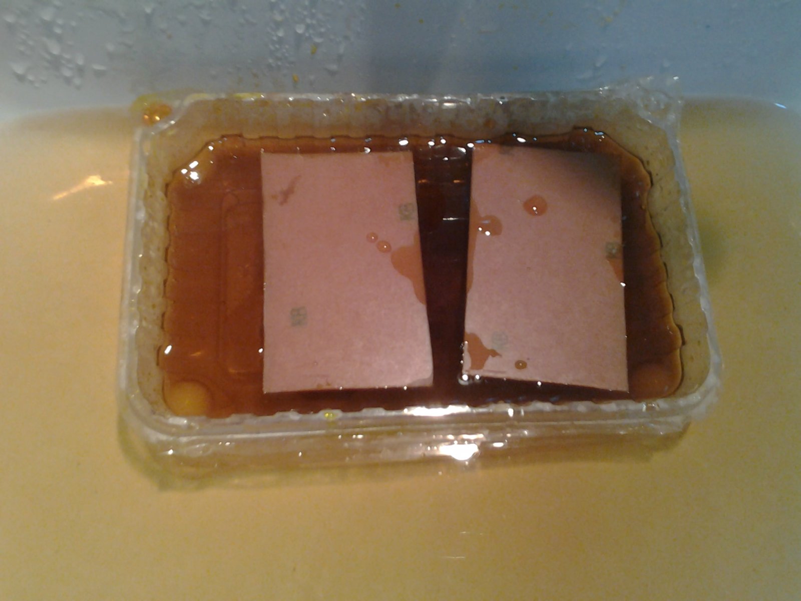

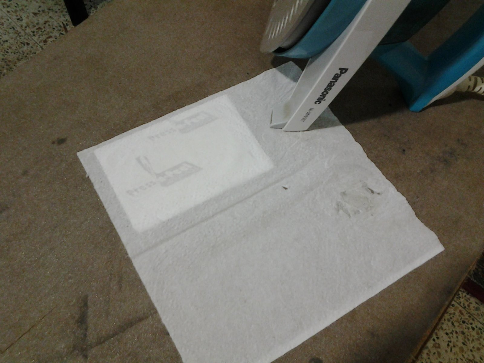

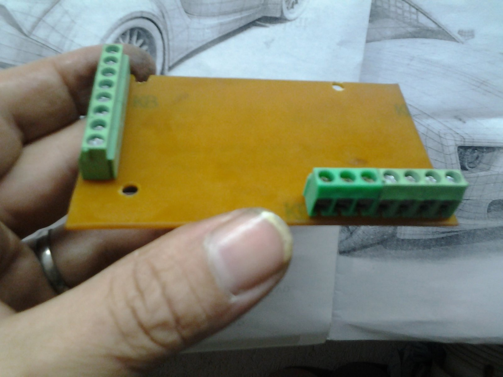

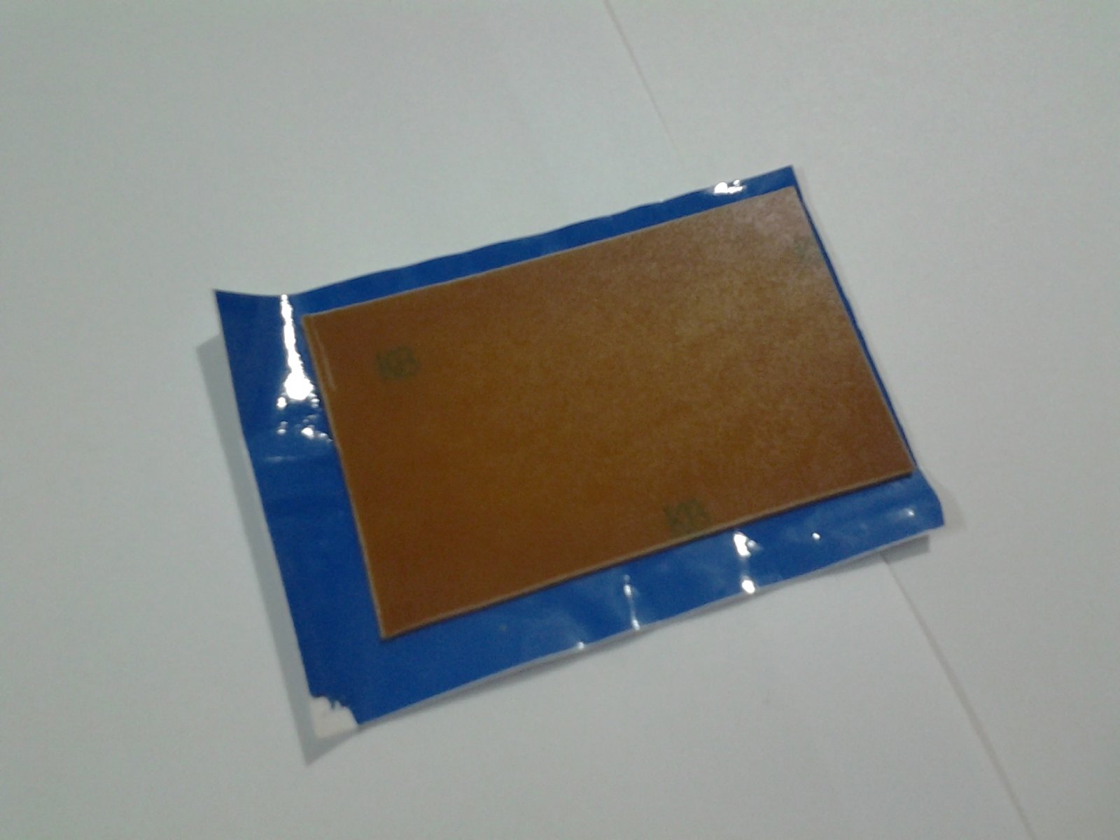

    The making process ...

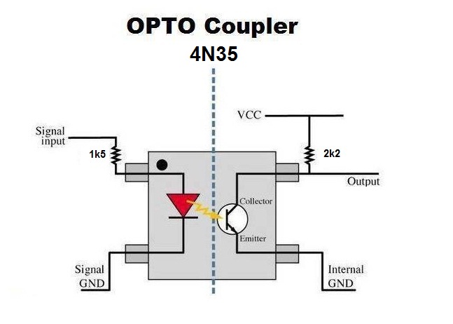

  16. hooshang
    hooshang Active Member
    Jul 6, 2011
    273
    275Coins
    +157 / 3 / -0
    @speedy thank you for quick reply
    - lets explain in this way ,the sensitivity of pot was very low all the time and even in output testing when i drag the axis to the
    left or right it took much to make motors move.system was somehow lazy
    - i got some information from @prilad (dont remember the link of thread) about optocuplers ,just using resistor 450 instead 2k2 and 180 instead 1k5
    and got much better resault with much more sensitivity
    regards and shokran freind
    Hooshang
  17. speedy
    Feb 1, 2012
    1,193
    Alexandria , Egypt
    7,944Coins
    +1,287 / 10 / -0
    @hooshang ... Anytime buddy .
    First make sure that Arduino output signals are in the 5v form NOT 3.3v ...
    then you will realize that the 2k2 & 1k5 resistors are load resistors they only affect the operating voltage of the internal LED and transistor of the opto-coupler ...
    If you still have problem ,So you need to increase the PWM input signal ratio .
    I would recommend you to increase the PWMmax in the SMC3 up to 255 ...
    As I previously used the SimCtrl FW of @prilad and increased the PWM to give enough signal to operate the motors ...
    See if that solves the problem if there any .
    Best Regards And shokran To you too ... :grin = thank you in Arabic

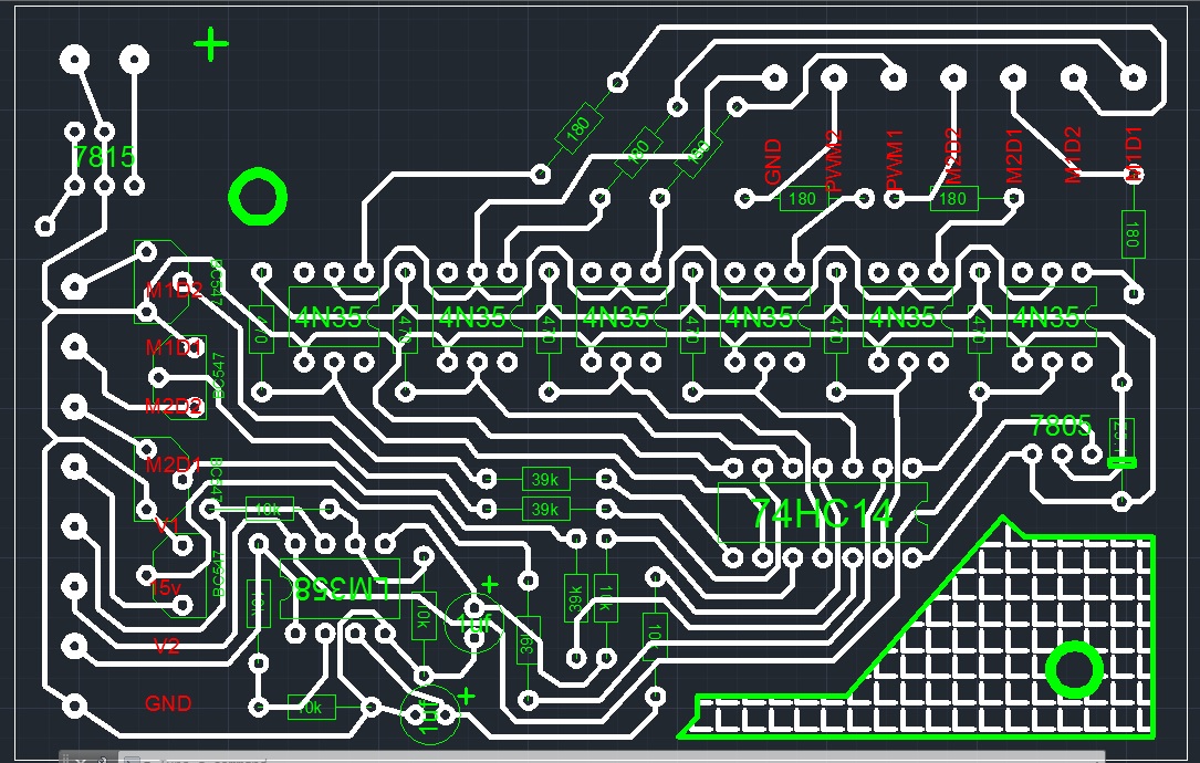

  18. hooshang
    Jul 6, 2011
    273
    275Coins
    +157 / 3 / -0
    @speedy
    well thank you again " super Speedy"
    iam not electrician,i've learned a lot from you and others here but let say ive done alot with SMC3 utilities and Ard
    i have tested a lot of options on breadboard for this too and i want you to check what i said about resistors
    and find an explanation for that or even test to find if iam right or not,
    thank you

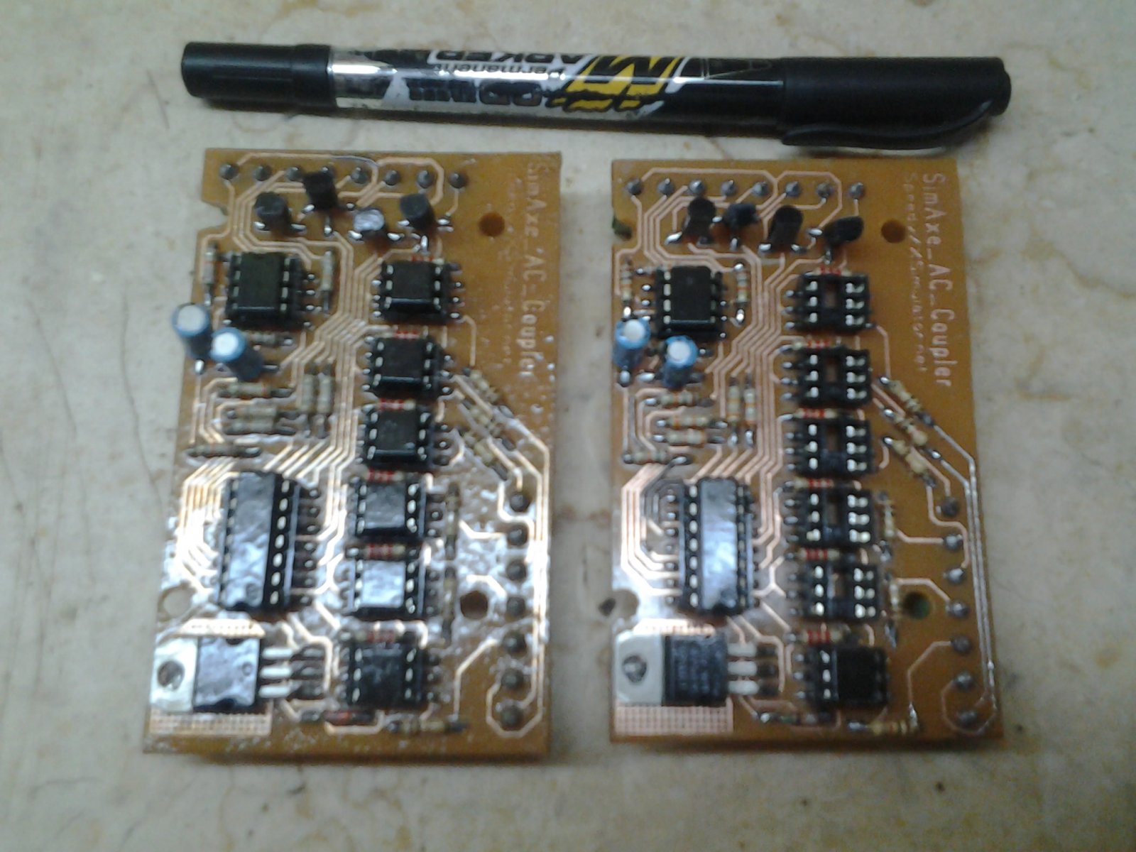

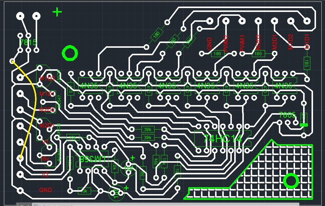

  19. hooshang
    Jul 6, 2011
    273
    275Coins
    +157 / 3 / -0
    @speedy
    here is your optocopler that i've modified

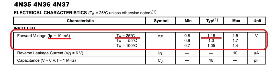

  20. speedy
    Feb 1, 2012
    1,193
    Alexandria , Egypt
    7,944Coins
    +1,287 / 10 / -0
    Hi @hooshang ...
    Here is what I remember I did regarding the calculation of the resistors ...
    Starting with the datasheet of the 4N35 optocoupler ...
    http://www.ben.cz/_d/datasheet/4n37.pdf
    on its second page it states the required forward Voltage and Current for the INFRA RED Diode ...
    you can put these values with this online LED resistor calculator ...
    http://led.linear1.org/1led.wiz
    It will give you a 390 Ohm for the input resistor ... !!!
    That would be the minimum standard resistor to be used with this optocoupler and you start to complete your total design calculation from that value .
    So using a 180 Ohm for input resistor is IMHO is putting an overvoltage on the IR LEDs ... plus consuming more power from the Arduino for each 3 lines per motor output ...
    On the other hand the 450 Ohm for the transistor side is not high enough to compensate the digital low state for the 74HC14 schmitt IC when the transistor is ON ... And the overall mA drown from the 7805 regulator will be huge [ heating problem ] ...
    use this circuit simulator applet to see what I mean ...
    http://www.falstad.com/circuit/
    Anyhow ,I'm pleased that you're satisfied with the results you've found so far ... if you post some videos for it with the SMC3 Util. and the difference would be great .
    Very nice drawing BTW ... I assume there is a jumper wire here
    Can you just post the Doable pdf files for this through hole layout so others can benefit from it ...
    Thanks and have a nice time .
