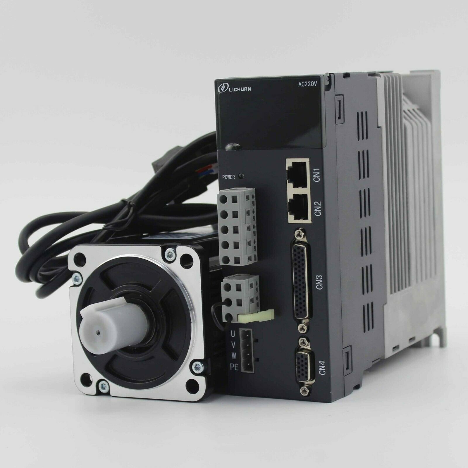

    Is anybody using a servo motor kit like this one on e-bay for 370 usd
    80st-M02430 0.75KW Servo Motor 2.39Nm with Drive AC 220V Servo Kit 3M for CNC
    750W Servo Driver Main Features
    1. Three control mode support, Position control, speed control, torque control
    2. With Pulse + direction, CW/CCW, AB pulse three pulse modes;
    3. Support pulse feedback frequency division function;
    4. ±10V analog voltage control;
    5. The origin search function;
    6. 24V pulse input common terminal and the 24V collector output Z signal;
    7. MODBUS bus control;
    8. 2500 line incremental encoder, brand new Japan NEMICON encoder.
    9. Brand new IGBT mode, stable and durable.
    10. OEM service and Neutral Packing available.
    11. Application in high precision control machine, robot control, CNC machine,ect.
    12. with 2500 line incremental encoder.
    13. Articles made to order: drag, oil seal
    14. Axis: Circular shaft/ keyway
  2. wjh308
    wjh308 New Member
    Sep 28, 2015
    20Coins
    Those are what direct drive steering wheels use, I also use one for the spindle drive in my CNC mill, and will put one on my Monarch 10ee lathe. Servos are nothing more than AC motors with built in encoder, and appropriate drive.
