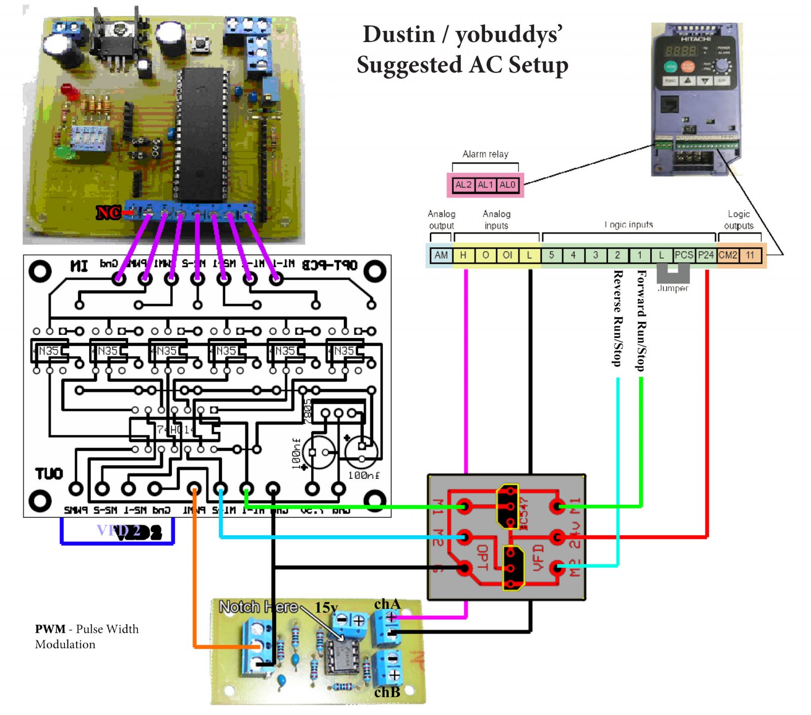

    The attachment is from my friend, @yobuddy, who was kind enough to send me an initial tentative component/wiring diagram when we first started talking about my needs in building my AC Platform.
    @speedy: I've downloaded the Operators Manual several months ago on my VFD/VSD that I will purchase shortly - I'm as far in the manual to the Wiring Diagram for input/output of the
    2 phase to 3 phase - and I do "see" where you would hook up from your electronics board - I AM trying to "get my head around" and correctly understand some of the explanations and
    nomenclature - WELL, please understand, it's like teaching a person to weld or do accounting that has NO clue or idea of what I'm talking about - it's a hard sell, and sometime an exercise
    in futility - One thing is FOR SURE - I will NOT let someone do my job without my intervention...it's the only way I know how to work....and FINALLY, I am mature enough to know when
    I'm in "over-my-head" that could put me into a dangerous situation.

    From your attached image and the way it seems to be done now you have the following manner of connecting things:
    PC-Controller Board-VSD-Motor
    PC: Extracts data from game and sends the new setpoint to Controller Board
    Controller Board - First needs logic to determine what new setpoint belongs to what motor, then it does an error check with the setpoint by comparing it to the sensor and it then calculates an analog output voltage that is connected to the VSD. It also needs to tell each VSD when it should go FWD or REV. This controller board has allot of calculation to do.
    VSD: Simply goes where it should according to its analog input value received from the control board.
    What i am suggesting is this:
    PC-VSD-Motor
    PC: The PC will still do the same job it did before. After reading what i said about the PC not calculating PID i can see why it is confusing. I meant it as a statement to show the flow of things. Unless your PC was used to calculate your PID from before then only will you save processing time on the PC by letting the drive do take over the PID control.
    Please excuse if this is too basic, but i will try to start here.
    So a VSD takes AC input, it goes through something called a rectifier and filters to change it into DC and then transistors are used to change it back into the correct AC for the motor to turn in a certain way. All the algorithms like vector-flux control and sensorless control and spaced vector control have something in common and it is the way/manner in which the AC signal is send to the motor.
    Most of them have voltage available on the terminals to power up your sensors. It is more sophisticated than you might think at the moment.
    When i work with pumps i only use two analog inputs on the terminals of the drive: 1 for feedback and the other for a setpoint. So i have a pressure transducer that reads the pressure in the pipeline and a pot to adjust my setpoint. If i want a pressure of 3 bar at all times at my pump then i will change the setpoint (pot) value to give me 3bar. If the flow in the pipeline increase because somebody opened a valve, then the pressure will decrease and the speed of the motor will go up. This is a basic closed loop system.
    The same principles will apply with a simulator. We will need a transducer type of sensor, but this time it is a sensor to measure the position of the gearbox cantilever. This sensor is powered by and connected to the drive. The second analog input does not have to be connected to the drive if one is able to change the setpoint from the PC using comms.
    So many of these VSD's are being made. I dont think the price should be too expensive. That sensorless VSD you showed me is great, but perhaps too great and that is why they charge so much. Also why is everybody so stressed about the sensorless VSD? I understand that you want your ac motor to react like a dc motor, but there are other factors like those i mentioned above that are also important. If you can still decide what VSD to use, then firstly decide if you want to use an external controller (with simtools support that is available now) or a comms protocols like modbus (that will hopefully be available someday) and then secondly buy your VSD based on the option you have chosen. For comms option i suggest starting with a drive that gives you good analog input calibration.
    Cheers.
