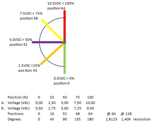

    Well @speedy, easy it will not be and I like to use the word challenging in this instance. I believe that is why we do this and share the "pain", the sweat, the frustration, joy and knowledge.
    When utilizing the VFD as a servo controller this can be done, I look at this as a positioner that will go to a calibrated position equal to the command (voltage level) put on the input. Reading up on the Servo controller you could scale the servo within the range of 0 - 10Vdc (+/-) = 0 - 64 defined steps (or even 128 steps). My understanding of this is that on the output shaft of the reduction gear box a rotation of 180 degrees would be something like this sketch:
    I would personally go for the (B)setting with a 0%=0,5Vdc to ensure that all is well as 0V is difficult value with 100% = 9,5Vdc to keep it all nice and tidy. According to what I have been reading is the PID controller & all the "bells and whistles" embedded in the VFD more than capable of getting to the next position at with in a certain set time frame and controlling it all, with some tuning, to a soft stop at the set position. With 64 programmable positions or I believe double that with some playing a resolution of 1,4 degree per position is feasible.
    The 0 to 10Vdc comes from a circuit that you @speedy made me aware of:
    For the code I should do some more reading how all is presented by motion software but surely that would be possible with some further reading on the subject and various codes presented within this forum. :)
