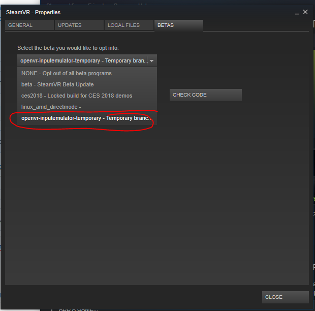

    Hi ,
    I downloaded the last open vr emulator release 1.2 (from 1.1 beta) and today there was a new steam vr release 151 5189291 and nothing works now.
    It's unpossible to map my touch . When I want to map my right controler , I become back the information device not found !
    Does anyone have the same issue ?
  13. SeatTime
    2,572
    Well actually yes, they show up in Steam VR, but will not start tracking in VR Input Emulator. The Error I get is 'Could not set Device Mode: Device not Found' Obviously a update is required to the VR Input Emulator. 1.2 was working for me yesterday.
    https://github.com/matzman666/OpenVR-InputEmulator/issues/57

    Yeah once Steam VR updated my VR Input Emulator won't connect to any controllers. Getting same "could not set device mode: device not found".

    Hi all ,
    On the github I found this in the issues for the open vr emulator.
    https://github.com/matzman666/OpenVR-InputEmulator/issues/58
    I did what written , downloaded a special steam vr app for'open vr app
    - updated revive
    -launched open vr emulator 1.2
    -re-patched the game
    And now everything is back ! Motion canacellation again works well.
  17. SeatTime
    2,572
    Great, that works for me too :). I just updated the VR application and opened/setup motion cancellation as usual.
