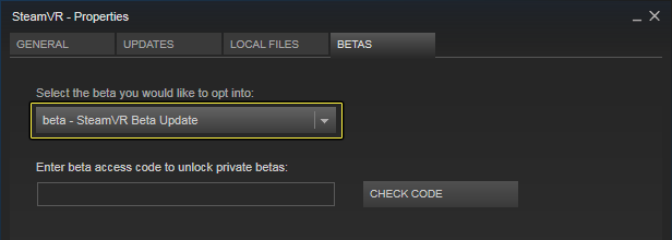

  17. SeatTime
    2,572
    +2,854 / 40 / -0
    Does this still work since steam closed off the VR beta to allow the motion compensation plugin to work?
  18. apointner
    apointner Siddhartha
    Aug 16, 2014
    63
    N 48° 9'0.88" E 12° 5'45.84"
    764Coins
    +17 / 3 / -0
    What the....? They do it like occulus, throw out the hole community and build a fence around?!
  19. clyevo
    clyevo New Member
    Nov 26, 2015
    23
    185Coins
    I am not at home so i cant try this, and i am planning to buy vive pro for this purpose.
    1. Can anyone try to opt-in VR beta in steam like in the picture and test if the plugin still works in this mode.
    2. Did anyone tried vive pro yet? Does it work as well or better than vive with the plugin.
