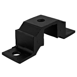

    4DOF
    I am struggling with getting motion cancellation working properly. I have Vive Pro with 2 lighhouses. I put a tracker on the top of the seat and fastened it down hard. When I turn on motion cancellation the picture gets jittery. When it is off the picture and tracking is rock solid. One thing I have noticed is if I turn my SimVibe off (4 mini LFE) then it is almost perfect, sometimes the seat movement will cause a bit of jittering. So it seems vibration is the culprit. Has anyone dealt with this and found a solution?
  17. noorbeast
    22,211
    154,729Coins
    +11,213 / 57 / -2
    It is a known issue, where the vibration frequency exceeds the tracking resolution. Perhaps try vibration dampening on the tracker mount.

  20. dododge
    dododge Active Member Gold Contributor
    Mar 8, 2015
    100
    854Coins
    +72 / 0 / -0
    FWIW I tried mounted my tracker on a rubber isolator. I think it helped, but it still wasn't 100% and I didn't have SimVibe running on the seat so it was only dealing with trying to smooth out actual rig motions.
    If you're going to shake the seat, maybe another approach would be to isolate the seat and shakers from the rest of the rig, and then attach the tracker to the rig itself somehow.
    Of course one problem with isolating the seat is finding flexible mounts that can also deal with the shear forces when you slam on the brakes. I saw a post somewhere recently with a a mount design that is stiff under shear forces so that might be an option.
