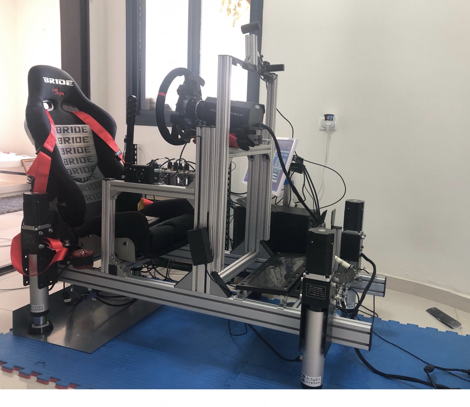

  19. Wajdi
    Wajdi Member
    Aug 13, 2018
    45
    416Coins
    +10 / 1 / -0
    8EBC89B7-BA44-4473-9A3C-0441E2526F1F.jpeg I’m the only one that doesn’t have problems with motion and oculus rift?
    Yes I’m new in motion and I have the sensors mounted on my rig and I can race without any problem.
    You can see the sensore mounted over the steering wheel .
