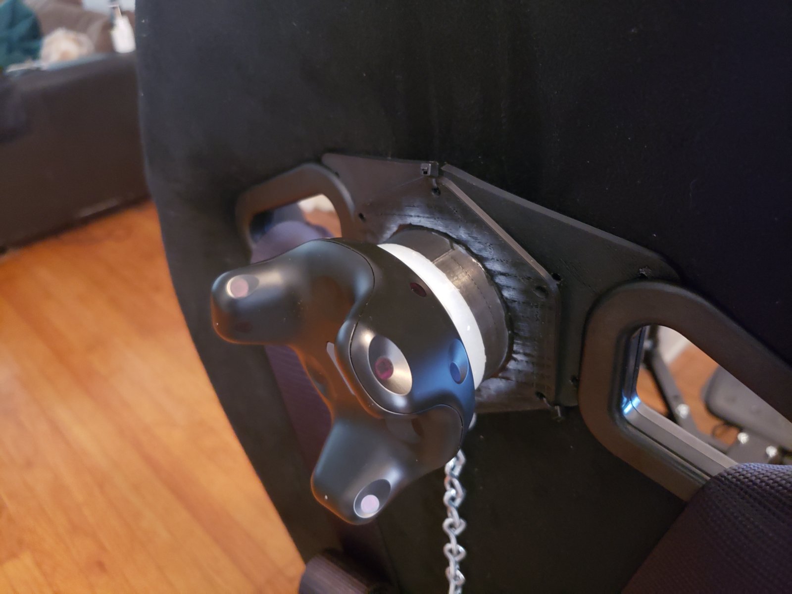

    Looks like you and I had a very similar idea :) I think my approach is a little more involved though since it involved 3D Printing and pouring rubber into the part. I can't post a link as of right now because I don't meet the anti-spam post limit just yet, but everything is only Thingiverse, just look up "Vive Tracker Isolation Mount"
    I don't suppose anyone is interested in testing this? My seats don't provide any properly rigid mounting spots (Corbeau Forza) so I can't rule out other sources of shaking.
    22,227
    154,831Coins
    +11,227 / 57 / -2
    Posting the link for you and others: https://www.thingiverse.com/thing:3603008
