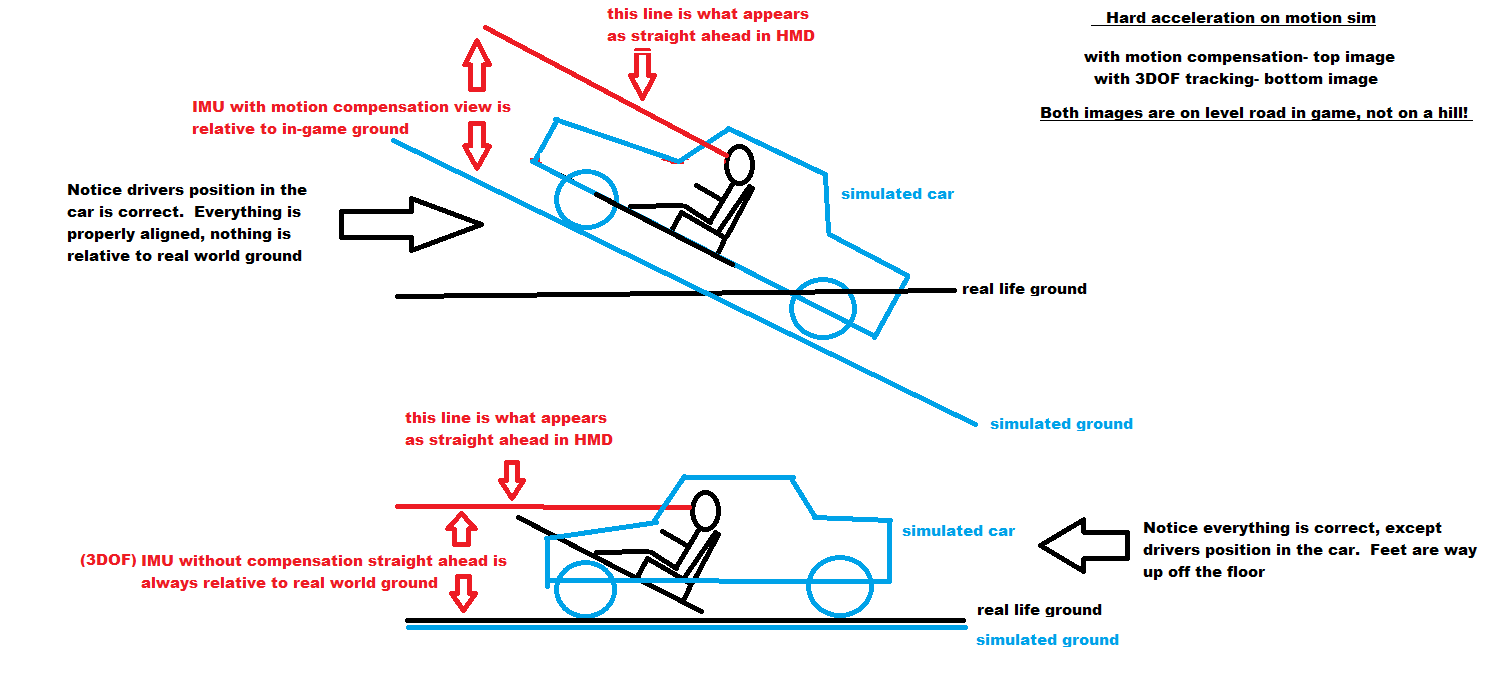

    compensation explanation.png 62756 62755
    My own experiments that I believe would have been the same as your WMR method was using Oculus CV1 with the cameras covered up.
    The problem I described resulted from HMD on board gyro keeping the pitch angle of my viewpoint relative to the ground instead of relative to the car. Whether or not this is noticed depends on how much pitch angle your simulator creates.
    @Newgun Notice that using your method your head is always in the correct place in the car, what moves around improperly is all the other parts of your body. This way you can always see through the windshield as you should, but your legs (most noticeable thing) are moving up and down in real life while your legs stay in the same place in the game. 62754

  19. Newgun
    Newgun Member Gold Contributor
    Feb 21, 2018
    40
    United States
    77Coins
    +14 / 1 / -0
    AC motor, 4DOF
    Hey Trip, great illustration! I totally understand the problem with the pitch angle which is problematic for hexpod/6dof rigs. My rig doesn't have any extreme pitch angles, which might be why a 3dof HMD without motion compensation is usable, but it's violent enough to make a 6dof without motion cancellation very disorienting.
    I do believe that the best way is with motion cancellation, of course, which I hope will be functional with the Valve Index.
  20. Trip Rodriguez
    Trip Rodriguez VR Pilot
    May 8, 2016
    683
    Lake Ariel, Pennsylvania
    3,978Coins
    +331 / 7 / -0
    Thanks Newgun. I had been meaning to make one of my infamous kindergarten ms paint illustrations of this for years because people frequently don't understand what I mean when I describe the rotational IMU tracking issue. Most everyone understands the translational error problem but not everyone gets the part I drew here.
    Funny thing was that using IMU only tracking like that what really bothered me was that my brain kept saying my feet were up in the dashboard or down under the car during accel or decel! It was a strange effect!
