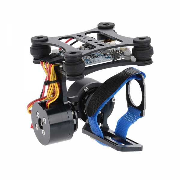

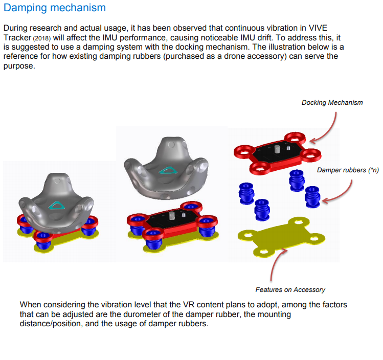

    From official Vive Tracker documentation: I don't remember seeing this the last time I looked at this document, I guess maybe I wasn't aware of the vibration problem being an issue for me/us at that time.
    Has anyone tried these drone dampers as indicated here? If so, what kind of results did you get?
    UPDATE: SilentChill and I both report failure with this method. I think it actually made it worse!
    I still have the drone gyro mount gizmo that was recommended way back at the beginning for mounting the Rift camera on the sim and I believe it has this type of mount. I'm going to go dig around and see if I can find it! Yeah, I've got the Kyosho gel to install, but more damping can't hurt right?
    Update: Found it! Attached stock image in case anyone is curious. How did I not think of this before?! This thing has an IMU mounted in it and is meant to be mounted to a quadcopter most of which have some pretty good vibrations...
    Only catch is that this chassis is made of metal, and there is supposed to be 0.8 inch space between bottom of Vive tracker and anything metal (except the screw and POGO connector) according to documentation to avoid causing issues with wireless communication to the PC. I'll put a .75" plastic spacer between, and gel on top of that. Will post in about 24 hours I expect I will have this mounted.
  16. SilentChill
    2,645
    20,598Coins
    +3,570 / 34 / -0
    Tried it, doesn't work at all at my end the vibrations just as bad I'm afraid. I wouldn't waste your money but hey you never know it may work for you :)
  17. Trip Rodriguez
    Trip Rodriguez VR Pilot
    May 8, 2016
    683
    Lake Ariel, Pennsylvania
    3,977Coins
    +331 / 7 / -0
    @SilentChill I think I'm going to have the same result with the drone mount. I set it on my HTPC tower and I can feel the vibration of the fans just as much on the "isolated" mount as on the tower itself. Might help with hard "bumps" though from the motion sim itself if that is even an issue.
    For me there is no money involved in trying the drone IMU dampers, I salvaged the parts from that camera gimbal thing that has been collecting dust for a couple years. With that, the Kyosho Gel, and my previous vibration isolation mod I will be three deep and hopefully have it solved on my sim.
    My previous efforts will be included in my upcoming Mk.2 sim post but basically I put vibration isolating mounts between my "cockpit" floor and the actual upper hex frame. Bass shakers are mounted to the "floating" cockpit, and the Vive Tracker is mounted rigidly to the actual hex frame.
    Depending on how smooth things get with SimTools 2.4 and my other recent mods (I'm not giving that one away yet!) I might go back to the cockpit being rigidly attached to the upper frame. That will depend on lots of testing, my current setup works pretty well, but it does add a little bit of "bounce" to quick sim movements and it seriously complicates mounting the sim controls firmly enough to suit so I'd be happy to go back if the other issues are all solved.

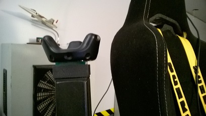

    Hey guys! I finally got the Kyosho gel tested, and also tested the drone mount recommended by HTC as shown above.
    Now, before I start there are a couple caveats: 1) I don't currently have the motion sim moving, I was testing ONLY with my four Aura ST bass shakers and no motion. 2) I had already somewhat reduced the problem as described in one of my last few posts.
    First I installed the tracker on a single square of the Gel, and (with a spacer) mounted that to the quadcopter vibration mount like the one from the HTC manual, and attached that whole assembly to my sim. I maxed out the tactile transducers with the test vibration in "SimShaker for Aviators". There was some improvement but after the first thirty seconds or so I started seeing issues. The Tracker was momentarily winking out for just an instant about once every fifteen seconds. =(
    Next, I removed the quadcopter mount and used just the single layer of Kyosho gel by itself. This stuff is amazing! I ran it for several minutes straight and didn't see a single error! I could actually see the tracker vibrating naturally, like you would expect it to do if attached to a vibrating base but without errors. This was with the shakers absolutely maxed. I'm sure it's going to be quite good.
    If I find in real world tests that it needs a little more I can still add another layer or two.
    Now there's one more thing to report here. If anyone wants to try a much cheaper option, I found (amateur) tests online indicating that using 32db orange foam earplugs, with the electronics rubberbanded down to slightly compress them might actually work BETTER than this stuff!
    I like that with this stuff I don't need to rubberband the tracker down and it's got a nice clean professional look, and it seems to work perfectly, but it did cost nearly $15 USD. Here is a picture of my final solution:
    Note: The black spacer below the gel is a piece of PVC to keep adequate space between the tracker antenna and the steel square tube. If at all possible you don't want to run a wire to the tracker while using the sim as the wire will transmit vibration past the gel. I tested with it running wirelessly.
