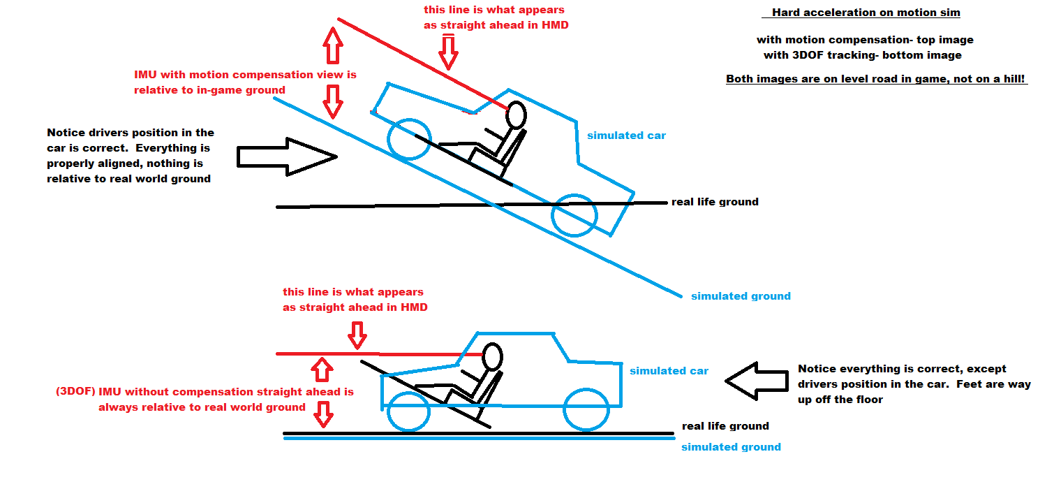

    @wonderin
    To put it most simply, imagine you installed your motion sim inside your car in place of the drivers seat. Whatever movements it makes are moving you around inside the car. This is what happens in VR with no motion compensation. Motion compensation makes the "virtual car" move with the simulator movements so that you are always positioned in the car the way you are meant to be.
    This might help you understand. How big a problem this all is depends on how much angle and/or displacement your motion simulator can produce.
    Also, with 6DOF rigs the translational movements will move you around inside the car. You can wind up with the sim moving you back enough that your vision is obscured by the headrest of the seat being in front of you. If your 6DOF had enough range of motion you could wind up with your head outside the car even!
