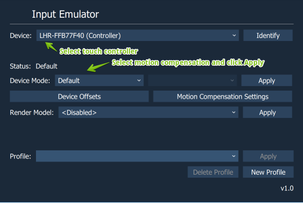

    Do you have a screenshot of this error message?
    As it took me several trial and errors to get it running i wrote a short instruction:
    Step by Step Instruction for Assetto Corsa and OpenVR-InputEmulator which works fine for me:
    What i use
    OS:
    - Windows 7
    Hardware:
    - Oculus Rift
    - 2 Oculus Touch Controllers
    - Install OpenVR- InputEmulator from https://github.com/matzman666/OpenVR-InputEmulator

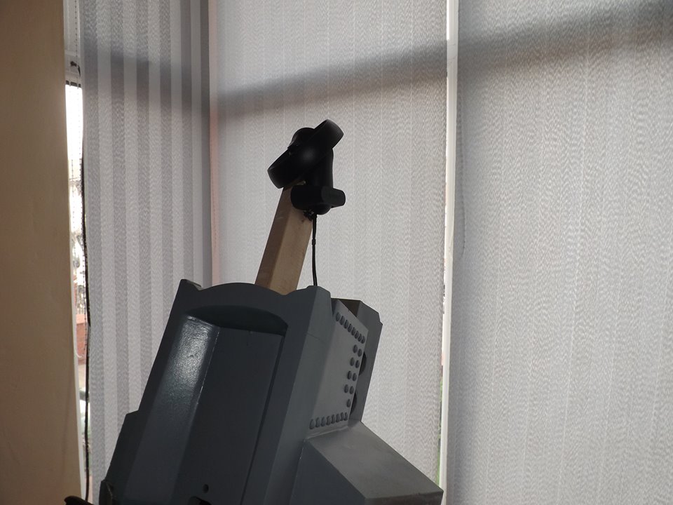

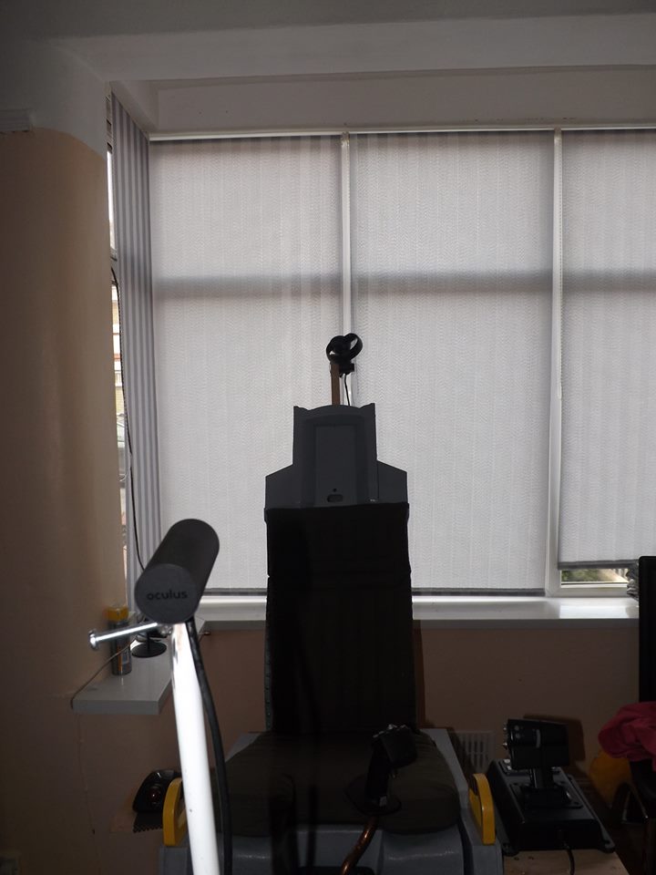

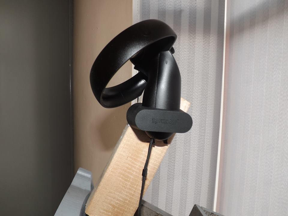

    - Attach the right touch controller to near of your head BEFORE starting SteamVR. Good position is above your head behind the seat.

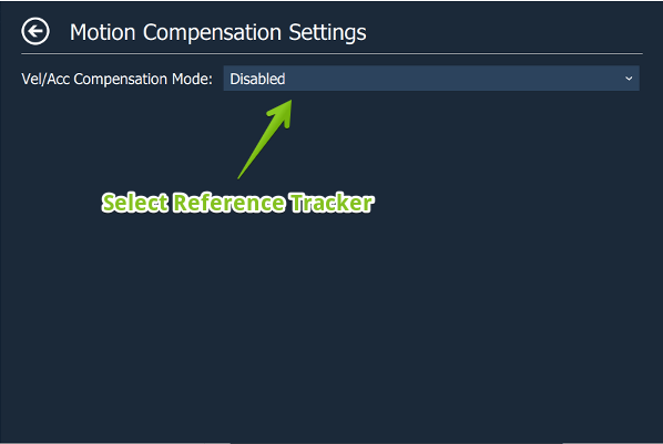

    - Start SteamVR and use the left touch controller to go into Open VR Input settings. Select the accurate device. In my case the right touch controller because the left one is needed to navigate around in SteamVR
    After pressing Apply the second tracker is calibrated and its location and position is saved in the input Emulator.
    Do not take off the tracker from the mount and do not adjust it manually after successfully calibrating. If you do this your HMD screen will be moved away from your eyes and you will have a hard time to navigate around in the SteamVR menu because in worst case the screen will not be longer in front of your eyes. If your tracker moved you better restart SteamVR and the input Emulator completely to get the new position of the tracker.
    After doing this, keep SteamVR opened and start Assetto Corsa from Steam as you usually do. That's it.
    Btw. I did also also install revive while i read that it is needed but i believe this is not the case for Assetto Corsa because i do not used the revive injector nor i used SteamVR to start Assetto.So i assume this is working without revive as well. I will verify this soon.

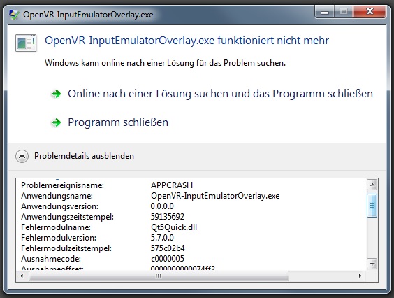

    Thanks for your nice instruction. One times, i get this tool to work. And the handling is very easy. This time, it worked fine. But only one time. It was today, as i intsalled the new version (1.0.3)
    My problem is, if i click some button (everyone) the tool is hanging (stop to react) and if i look on my desktop, i become this message: (translated: .....overlay.exe don't work anymore) not very helpful
    BTW: win7

    I'm in contact with him and give him, all he want. :)
  13. Bastiuscha
    Bastiuscha Active Member
    Apr 1, 2017
    291
    750Coins
    +192 / 2 / -0
    Update! At the moment it works! I'm happy!

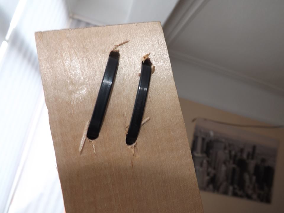

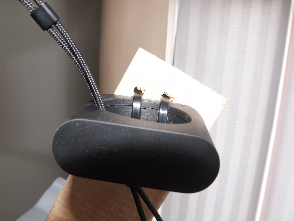

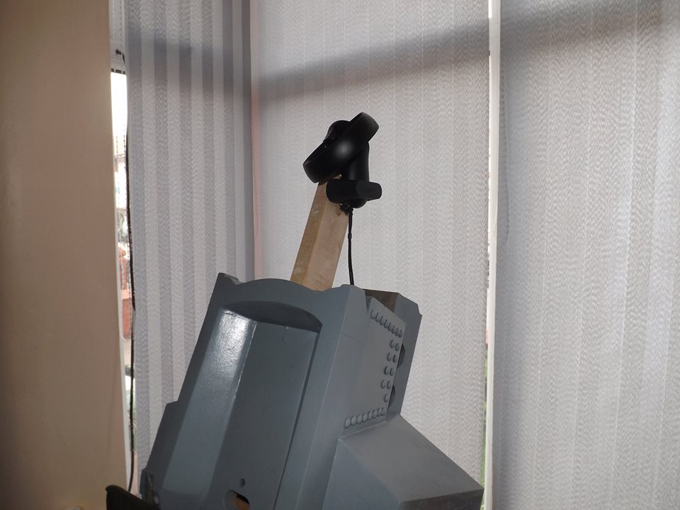

    Well the latest Oculus Runtime 1.15 has now completely borked the tracking, so I guess I need to go down this path.
    Anyone have any advice on this? Looking for a rigid, permanent-ish mount for touch controllers to mount to a flat surface.
  17. traveltrousers
    traveltrousers Active Member
    Jun 5, 2014
    115
    Timbuktu, Tombouctou, Mali
    890Coins
    +87 / 1 / -0
    Use your rockband touch holder.... or Oculus releases the same dimensions as a step file a while ago...
