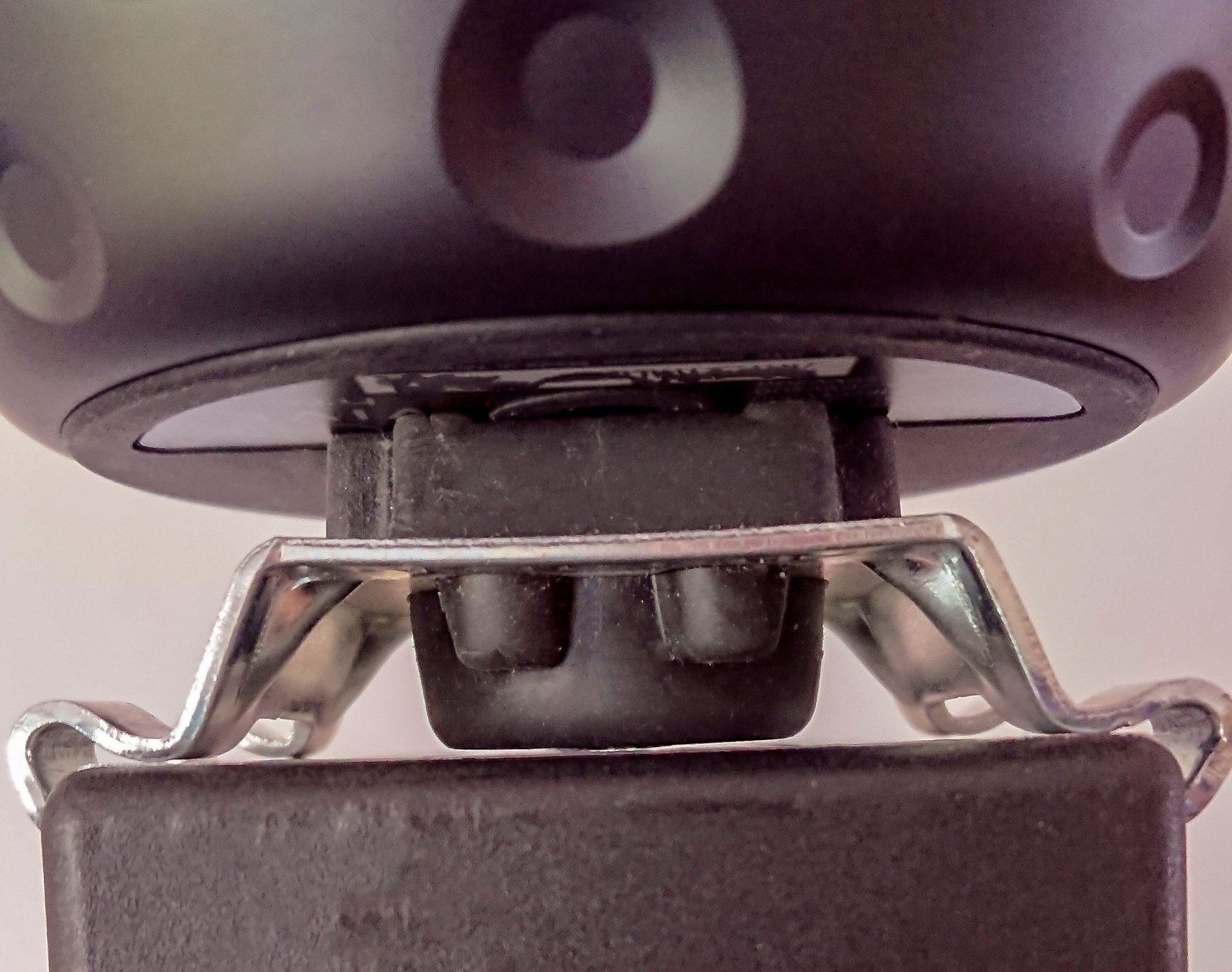

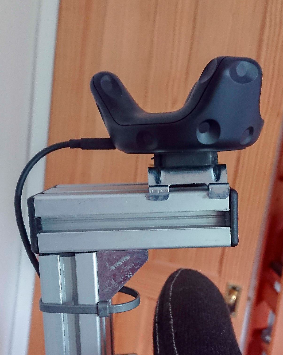

    I find that the Index with a mark 2 Tracker works very well.
    I am using a Genie Clip left over from my cinema build, which may or may not help vibrations. 64309 64310
