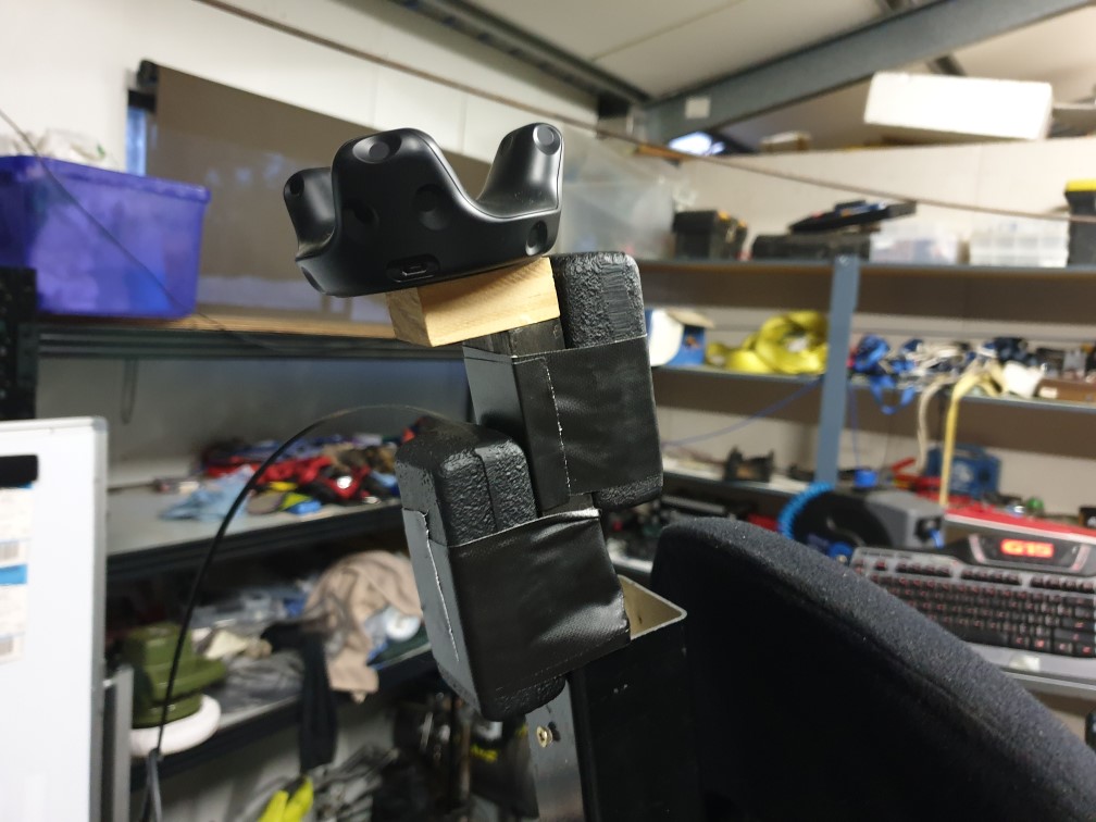

    Hi Guys,
    I think I've found it.
    I've been fiddling around the last few days trying to sort out the damn vibration issue (really, really hate that the VR experience suffers so much with vibes).
    I'd mentioned previously that I'd mounted my tracker on a stiff mounted post, rigidly attached to the upper platform structure to create a solid cantilever (tracker at the top near my head). This worked well to reduce the vibration for sim only use (a few stutters and position shifting here and there when racing, but still acceptable) but was not good enough after I added my 4 bass shakers and turned them up to full (horrible, sick feeling jitters when in VR).
    After trying literally everything (gyro mounts, gel, silicone, memory foam, styrene, pendulous dampers, etc.) I finally found something that works...
    At the top of my cantilever post (you can see the top of it extending up behind the set back) I found that adding mass absorbs the hell out of any vibration energy, even at full shaker power. In my case, I've duct taped 2x 500g (1 lb) steel weights from a weights vest I had lying around. I'm sure you can use anything you have lying around, you just need to have something to grab that energy so the tracker isn't thrown around.
    I'm pretty hesitant to add any extra weight to the rig, but in this case I think it's well worth it!
    I've only tried it for a few laps in iRacing, but it was perfect (I'd say 99% of how it is when motion tracking is disabled).
    Fingers crossed lads. It would be great to hear how other people go

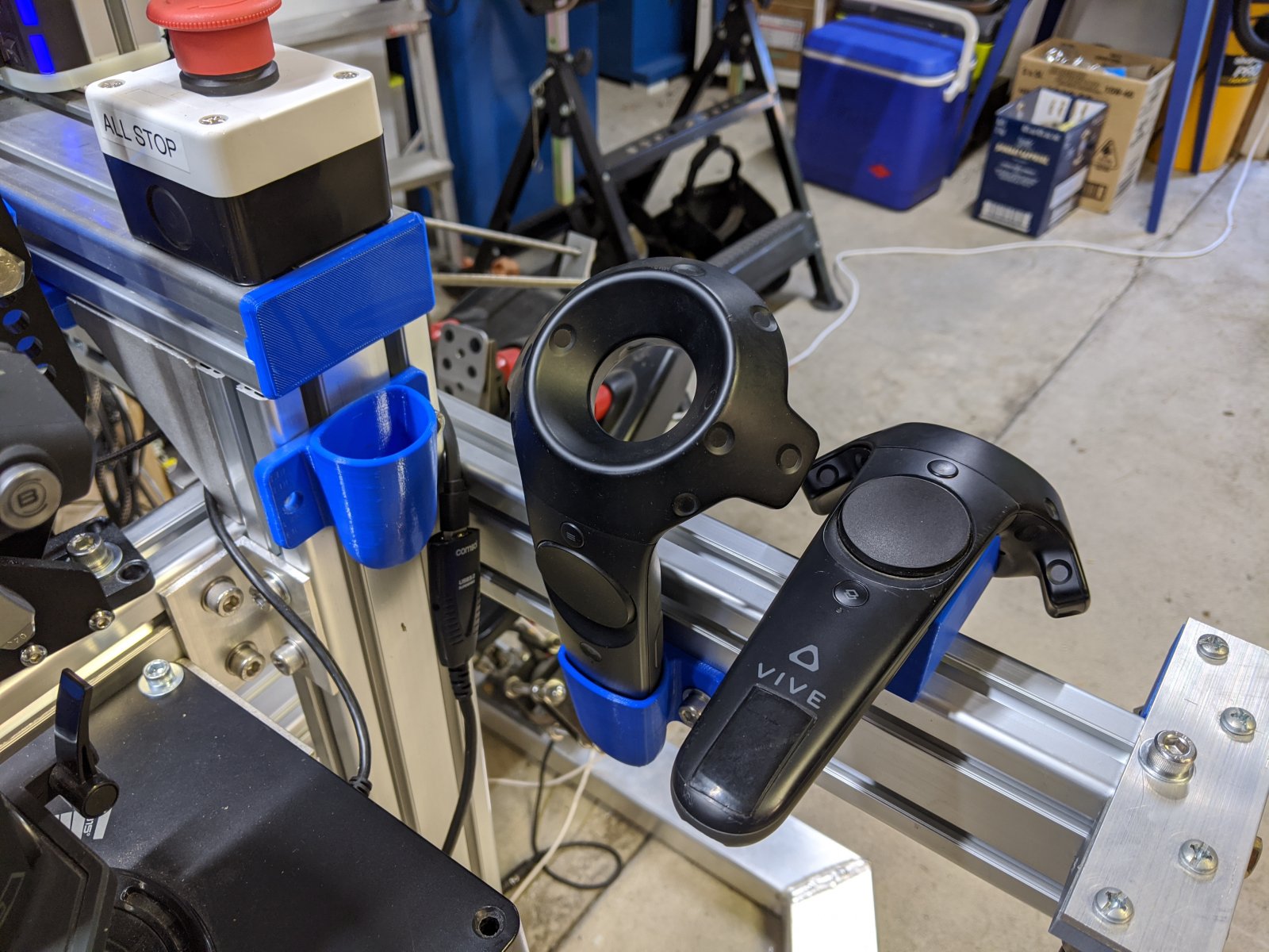

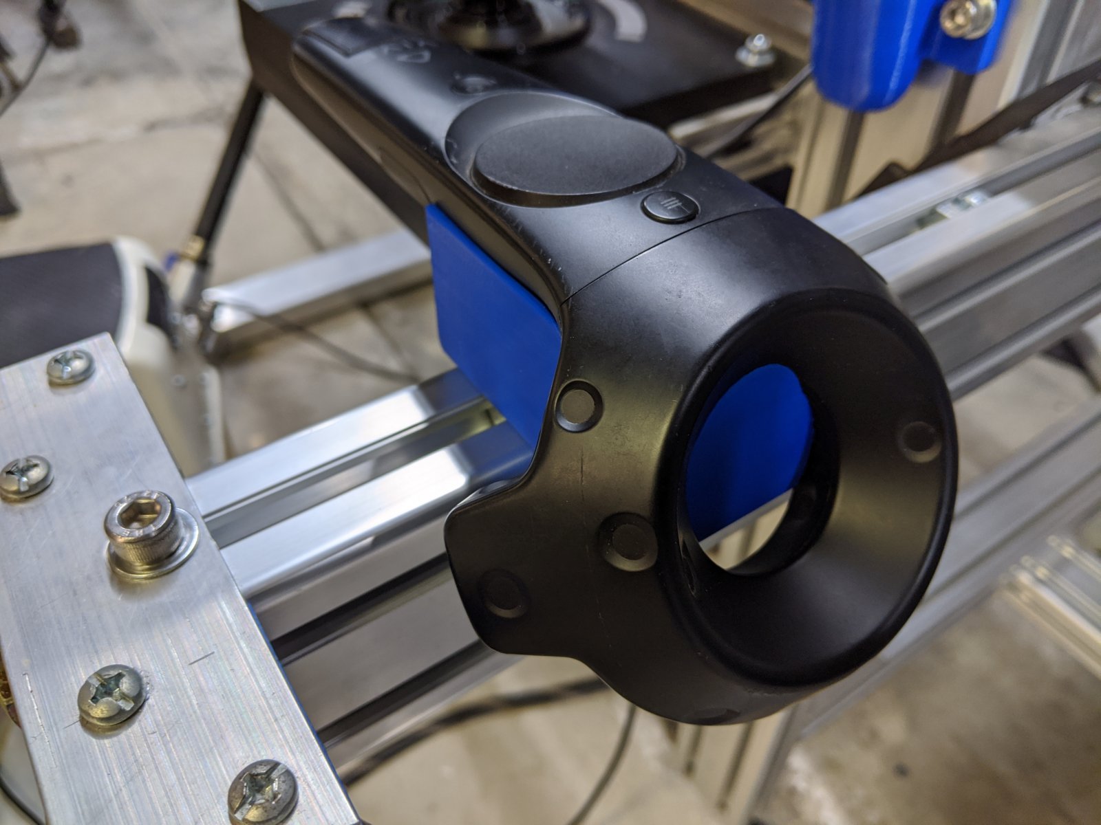

    I had my first go with motion compensation.
    Thanks to @Gabor Pittner for giving me a hint to give it another go since my earlier attempts didnt work out.
    I dont have any bass shakers at the moment and it kinda worked.

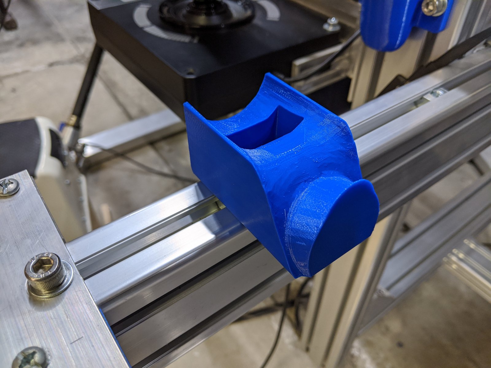

    Its needs to be mounted horizontally since we do not have much flexibility with offsets (in Advanced Settings) to correct it at the moment.
    At the moment its mounted rigidly which as expected does suffer from glitches with sudden movements and vibration.
    So I need to start re working it with some sort of vibration damping and start experimenting like you all have done.
    Thought I'd share the model files for this if someone wants to try out some variation for damping.
    I modeled it from subtracting the actual steam controller body that is given to us in the SteamVR files.
    The controller hangs on really well. Feels like its suctioned on. It doesnt need anything else to secure it down.
    So its convienent to put on and pull off at anytime which can be handy.
    Also in the model zip folder are the other two mounts you see in the pictures for mounting vertical with the doughnut facing forward or back.
    I printed these with the large opening upward with no problem.

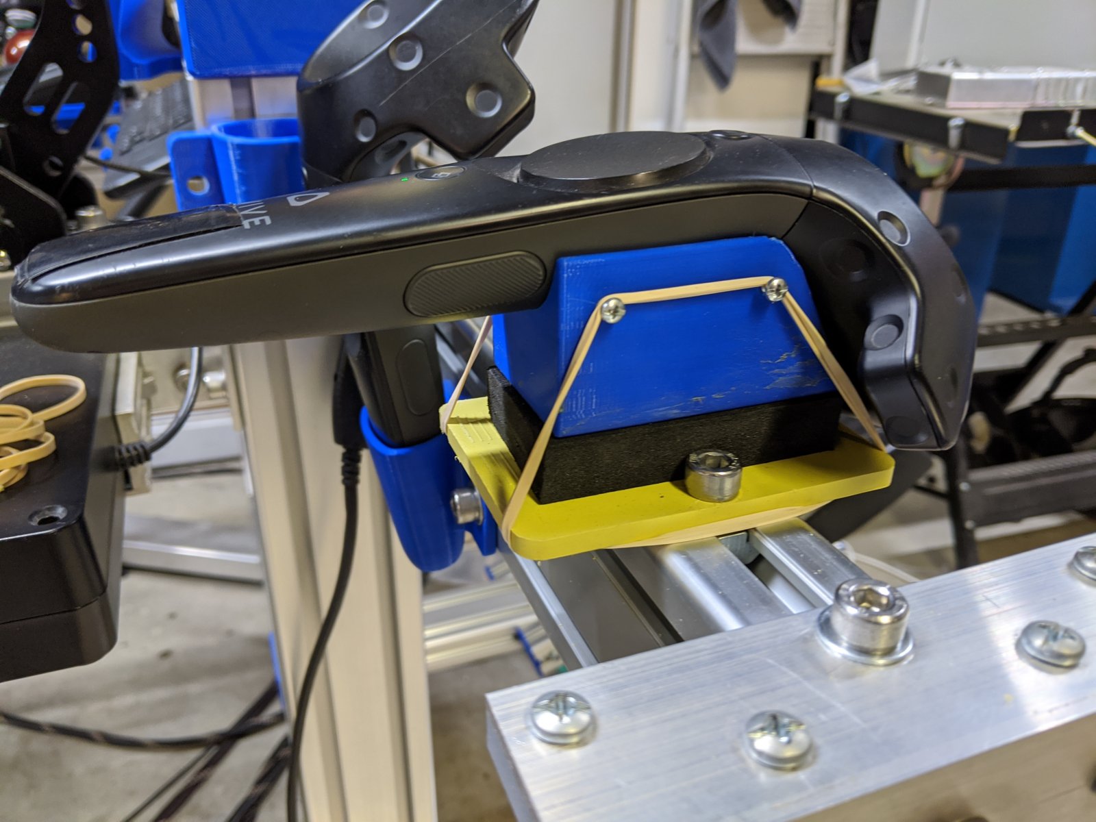

    Ive begun trials with damping the controller mount and had partial success with this arrangement below.
    The black sheet is a dense type of packaging foam.
    Its actually the packing left over from the original vive box.
    But it still vibrates a little that makes reading gauges in the flight cockpit bit difficult.
    I need to experiment more with different materials. With this setup, it should be easy to try many varietes of materials.
    Even with the vibration it is still worth using the motion compensation right now.
    Before I got this MC going, I was a bit discouraged lately as I couldnt get a good movement going in flight sims in VR.
    It seemed to me I had built a large range 6 dof rig but couldnt use it to the full extent without feeing ill.
    The feeling is fantastic when pulling back on the stick and pitching the rig back fully and not having my head swim about in the cockpit.

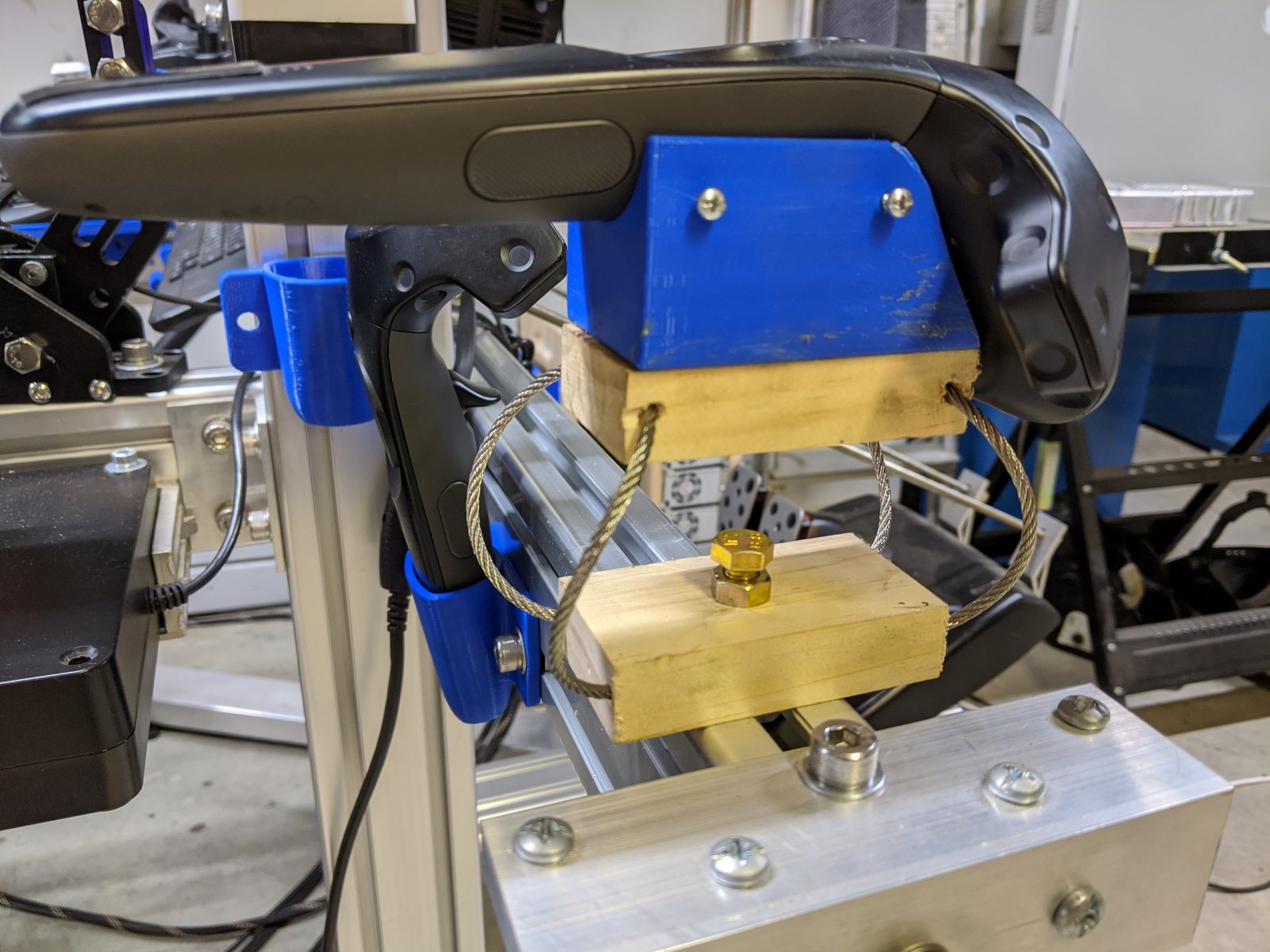

  17. JAD
    JAD Active Member
    Jan 17, 2016
    205
    Australia
    1,446Coins
    +142 / 3 / -0
    This looks promising.
    Just waiting for RC suspension dampers to arrive and fix to the 4 corners.
    This is 3mm stainless wire rope.
