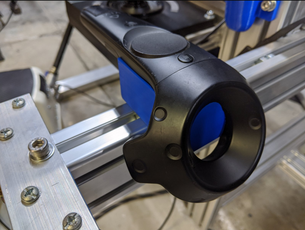

    what I did so far, using the newest pitool. enabling motion compensation results in a wrong angle of the view. Could not solve it by using a room set-up from sratch. Anyway when I was on the previous version it worked but imo not so good. OpenVR-MotionCompensation is now the best you can get atm.

    I found that mounting the controller horizontal and pointing forward like this rotates the world correctly. Only this orientation works and no need to do room setups.
    I started with normal room setup. The moment you enable motion compensation in pitool, it rotates the world to suit the orientation of the controller facing this way.
    Then you bring up the VR menu or dashboard with the system button and you can aim at the make centre button to bring you into the cockpit properly.
    Aside from vibration problem, the positioning of the motion compensationa all worked well.
    Like you said OpenVR-MotionCompensation is the way to go but I havent got around to trying that yet.

    I can only encourage you to give OVRMC a try. It's as easy as a few clicks to download and install. Open SteamVR dashboard and enable Motion Compensation via the VR-UI.
    No need for room setup or a specific controller orientation.

    As you mentioned, only this way works. In my case I have no option to mount the controller in the way you described. For better results also the controller has to be fixed on the seat (as high as possible and as close to the head as possible) to eliminate any small shaky movements. OVRMC is a good solution and easy to use.
