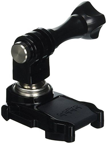

    So after four days i finally make my pimax 5k plus and vive tracker work good with motion canceletion.
    I have a problem with a tracker, i tought the problem was placement of tracker, placement of the lighthouse, etc. too far from googles, no it was not the case...
    Then not on purpose i find out in steamvr - (in mesh - calibration mode where u see all the lines and center)
    u should be able to see your lighthouse and your tracker in googles.
    For me the problem was when i chose "motion compensation" in pimax, tracker gets wrong position it goes like 180* inverted when i chose "none" tracker position was back to perfectly fine.
    Solution:
    Uninstall pitool piservice steamvr
    Unplug headset -also power, tracker and lighthouse
    Install pitool, connect headset
    Connect tracker with usb cable (i use original one and 2.0 usb extension cable straight to pc) - put tracker where u want to use it and in right orientation (cable goes up)
    Connect lighthouse
    Calibrate room with pitools
    Instal steamvr - calibrate room
    Now switch in pitool for motion cancelation and pray that tracker stays in the same (correct) possition.
    (check that with the same method steam vr mesh and look in the googles)
    Viola now it works like a champ!
    No drifting no shaking, no wrong axis motion.
    (I use gopro sticker at the back of the seat with rubber in the mounting to reduce vibration)
    Hope it helps to anyone cheers.

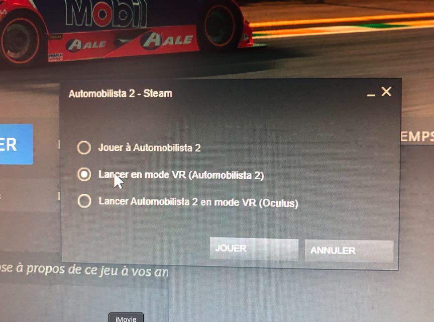

    Hi everybody ,
    I need some help about activating motion cancelation software with steam vr for some games.
    I've got a 6DOF rig , with oculus and I play only racing car games .
    My setup is my left touch fixed on my seat and I use the right touch to configure and activate motion compensation into steam vr .
    Just for information the button to open the steam vr menu to activate the overlay application is on the left touch. The right touch button go the occulus menu
    I used successfully motion cancelation software since a while and obviously also with the new software from Dschadu ( both work great ) .
    It works with assetto corsa and assetto corsa competizione .It works that means I proceed as follow .
    - start steam
    -start steam vr
    -left touch menu button to access to the menu for applying motion cancelation feature, then close
    -go to the steam vr library
    - launch the racing car game with always the second choice ( launching game in vr mode )
    During this process I 've got my oculus and I'm in steam vr environment ( the landscape with mountain around and my 2 trackers ) . I watch into my oculus a small window indicating that game is launching .
    To have the motion compensation working during launching game I stay always into steam vr and then access into the game .
    It works for assetto corsa competition and pcars1 like this .
    For the games which the motion compensation is not activated ( even thought I applied it) , during the launching process I 've got the small windows into my oculus into steam vr like the other games but during the process I go through oculus application ( it's like I pressed the menu button on my right touch) , and then access into the game .
    in this case the motion cancelation software ( overlay application ) is no more activated .
    I read a lot of things with launching options (like -othervr etc ... ) , but until now nothing works !!
    The only thing I noticed is that motion cancelation is not activated with pcars 2 , Automobilsta2 ( which uses some of software common to pcars ) and pcars 1 works.
    Pcars 1 has for the second choice launching in vr mode with htc vive
    And the two others the second choice is the normal launching in vr mode via steam vr . look at the pics attached .
    It's very frustating because those games aren't usable with my sim rig and I recently bought automobilista 2 and I can't use it !!
    If someone could help me thanks !!

    Just to clarify, if you launch the likes of pcars 2 and Automobilsta2 from Steam, then select SteamVR as the launch option, are you saying OpenVR motion cancellation does not work? I suspect launching from Oculus is the issue, as SteamVR is required for motion cancellation, direct Oculus SDK will not work.

    For all other sim rig movements surge sway roll pitch heave never noticed black edges up or down ( just left / right in extrem yaw ).
    With small yaw movements no black edges.
    I start using motion compensation with revive feature because oculus wasn’t compatible and with this process i could use all games successfully ! I forgot to mention that at the beginning pcars2 was working with motion compensation, but since 2 years not ! I suppose something in steamvr releases or lainching option on VR into steam . It’s the reason why i mentioned that pcars1 which is launched with htc vr mode into steam is always working. There is problably something to deal with the launching process into steam which is different . I’ve got no skills to go forward and investigate ( the reason of my post )
    I can just give information and analyzes about what happens.
    But always same notices :
    - why some games are working well and other not with oculus motion compensation and othe not ?
    - why with the new motion compensation overlay made by Dschadu I have exactly the same problem with games compatible as the old motion compensation feature with revive !
    - why pcars1 still working and remember launched with htc vive option into steam ?
    Like Noorbeast said some games enventhough you launched them trough steam with steam vr activated and motion compensation , during the launching process you go trough oculus software ( i saw this clearly in my headrest ) and after no compensation activated but the VR is fully functional and works perfectly !
    When I stop the game i notice this because i have to push on my right touch the oculus menu button .
    Remember pushing this button on right touch allows you to go to the oculus software .
    @noorbeast : I replied to you above
    Thanks guy’s for helping me
