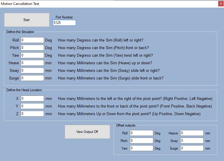

  18. yobuddy
    51,754Coins
    +5,206 / 19 / -0
    For sure!
    A really good reason to have these as addons, is we can try different things fairly easily.
    Once we have a motion cancellation plugin working, we can probably re-use most of the motion cancellation addon for many different hardware or software solutions with slight changes.
    Above is a test app for a virtual tracker, where SimTools directly controls the offsets.
    You simply put in the parameters from your sim.
    So say your sim can roll a total of 20 deg left and right, once the app knows this range, it can translate the motion inputs to a offset for the virtual tracker.
    Or that's the idea anyway, really not sure how it will match what the sim is doing at the time.
    But with a fast enough sim, it should work fairly well, and it can't drift at all.
    Smoothing and delay could be added also should it be needed.
  19. yobuddy
    51,754Coins
    +5,206 / 19 / -0
    As the chair pitches back to simulate surge, so does your head, and in the game your now looking at the ceiling in the car. lol
    So the app makes a virtual tracker that essentially eliminates the pitch (caused by surge) from the headset.
