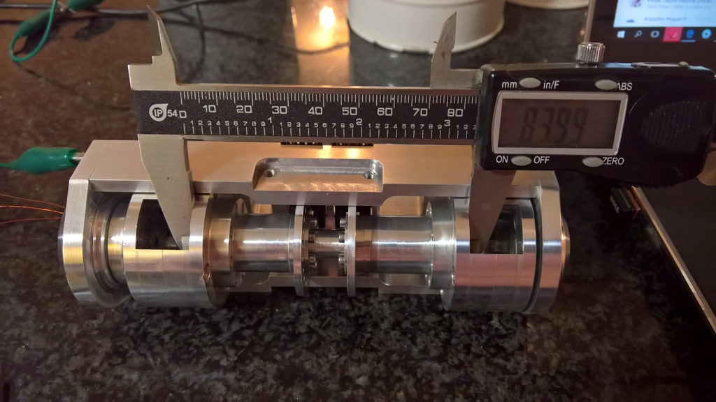

    If everyone tested at 2m or 4m you'll find different results from each user in any case due to manufacturing tolerances. Unfortunately valve's system isn't open or described in detail, I've thought about ways of trying to reduce the error but they might have already implemented these...
    I'm playing around with the idea of using a single beacon with 4 lasers(hard drive motor that I stripped, spins over 10Krpm but noisy beyond 6000rpm), I think 2mm would be well acceptable. I have mounting holes underneath to bolt it down on a rig but it's expensive to have the FPGA TDC dev work done, so might have to wait a bit.
    But since there is an Opentrack driver out for SteamVR I'm going to try that in the next couple of weeks and see if it's successful... if so I'll do a dedicated helmet.
