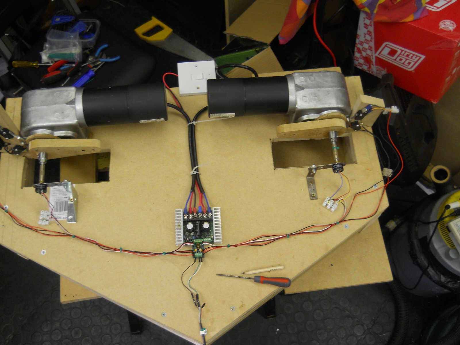

    It looks like a single limit switch should work, he has the cam of the lever set so it would touch the limit switch from either side if it rotates too far. Nice touch.
  2. SeatTime
    2,572
    I didn't say it wouldn't work for a simple limit, but the circuit would not know what direction limit it was and therefore could only just cut the power and not reverse the motor (if that is what he wanted). Most actuators that I have seen have a limit switches at each end and diodes to reverse the direction of the motor.
  3. Historiker
    2,161
    9,208Coins
    +2,168 / 19 / -1
    Ah, that makes sense. Didn't mean for you to think that I was arguing :)
  4. SeatTime
    2,572
    Historiker, never thought you were arguing:), just trying to save Wantabeaflyers some time from my own experiences.
  5. wannabeaflyer
    wannabeaflyer Active Member
    Jul 31, 2008
    248
    UK - London area
    973Coins
    +34 / 0 / -0
    Hi SeatTime thanks for the input . my 1st setup was exactly what you mentioned , but had a brainwave ( or should that be brain meltdown :) ) and thought the cam only operates the limit switch at the upper lower max travel positions ( defualt connection being Normally Closed contacts) so the thought was the one switch could do the same as 2 ( but thats why i asked if anyone else has been down this road) the arrangment still allows me to use 2 switches if required , so further testing today will show if its a workable safeguard.. Thanks SeatTime as i welcome any input :)

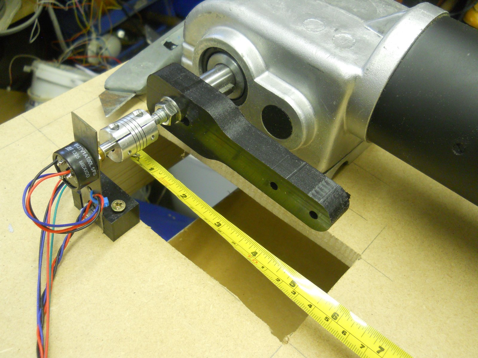

    Il sistema con un solo swict per motore io lo ho provato sul 2 dof per proteggeeri pot ed ha funzionato perfettamente.
    Puoi anche limare un po' di più e far lavorare la staffa per 200-220 gradi prima di fare aprire il circuito cosi eviti delle aperture accidentali se userai tutti i 180 gradi disponibili.

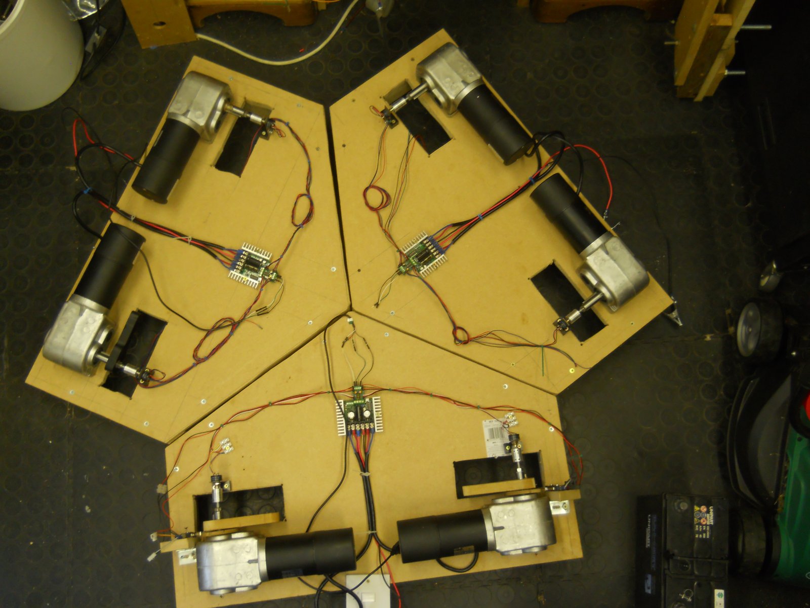

    Hi Guys Back again should of check the photos before hitting the Post Button D'ohhh
  11. wannabeaflyer2
    Jun 12, 2015
    724
    london uk
    8,345Coins
    +958 / 7 / -0
  12. wannabeaflyer2
    Jun 12, 2015
    724
    london uk
    8,345Coins
    +958 / 7 / -0

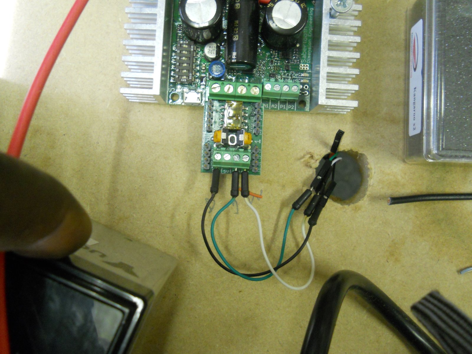

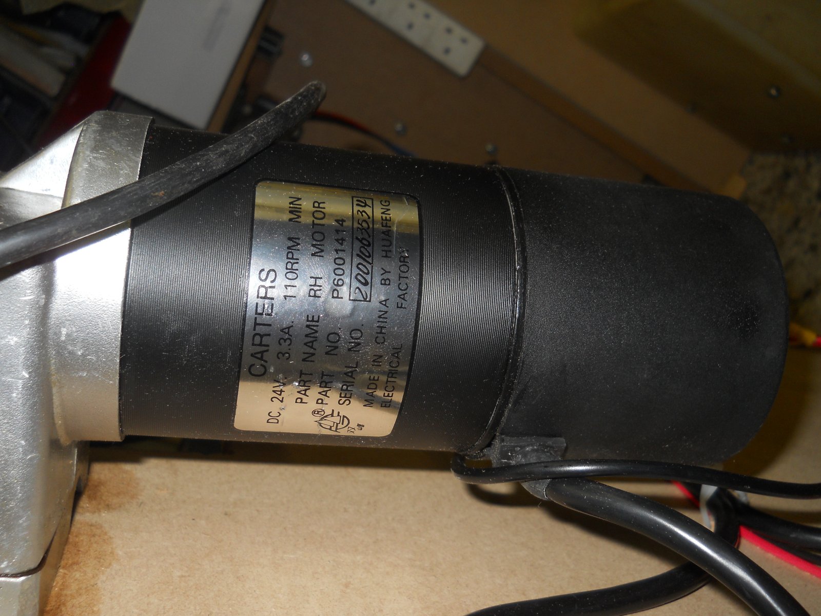

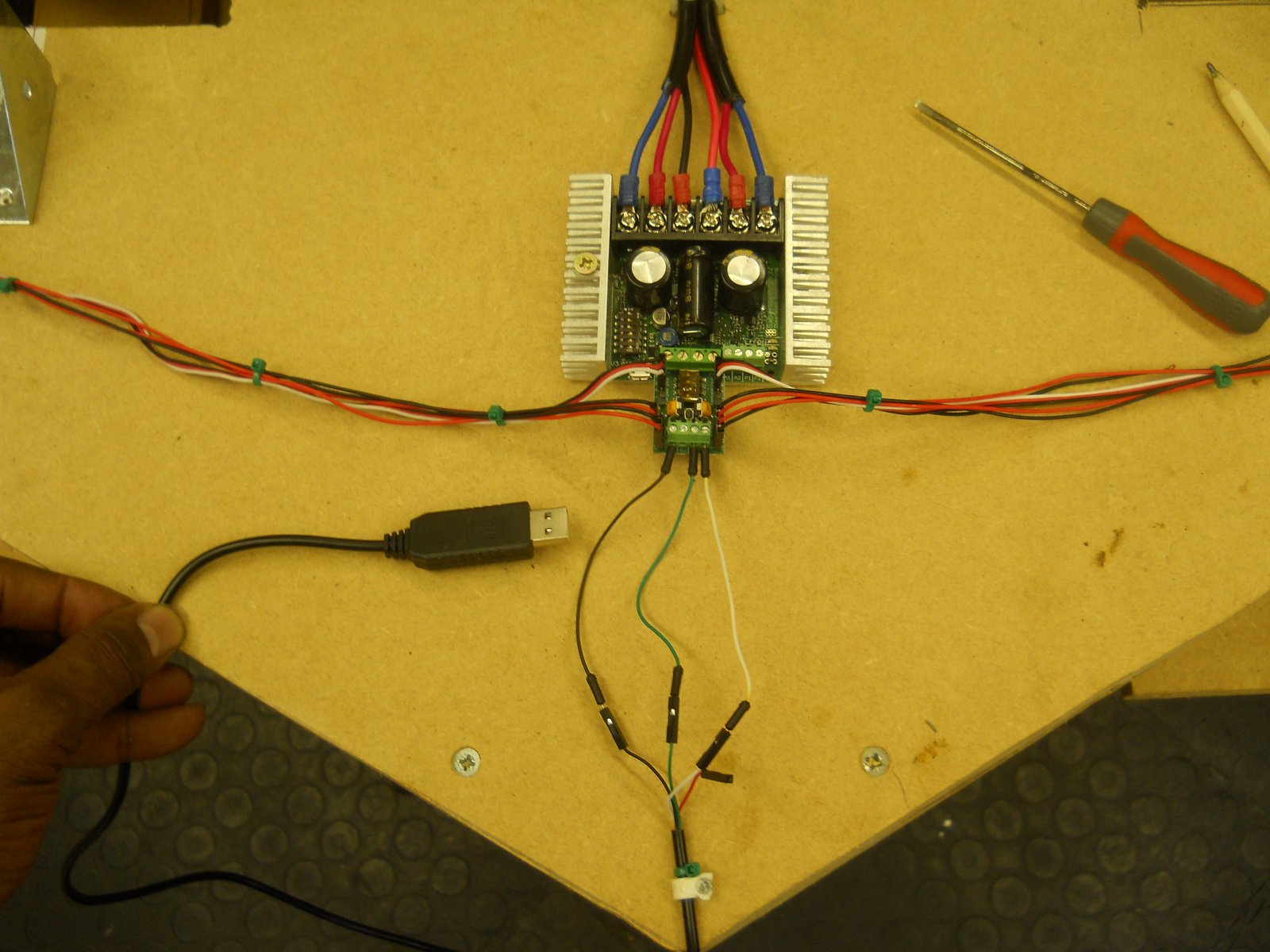

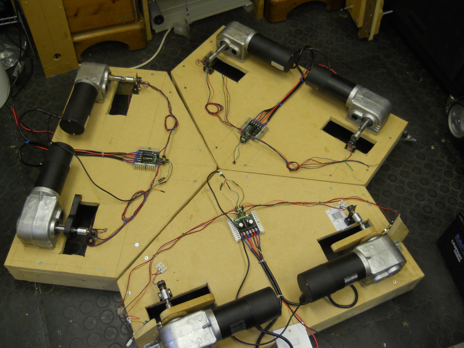

    At the moment the setup is just to learn how to talk to the Controller Via X-simulator and Ians BFF software . The Levers , Rods And Top Frame Need to be Made as well , so ignore the Plastic & Wooden Actuator Arms in the Pictures , They are just there to check working clearances etc and If the system goes Loopy then they will break before doing harm to the Motor/ Gearboxes ... so in a nutshell ( Small Nuts like this Wannabe LOL) Its 6 Electric Wheel chair drive units ( all same Spec 110 Rpm, 3 Amp Motor least that's whats on the Nameplate) , 3 x Sabertooth Motor controllers , 3 Kangeroo Interfaces, 3 x 30Amp PSU's with Car batteries for Regenerative load Protection, ( will be changed for Server PSUs) , 6 x 180° Rotation Hall Sensor Pots,, X - Simulator Software for testing ref Other 2 DOF Car Race Sim ( for my Boy ..well That's My excuse anyways ) and Ians BFF Software which will be the main Software on the 6DOF Test Unit and off one Car racing sim and my MS FSX, Not looking for all out cockpit type of sim , im realalistic enough to know Santas gonna have to be real nice to me to get the full dream or some numbers on the Lottery LOL ( what was that about being realistic ? ) DSCN2553.JPG

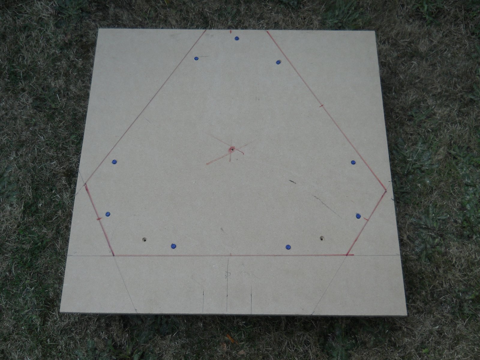

    Back again , a lot of this project will be about finding out what works and what is not practical, so as I mentioned I still have to , learn how to calculate the Motor Torque etc Max Power unloaded and then with my 95 Kilo butt precariously perched on the Top Platform to see if the dam thing moves LOL... If I achieve this then a lot of possibilities become attainable .. oh oh and if haven't said so already , "Thanks to ALL you guys here" for even getting me this far, this forum ozzzes inspiration Cheers Crew

    1,490Coins
    +260 / 5 / -0
    2DOF, 6DOF
    Hello wannabeaflyer.
    With the engine cranks 10cm can it much. I used the wipers 3.5cm. With 5cm was not very accurate.
    Your engines are much more powerful but the reduction is less (110rpm).
    I wish you well, I will be attentive to your project.
    Luck !.

    Opps again for got to say that once the initial power up and communication with Simtools and Ians BFF 6 Dof software is done , and some basic load and speed testing is completed then each module will be rebuilt more robustly and wiring will be Routed under each module , Control cards will have fans & ventilation and enclosed to protect them LOL ... watch this space ,,, The Mk 1 Version wont be pretty guys but should determine if this approach "has legs" as they say

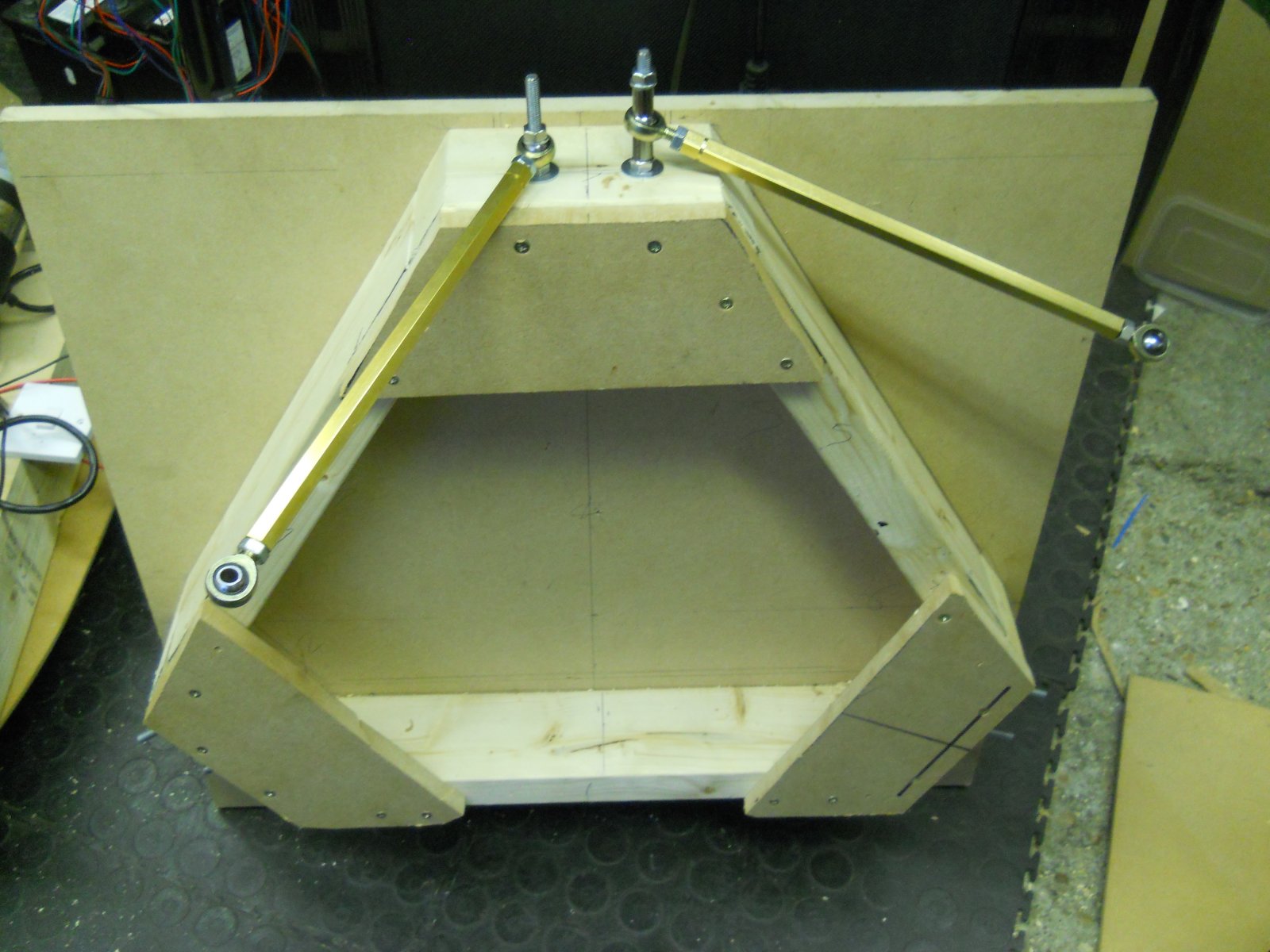

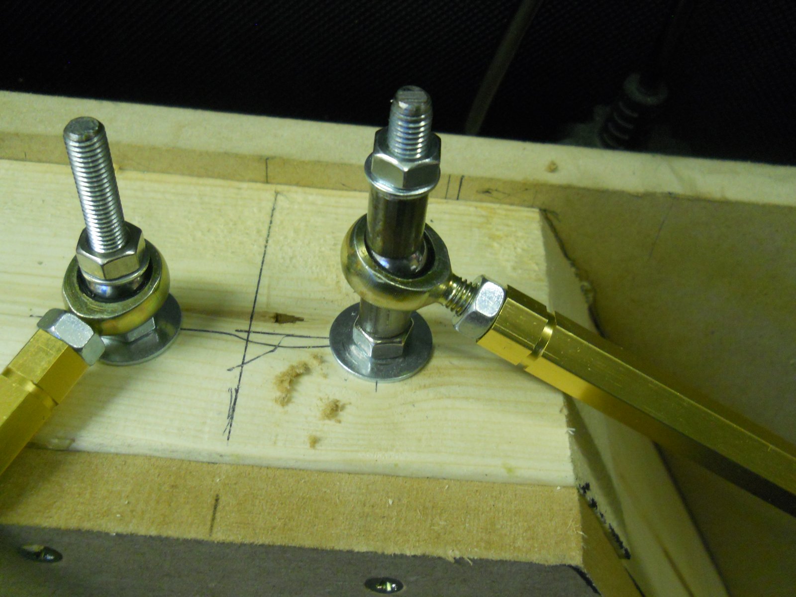

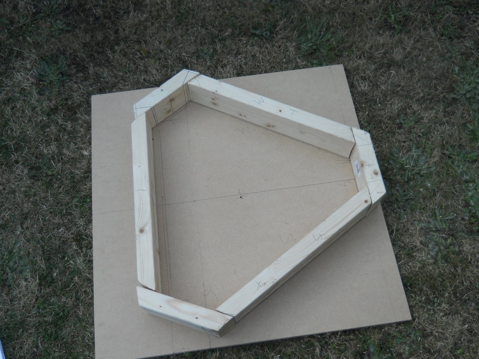

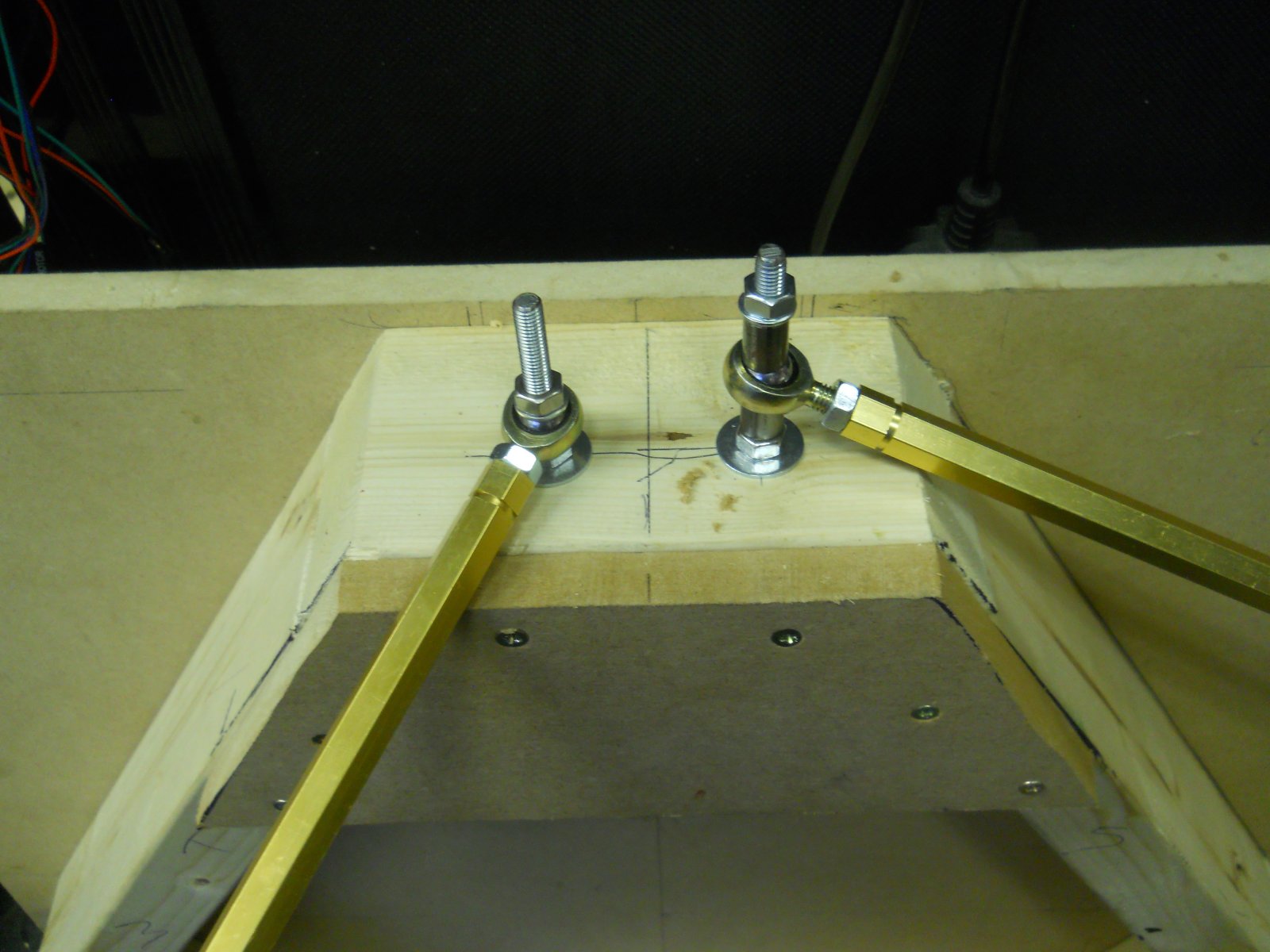

    hi guys minor update , Just finished the top Platfoem of my 6DOF project and will be making the Spacers for The Rose Joints (to increase the working angles) tomorrow, IT is already apparent that i will have to Go for 10-12 mm Joints , but as i mentioned this is the suck it and see phase so that will be filed under lessons learnt , Hoping to Connect PC to Actual Platform today and without the Blue smoke syndrome and burning electronics smell.. fingers crossed guys as im still cutting Limit switch Cams on my CNC machine today as well ( getting excited and Nervous as well ) ... Shout out to Silent Chill, i may have missed it but could you say what size rose joints you used for your project ...sorry if its listed I'm in a sortta "Cant see the woods for the trees" at moment info overload DSCN2602.JPG DSCN2595.JPG DSCN2598.JPG DSCN2601.JPG DSCN2593.JPG DSCN2602.JPG DSCN2595.JPG DSCN2598.JPG DSCN2601.JPG DSCN2593.JPG
