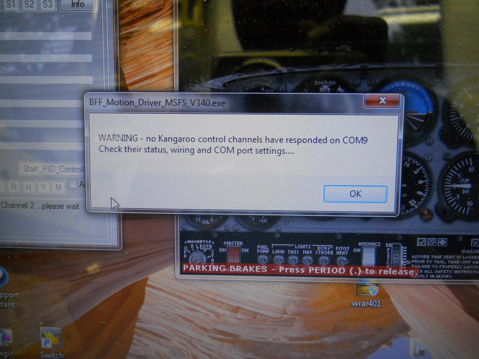

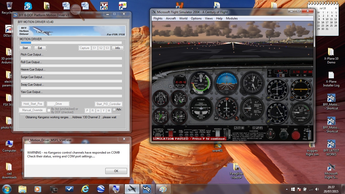

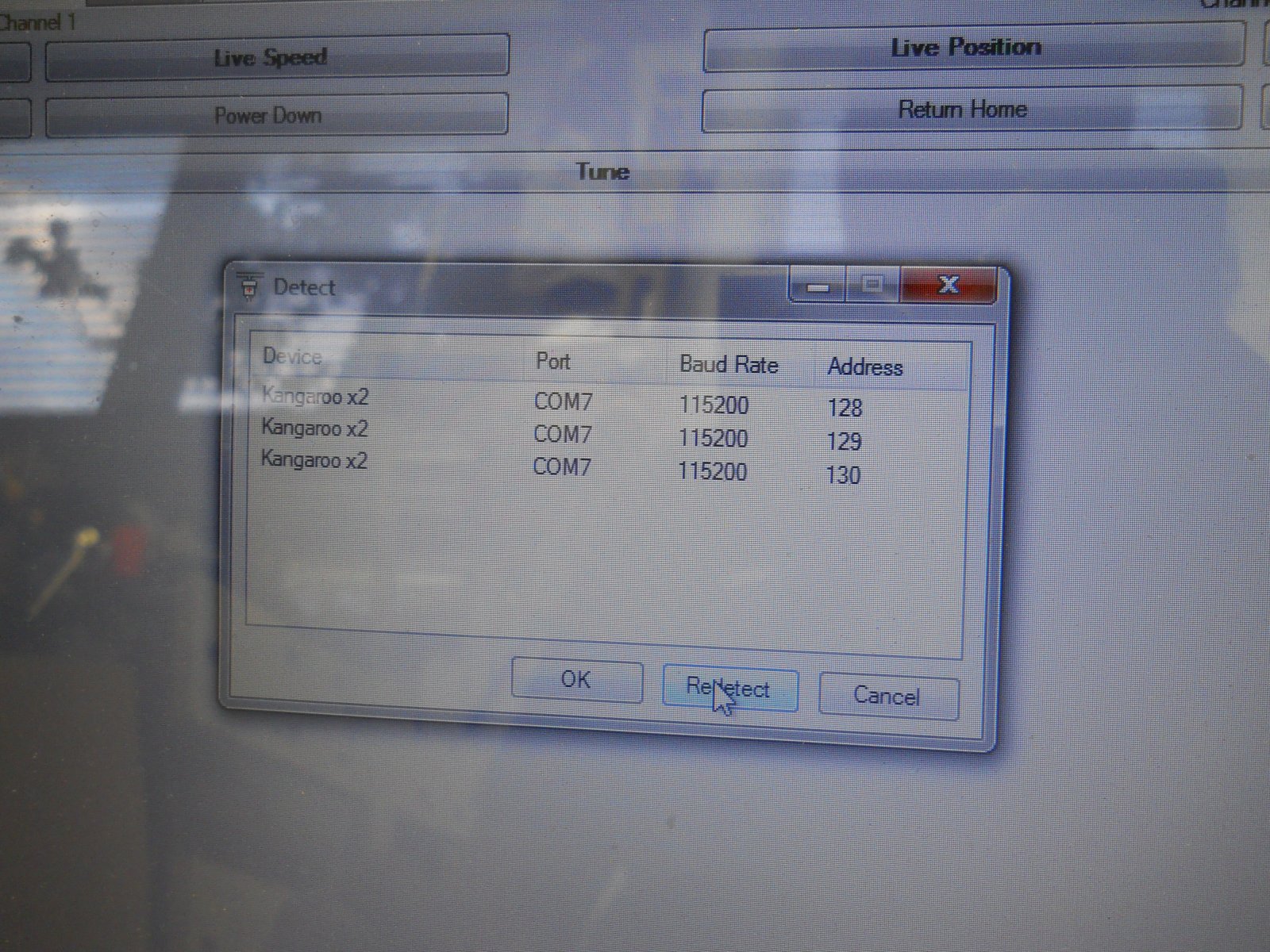

    one step forward 2 backwards i love the dimension engineering controllers but the Kangeroo setup is proving to be Major Pain in the ( insert Correct term here) .. Hoped to have gotten further with this but have had to Contend with what i'm now sure is a dodgy USB to TTL converter (should of spent more £4.00 each ) .hmmmmmmm.m
    its not a major issue but Bloody annoying , can any member recommend a reliable USB - TTL converter that does not Flag up "cannot connect to Com port X " every now and then , im sure this is why im having so much grief with Auto tune.
    latest situation is , i have all the modules Connected on my baseplate , With all 3 Controller linked using a shared S1 line on the kangaroo card i can use describe see all 3 controller displayed in the Detect screen ,which is great to confirm the operation of each Channel / Motor linked to the card address . good news 1.
    i can activate the Controllers Via FSX and Ian's BFF software , so least ways i have comms through the program and data seems to be going to the right Card/ Actuator Combinations Good News 2 :)
    the problem is too often the com port just drops out and i loose communication, so have to start the software process several times just to hopefully get the com port to be recognised ,,,,,,Bad News = Pain in the brain time .. this mainly happens in describe whilst trying to Upload any changes to the Kangeroo, or When trying to get Ians BFF software to get past the Com Port checking routine (if that fails the software closes and you need to start all over again ....Did i mention that's a Pain :)
    will be finishing my Metal actuator arms in the next day so would have liked to have sorted the Kangeroo Autotune process before they are fitted ..
    So have ordered some other USB - TTl Converters and may well even buy one from Dimension engineering if it gets me moving on this project . (Turns out it may have been false economy for e=bay specials But wanted to test the unit last week and they delivered next day )...
    General shout out for info then guys , have seen a few post here regarding the Kangeroo setup but need some advice regarding the Values i should be looking out for to confirm a good or bad Autotune ...
    have seen a few times the message "Control Error, suspected Runaway condition detected" press Om to restart Blah Blah and im guessing this has to do with the Sensor setting range, so am using a DVM to make sure i stop short of the min/max values of the 180° Hall sensor.. as i have noticed that if you go past 4.15Vdc or less than 0.2Vdc then she plays nasty when in live mode either that or The Control Error Message appears ..
    Me thinks a day off work to play in the man cave will be required , fingers crossed the new USB -TTl converter performs better.. Cheers Guys..

    have you thought of raising a ticket with DE, and attach your last few posts as an example of the problems your are having,
    just to see what they have to say
    regards Terry

    Hi @telfel , I was going to wait till I tried my new USB-TTL adapters before bugging Charlene at dimension engineering again LOL :) most of the time the problems have been due to me missing something or not understanding the User gu ide info,
    So to save embarrassment :), this time i'll check out that avenue first , I do think this Kit will be the standard before long, as once they beef up the Describe & kangeroo user guides, im thinking their products ease the path towards motion simulation projects , once its all sorted its a good way to get into motion simulation Cost More than some other options but Robust and forgiving so not bad bang for Bucks Modules ... Watch this space guys , Once the head scratching is over im looking forward to powering the full platform up ( with the Biggest E-Stop switch Possible LOL yeah Yeah I know ye of little faith :)

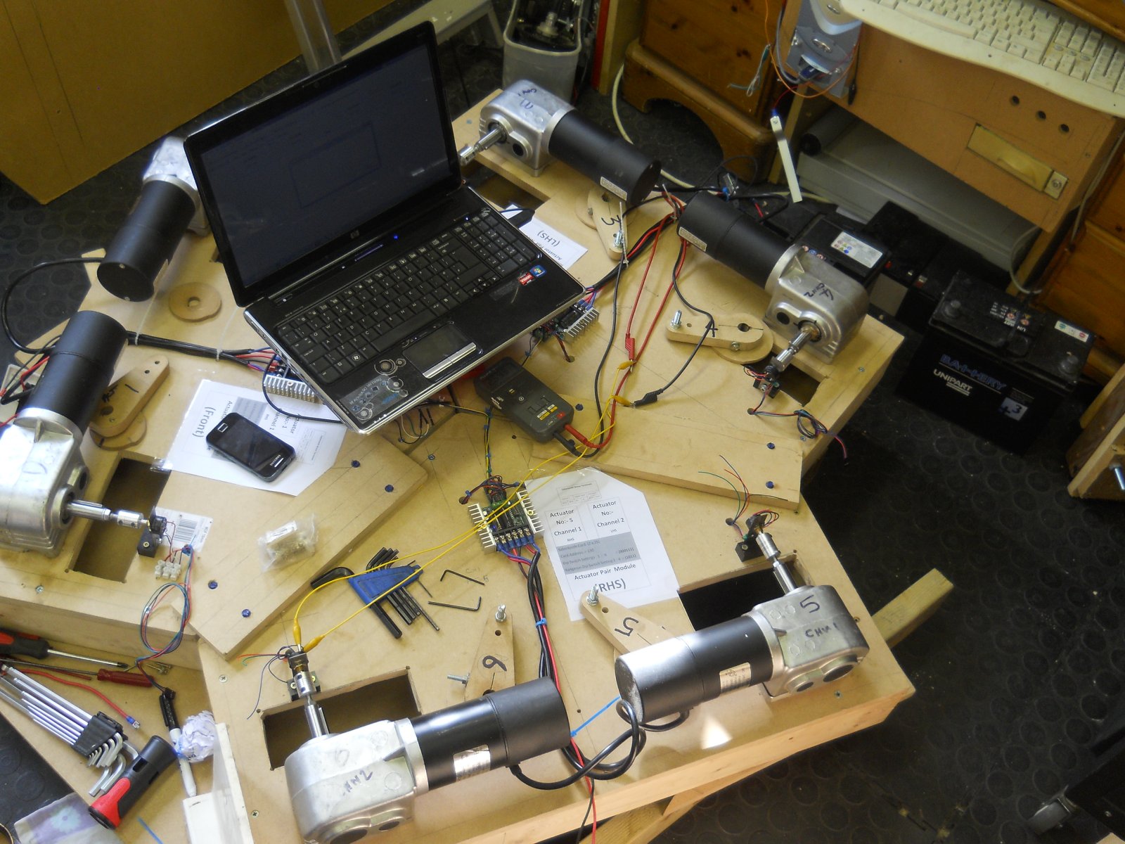

    Annoying but no pain No Gain.... bit of a mess but just need to get hings working then i'll back track and tidy up wiring :)

    Hi guys still battling away with my issue , hoping Ian will be able to set me straight when he's back off Hoiliday, i thought id use this break to draw up my wiring diagram so that you guys could give it the once over.
    Just in case like i mentioned its a case of not seeing the woods for the trees Thing , this is my take on Ians Guide to setting up the Electrics, so i've just laid his work out in my so called newbie style , credit where its due i only relaid it out to suit me( lunchtime project LOL :)

    Hi @wannabeaflyer2, I go by BlazinH and I authored the interface to control one kangaroo directly from simtools. I did this not because I needed to use kangaroos myself, but because I had high expectations from them due to the fact I achieved very satisfying results using sabertooth 2x60’s with my own motor control software.
    However, now after more than a year of seeing people attempt to use kangaroos, and after experimenting with them myself and attempting to get an auto-tune to even complete on my rig, my findings have been they are pure crap for simulators. Really sorry to have to say that but so far it has not been proven to me to be otherwise. I don’t wish to discourage you, but only to warn you that nobody else has been able to achieve good motion with them as of yet (that I have seen anyway). The attempts I’ve seen from people using kangaroos for flight simulators show jerky, poor motion. The kangaroos were designed more for industrial motor control and battle type robots. DE swears they should work well for simulators too but again, have yet to see it actually happen.
    My advice is to go ahead and call (bug) Charlene at DE as much as is required. I’ve wasted hours of time myself going by what their documentation said when it was completely wrong or incomplete! And she is the one that said they should work for simulators! If people with simulators keep calling her with their problems maybe she will eventually figure out the kangaroo does not play well with them after all and quit saying it should!
    Ps. No need to pay the ridiculous price DE is asking for a simple TTL converter though. FTDI or CP2102 have been proven to work just as well if not better.
    And just FYI, Charlene and DE doesn’t know everything so some of it may still be up to you to figure out for yourself. For example, they couldn’t tell me how to control a kangaroo from a computer and I had to figure it out myself from this, “Note: \r\n is not visible in a terminal program, but must be included when using a function such as scanf to designate the end of the message”.

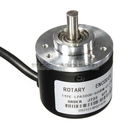

    Looks like he used quadrature encoders @SeatTime, that’s how. Thanks for pointing that out. I should have stated I was referring to using analog feedback with the kangaroos is what sucks, especially hall pots, at least from my tests, and that is what wannabeaflyer2 said he is using.
    I’m not saying it’s impossible, but is damned hard to get a good auto tune using analog devices as feedback on the kangaroo. And even though you can manually tweak the settings, the values used are not standard pid values so good luck with that.
    With sketches already available here on this site for sabertooths, one really doesn’t need to use the kangaroo now anyway since it has proven itself to be a real PITA! And there are plenty of people here who are more than happy to help people out with those sketches if need and with information how to adjust their pid settings.
    Ps I was able to get an auto tune completed on a test bed using the full range of a standard 360 pot. But when I tried a 90-degree hall pot, it would go out of range to quickly to complete an auto tune.

    These are the Encoders which i will fit 2 : 1 gear ratio 6MM 600P/R Photoelectric Rotary Encoder Incremental DC 5-24V AB Two Phases . at £8.00 each they have to be worth a shot if they can help to get round the issues I may be having trying to use my 180° Hall sensors .. Nothing wasted in this game we just store them till a suitable project comes along LOL... To Close now to give up :)
