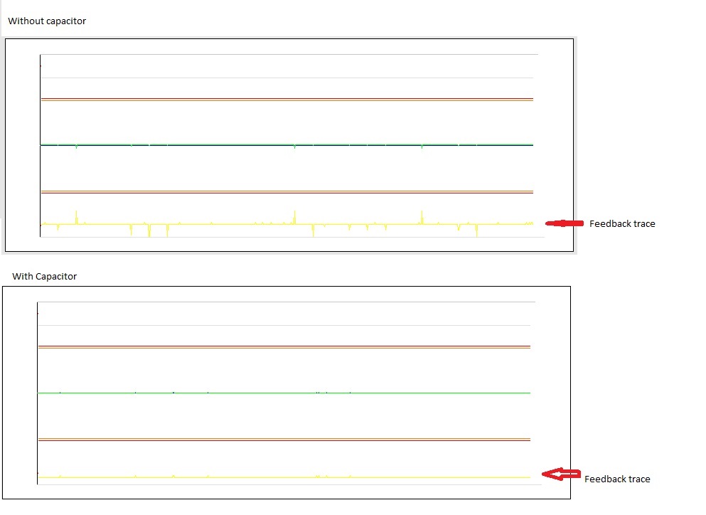

    For the people who like pictures in regard to using capacitors for feedback signal filtering. This is with everything wired up and running with 24VDC power supplied to the motor.
    Note: I'm still using ribbon and not screen cable for my feedback line. Will change over to screen cable when the actuator is installed in the rig.

    Hi Seatime mega thanks for this info, yep im one o those pictures speaks a thousand word guys , so it was great to see this visulisation of the noise picked up by the sensor , gonna try to have a go at the 2DOF electronic setup today using pots , while I wait to see if Ian at BFF simulation can offer any advice as well, sent a ticket to the dimension engineering guys so fingers crossed between them and you guys here I'll get this solved. Cheers Seatime

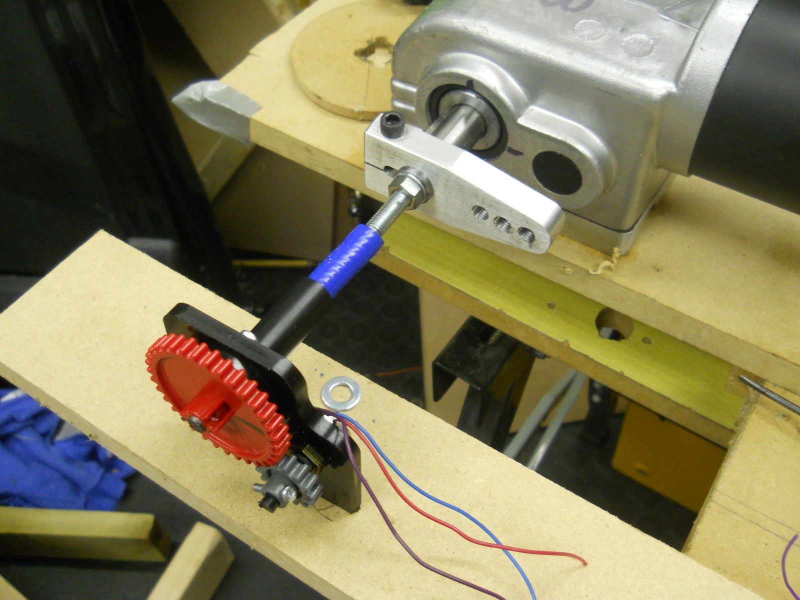

    In the meantime i Built up a a test setup for my Boys 2DOF Sim Just need to Connect the Pots to the Actuator Shaft ( using Gears to get better resolution from the 10 Turn 10K Pots i'm using for testing) .. Still waiting for the encoders , so once again guys sincere thanks for all the patience and tips ( they may rattle around in the old grey matter) but every now and then a EUREKA moment occurs and all is well LOL :)

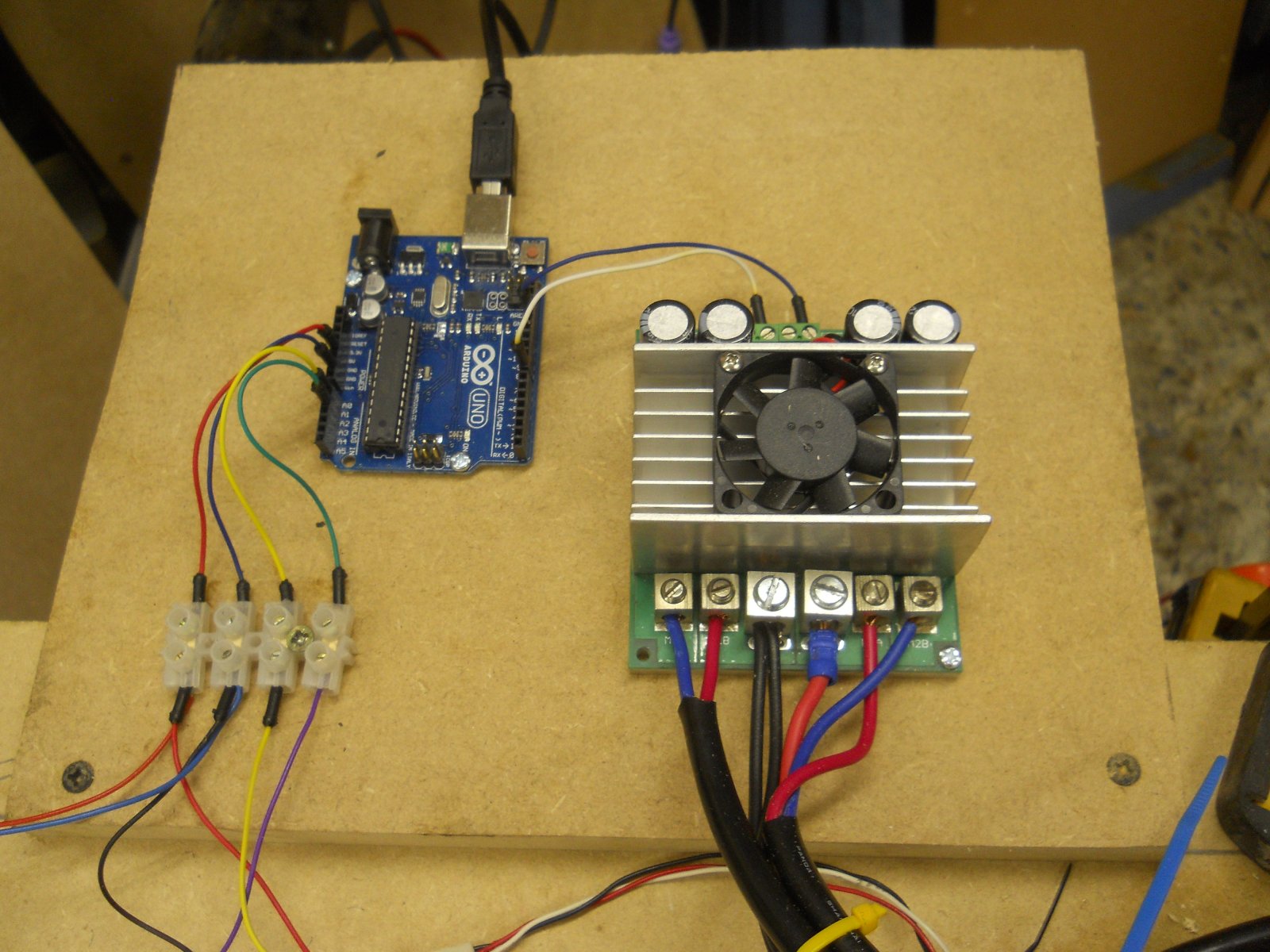

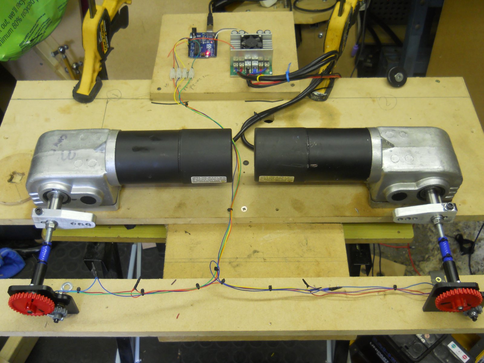

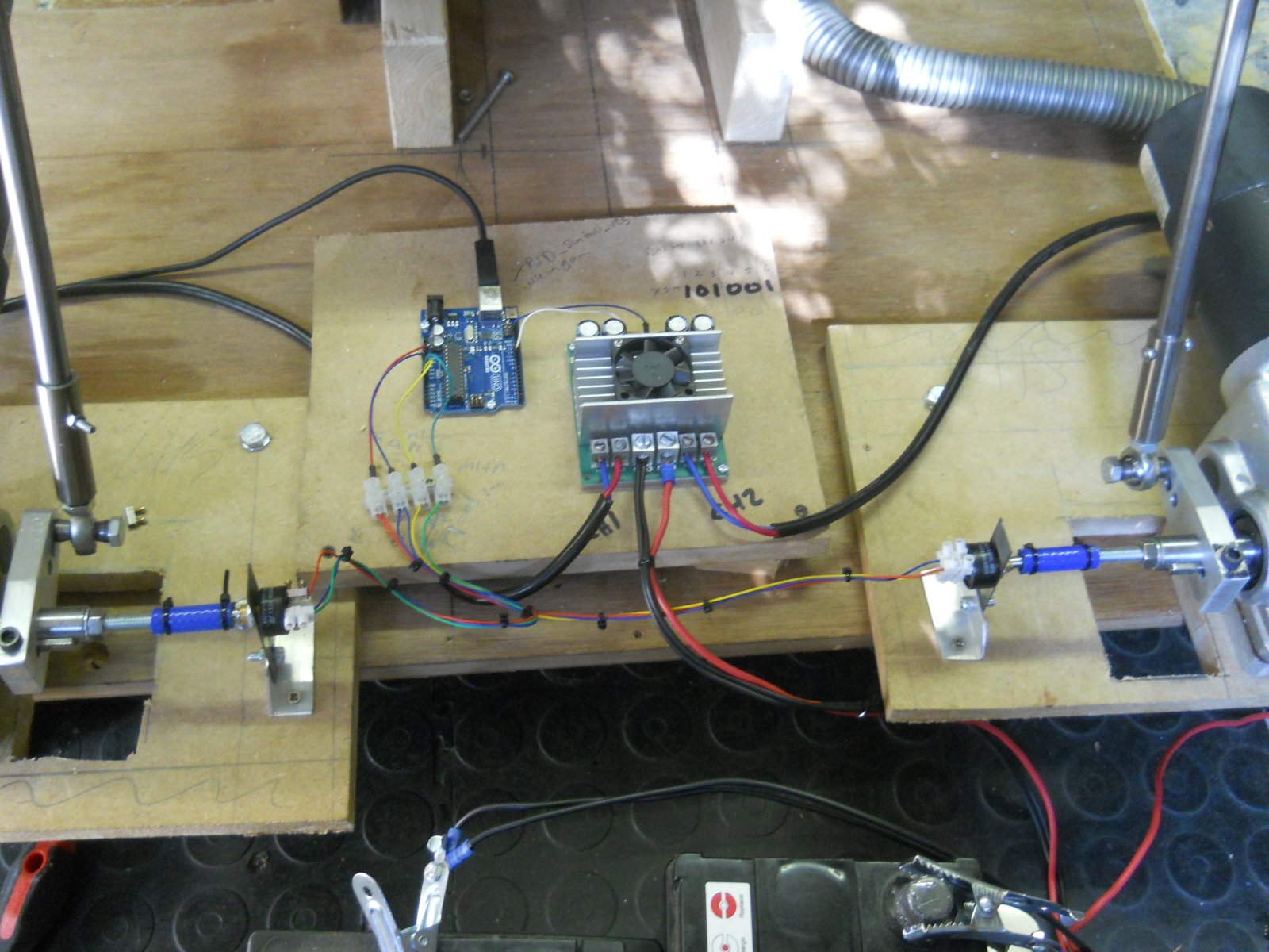

    Just a few rough and ready shots of this evening efforts , This lash up ( Arduino Uno / Sabertooth 2x60 / Wanegain or Racing mats Software ) is just so i can play with Simtools and try to get familiar with its operation and hopefully communicate with it and the Motors ...this weekend will be Blitz the 2DOF Platform ( Getting an ear Bashing from my boy (not an easy thing for a deaf Bloke to complain about LOL :) ) but having told him my plans he's expecting great things LOL ( me thinks i should of kept quiet :) Software loaded and OK on the Ardunio & Temp wiring looks sound so Simtools , Here i come .. (more reading at bed time)

    Hi Guys just a small progress update and big thank you to @BlazinH for the tip regarding kangeroo autotune process , and as i mentioned before it would turn out to be a pronl;em of my own making , Well it seem like i got got a kind of loop over the whole tuning process in so far as every time i did an autotune i was overwritting the information in the kangeroo and in effect blanking the tuning data and convinced myself it was a duff controller ( yeah i know dammmmm foooool Man) anyways i had hours of messing about checking wiring baud rates swapping USB converters etc then had a moment of clarity ( go read the bloody manual again LOL ) upshot being my mindset was after autotuning and rebooting the cards dont press "Upload to Device " button Thats not how it works LOL it should be the "Connect and download to Describe" i cant explain why it took so long for that to drop into place ( Duffusss comes to mind ) still thanks to BlazinH's advice and the fact i can disengage the Gearbox drive on the motor , i was able to use the DVM and Manually set sensor Min & max values before continuing with the Autotune process , and have to say it was great and it worked a treat for all 6 axisis ...Mega relief ..Early days yet but hopefully it appears the violent juddering is was seeing was a reaction to crappy autotuning on my behalf.. so once again the dimension engineering products came good and protected themselves from this Idiot LOL..
    Mind you i was able to finish my 2 DOF bench test mockup and managed to get it talking to simtools as well as manually being able to check out axis/ Actuator for Motion & direction , think i need screened cable and the capacitors mod to lose some noise but all good stuff build that had its problems but in the end the Problem was Me ( Note to self , check check and then check again if its wrong ya didnt follow the instruction properly ) ...Cheers Guys

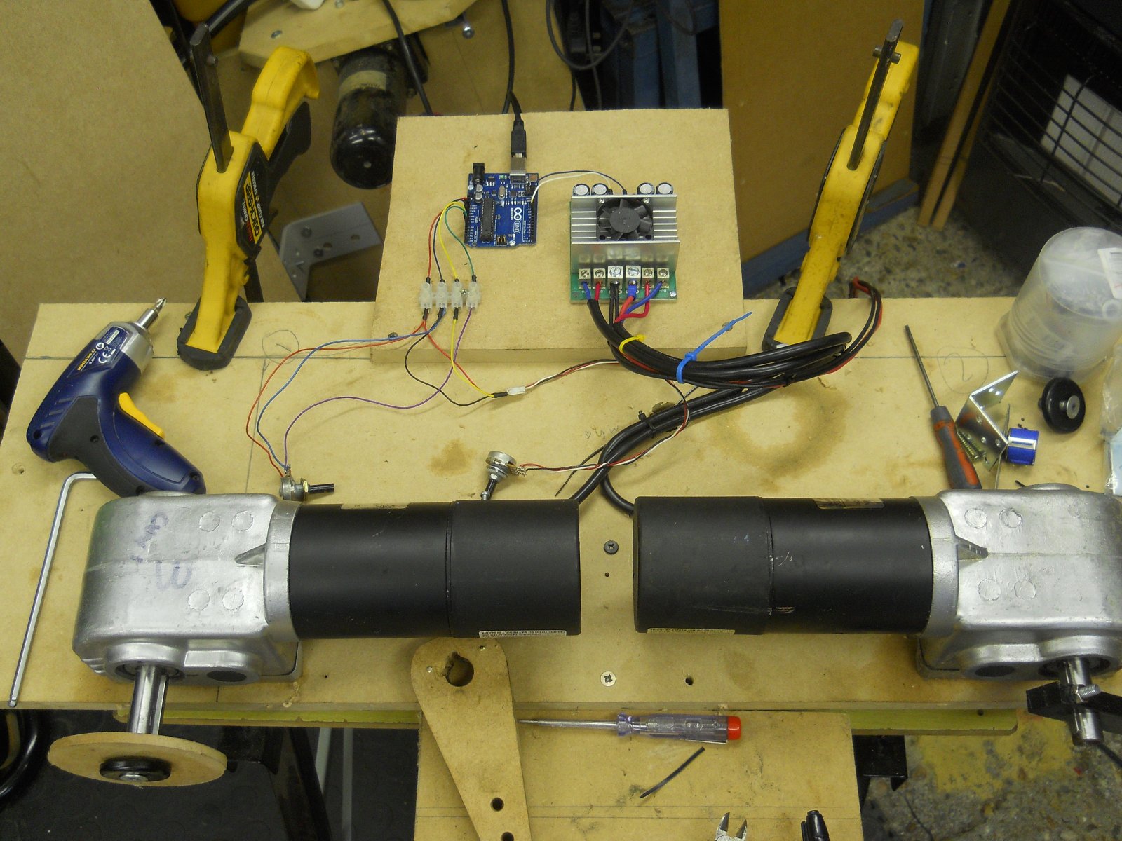

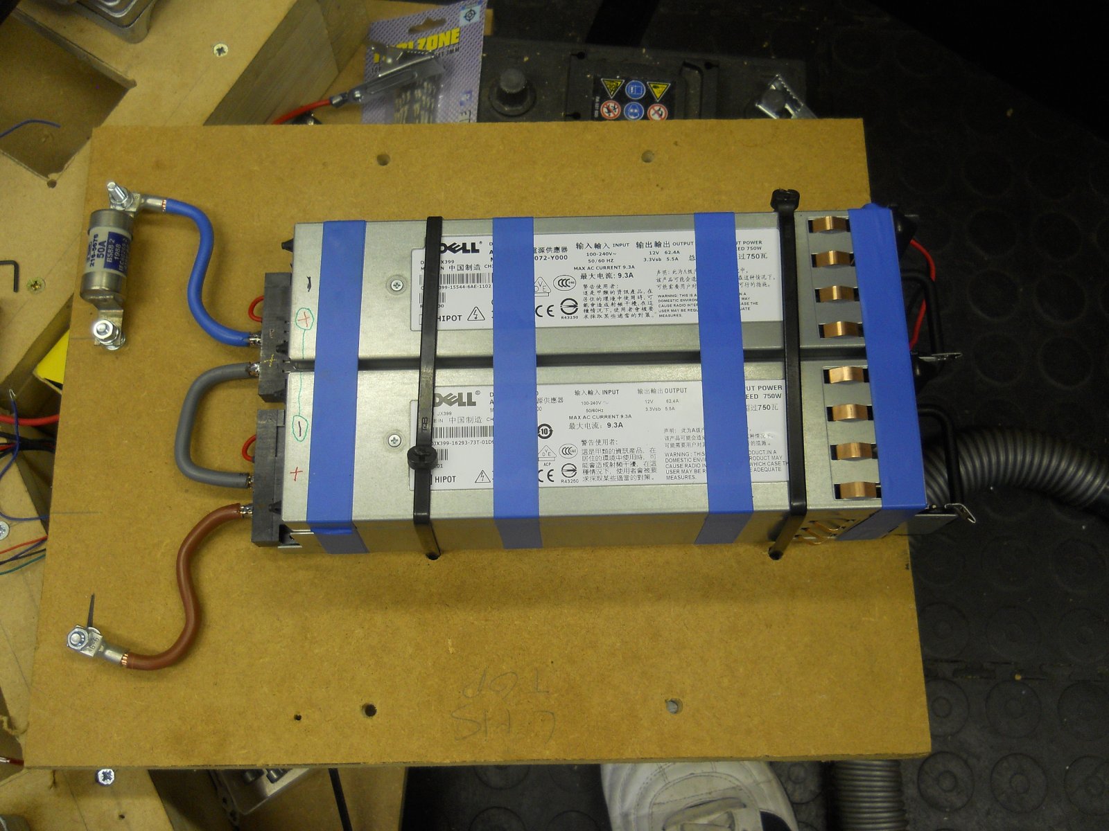

    some pics and new 24V server PSU with DC isolation mods Not the AC side Isolation

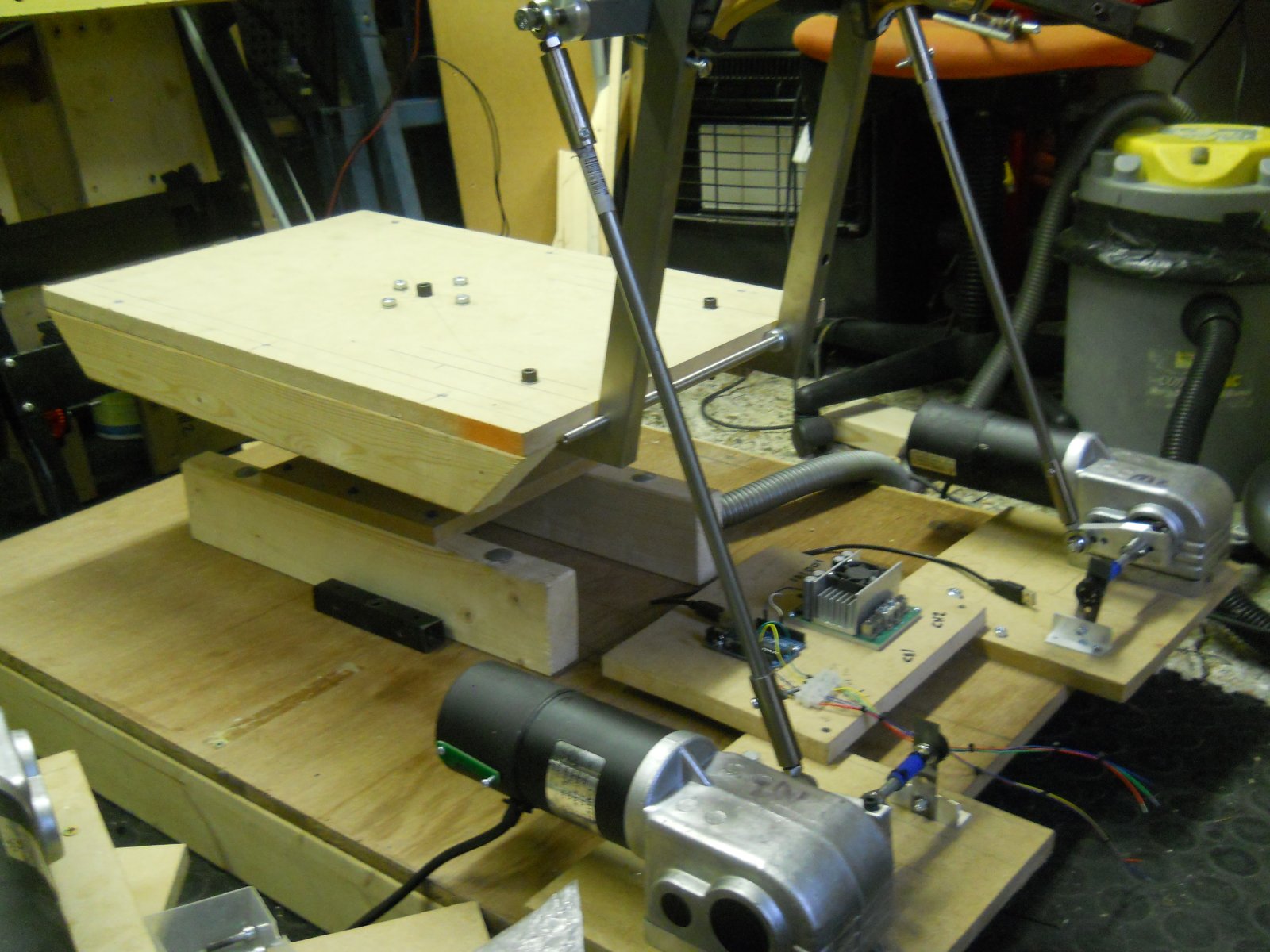

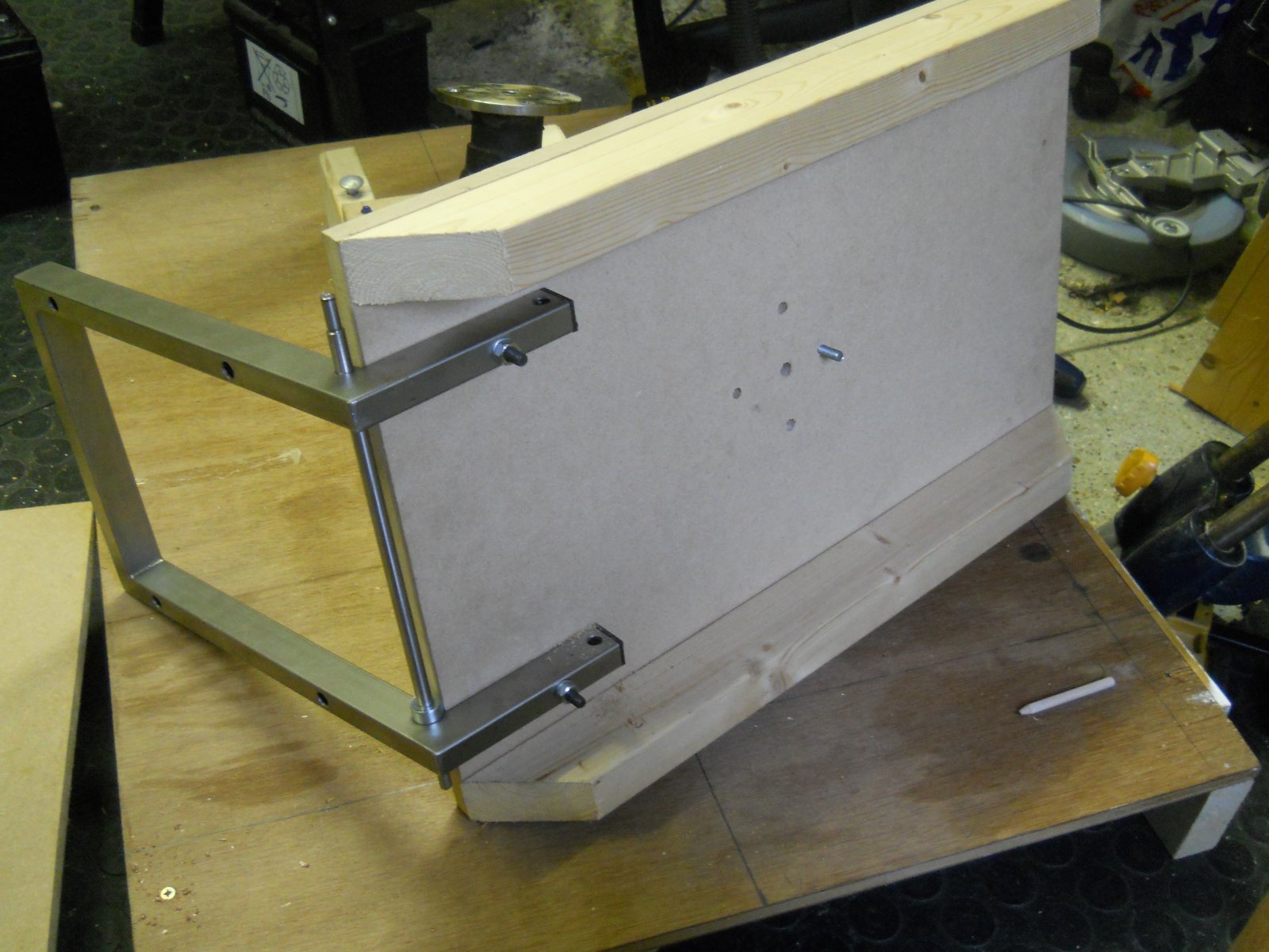

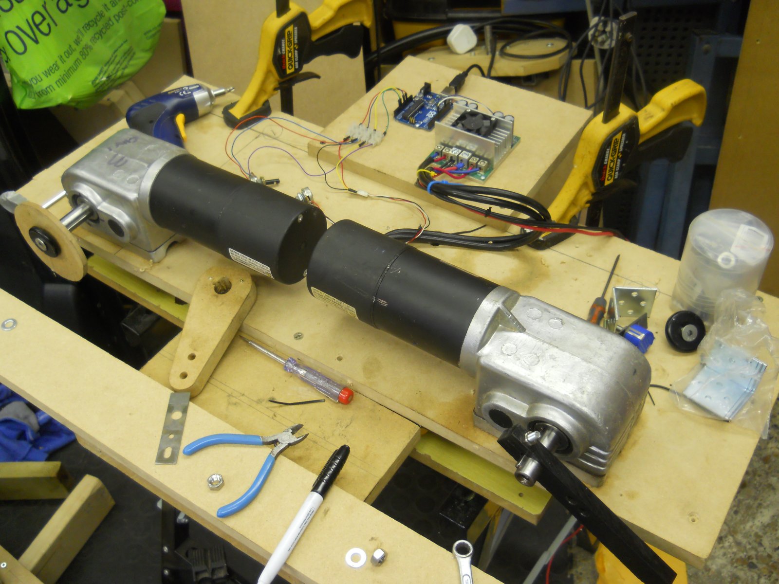

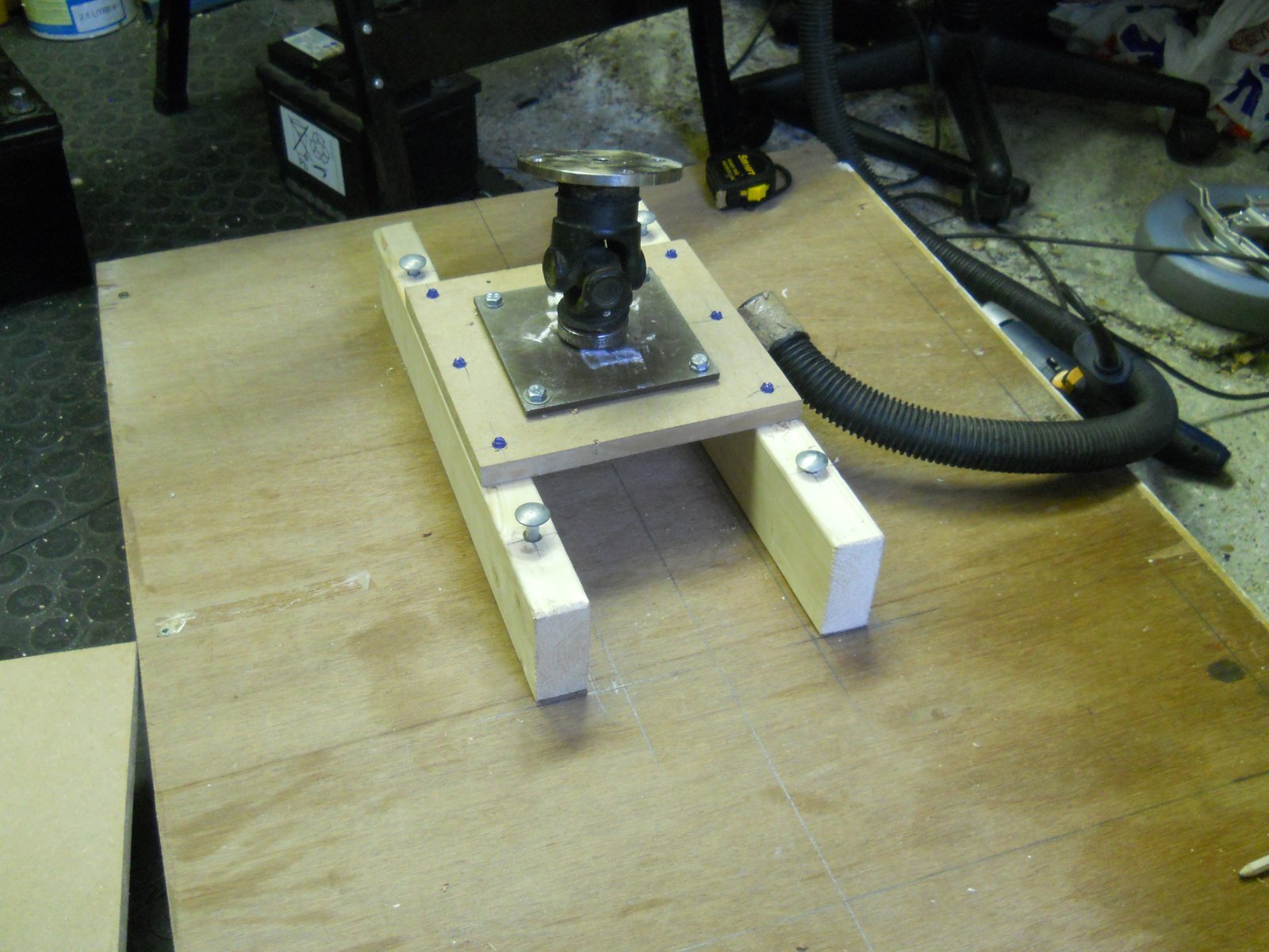

    Hi Guys , Work progressing nicely on both sims 2 DOf and The 6 DOF, will start a new thread for the 2 DOF soon so these will be the last pictures of the 2 DOF Prototype , Really just happy over that fact that at last I have built them and so far other than teething troubles of my own making things have gone well, Both sims have mechanical and Software up and running and no major design issues and seeing as the 2 DOF really was made on the fly with material I had lying around ( collected over the years but never used) its not too bad for the mk1 version :) .. The 2 DOF still needs fleshing out but it seems to work . Slight judder sometimes around the Mid Point travel of the actuator, but I think that's gearbox backlash so maybe I vary the deadzone setting to cure that ..( ps I had 180° Hall sensor pots fitted )
    Busy day today but was able to get it running so tomorrow will be weight testing And seat Fitting .. Lots learnt and now having seen some other sims I believe I can change things for the better and make it with fewer Pieces watch the new Space LOL.. Will draw up the design on cad once im happy and share for all who may be interested :) Cheers Guys Not Done any Current Drawn (Supply PSU / Battery Amps ) tests yet and that should be nice info, seeing as these motors are the same as the ones on the 6DOF, Took delivery of nice little E bay Ampmeter module and shunt to be wired in First though , I know this is going to be a balanced rig so even though the results may differ some info is better than none, Again i'll post the results in the next post ..
