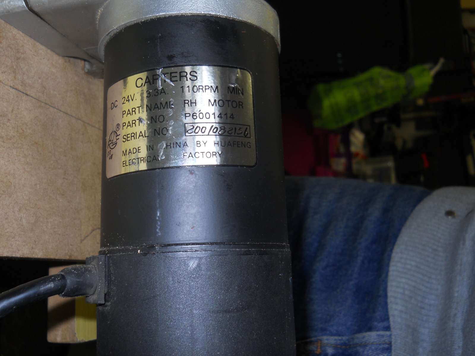

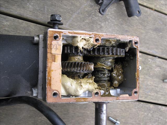

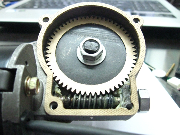

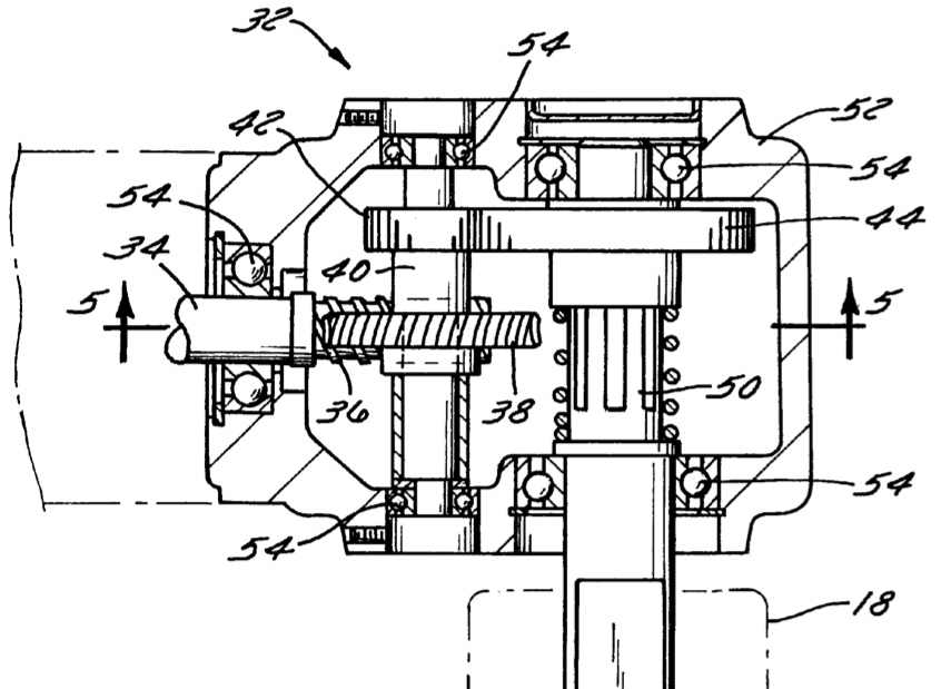

    Worm Drive.jpg i did some research on wheelchair motors and they are worm gear motors. Pictures will help.
    I hope this help

    Hmmm did not see The Picture when i wrote that last post , I may well have to crack one of these babies open just to make sure, Maybe the Helix on the pinon has to be over a certain ratio before it will stop backdriving , i can definetly move my un-powered gearboxes by hand with a bit of force so that may well be a saturday lookie see job :)
  4. tomkil192
    tomkil192 Member
    Jun 25, 2015
    81
    Uk. London
    - 24Coins
    +26 / 0 / -0
    Thats why they have the break. Any geared motor without "hold break" will move under heavy load.
  5. adgun
    adgun Active Member
    Jan 28, 2008
    538
    mechanic
    Netherlands
    5,801Coins
    +138 / 4 / -0
    Not true wormgear motors with big reductions are fully locking.Tooth angle does that with big reductions!
  6. tomkil192
    tomkil192 Member
    Jun 25, 2015
    81
    Uk. London
    - 24Coins
    +26 / 0 / -0
    ok. thanks for correcting. i agree that motors with big reductions and correct tooth angle will self-lock.
    you loosing the speed but gaining troque and self lock.

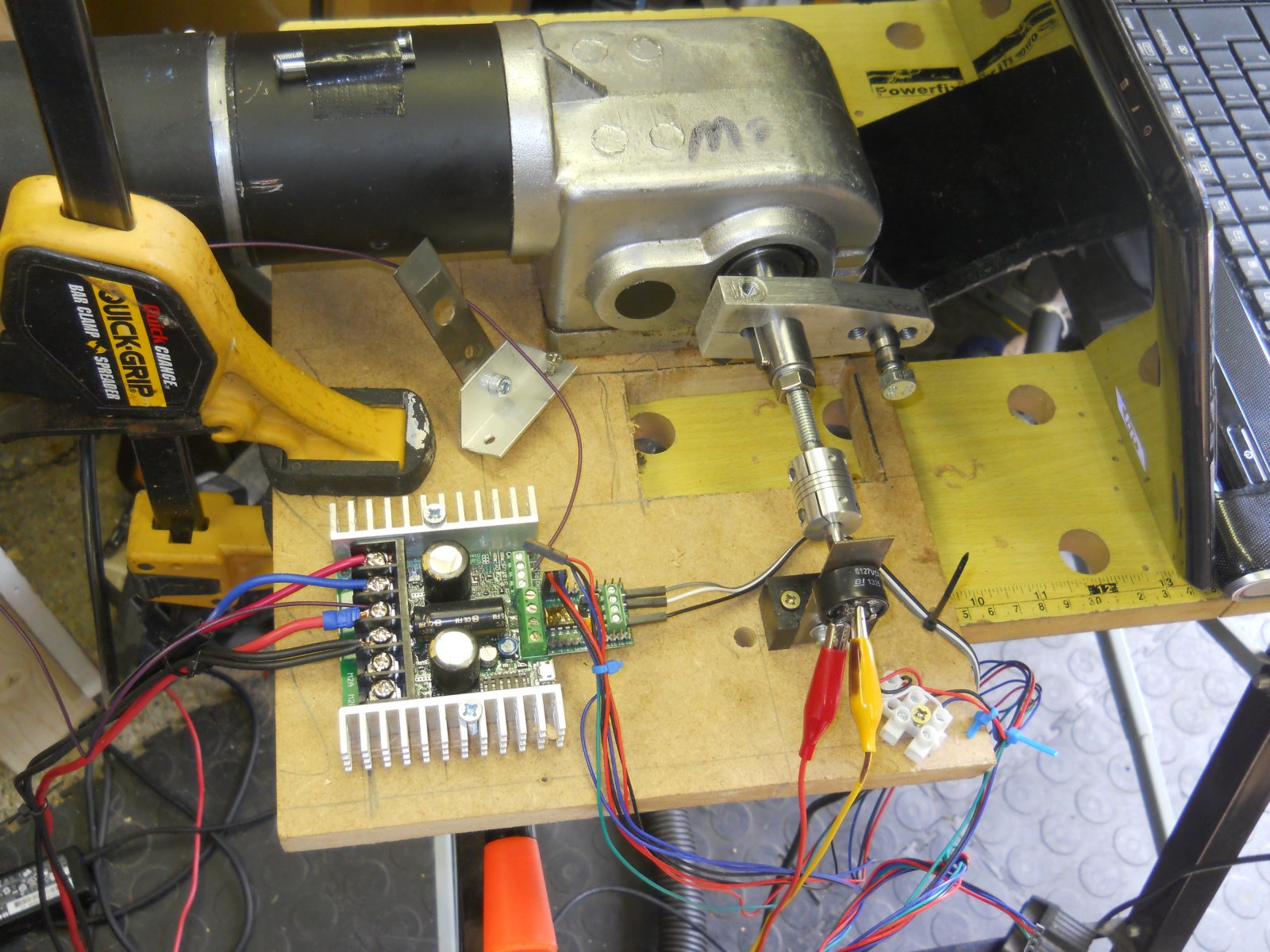

    Hi Guys Just got and answer from the guys at Dimension engineering regarding the max brake operating frequency , apparently the Controller can handle brake switching at the rate of 1 millisecond , I need to figure out what this speed means with regards to the motion position demand output which I suspect will be less than that , this weekend I intend to fit the brakes to me test setup and will let you guys know how it goes , They did mention something about configuring the outputs direct so , more manual reading again cos im sure I;ve missed that section .Cheers Crew

  10. wannabeaflyer2
    Jun 12, 2015
    724
    london uk
    8,350Coins
    +958 / 7 / -0
    Hi Tomkil192 , I have not used my 24v 55 amp psu yet but with the car batteries, in the past I found that once you id the brake leadwires and connect them to the + v and 0 battery neg in parallel with the motor leads then the motor spins freely becuase the brake are engegised and therefore released. You already knew that so sorry if im repeating stuff you already know as I said not tried my psu yet so thats another test I the making :) glad to hear you got them at a good price, nothingis wasted lol if not for this project they will do for the next.. one thing i found out was they will chuck a seatmover around nicely as I think with the racing sims there are fewer power off moments , that may mean backdriving wont be an issue For race sims
  11. wannabeaflyer2
    Jun 12, 2015
    724
    london uk
    8,350Coins
    +958 / 7 / -0

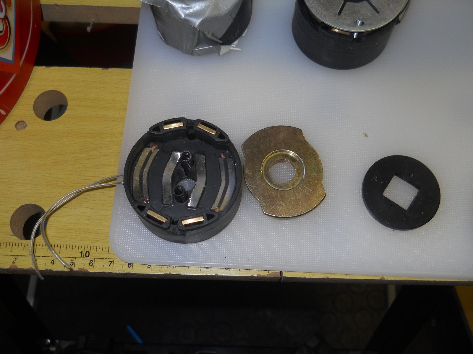

    OK Guys latest test , Refitted the original electric brake to one motor / actuator setup Connected system to Describe and Set The Brake function ON for the Sabertooth 2 x 32 , Then uploaded the new settings and Redid the Auto tune .. I first checked that the reassembled Brake still worked as it should ( Box Ticked OK) electrically and mechanically ( Box ticked LOL ) then I powered up the Sabertooth setup and observed that with no position demand signal sent ( i.e Idle Mode ) then the brake was Engaged ( Ov in brake circuit the default Condition)and I could not physically move the actuator arm where previously I could back drive it with one hand :) , I then selected live test in Describe ( the brake was still Engaged All good so far) when I moved the cursor in the live test Screen ( sent the position demand request) the Brake went to 24VDC ( disengaged ) and the motor was able to Move through the range selected and atfollowed the cursor position at the quick changing position I could achieve using the Cursor mode ( Ohhhhhhhh now this was good stuff LOL ) she seemed to handle everything I threw at it with 2 lead acid batteries hanging of the actuator for loading ... once I exited the Describe live test the Brakes went to 0V and Locked the Motor shaft as expected. this called for a "Yeeeee Haaaaa baby" Moment .... I repeated this test several times in each case trying to load the actuator as much as possible and result seemed consistent , The only observation was that the Brake solenoid seemed to get warm ( This I take it is to be expected as these were never meant to be switched a the frequency im chucking at it).. ..anyone with any thought on this will be welcome . based on this test I'm gonna take the plunge and order 2 more 2 x 32 controller as the 2 x 25 does not have this function .. still Not had a chance to try the optical encoders yet, but that's another test waiting in the wings .. Oppps Forgot to say ran this test with BFF software and FSX and again it seemed to do the job ( early days yet but I'm thinking , getting closer to the final goal ) Car racing sim may be too much for the brake switching idea , but as mentioned in earlier post there may not be the same back-driving issue.. Hang in there guys , more to come

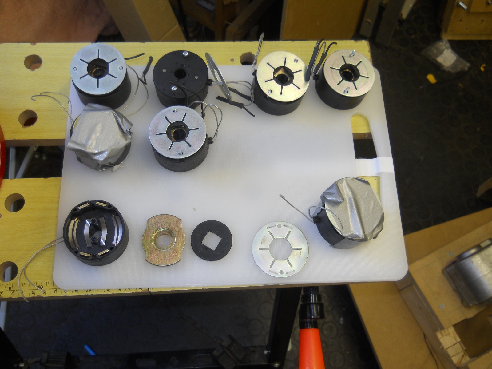

  12. wannabeaflyer2
    Jun 12, 2015
    724
    london uk
    8,350Coins
    +958 / 7 / -0

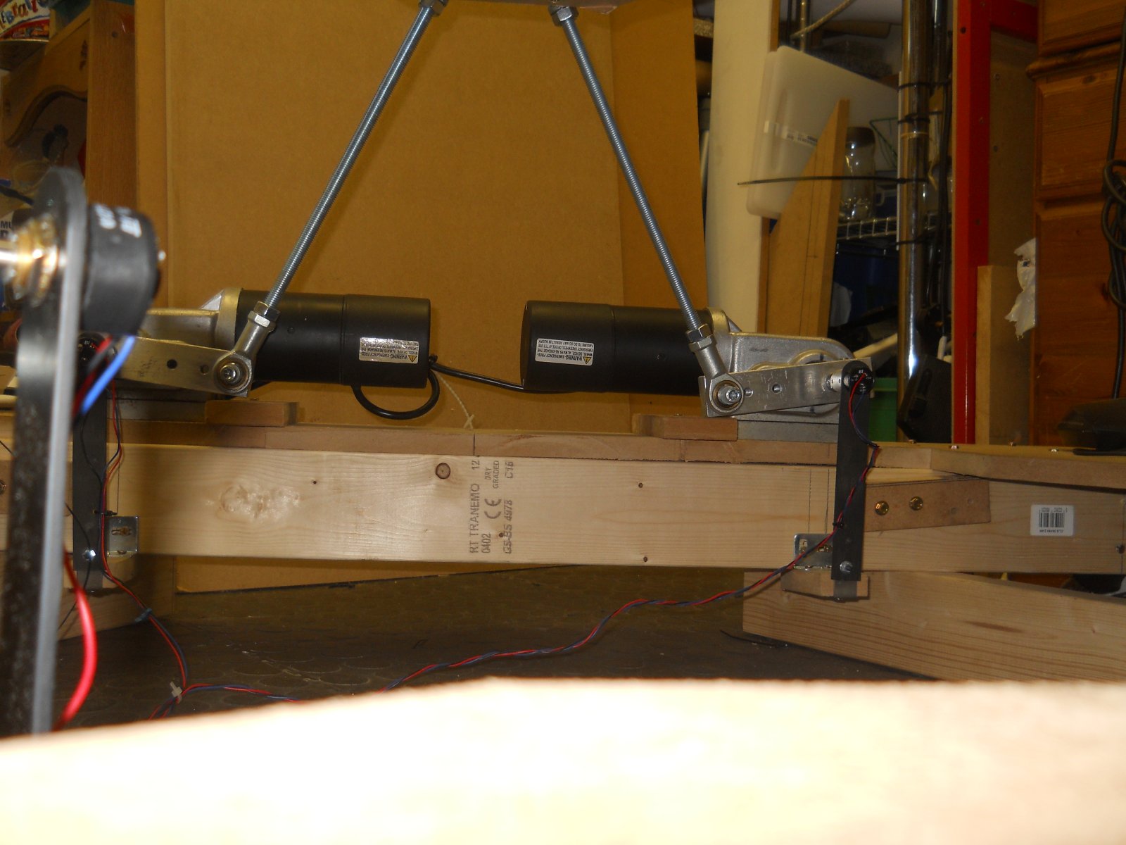

    some pics of the brake assy & 1st stage of test mockup

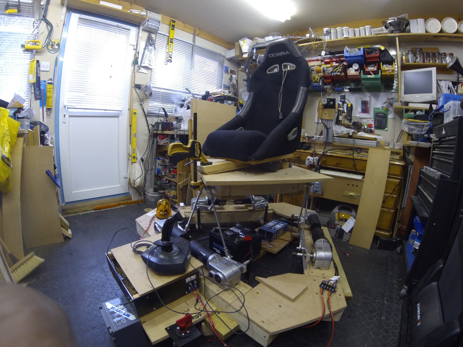

  19. wannabeaflyer2
    Jun 12, 2015
    724
    london uk
    8,350Coins
    +958 / 7 / -0

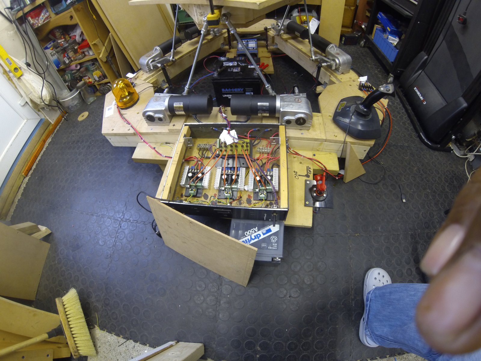

    Hi Guys Immmmmm Baaaack ..:) Ok "Ding Ding" Bell sound gentlemen its Round 2. Finally reconfigured and beefed up the MK1 version , no major changes (I have quickly learnt you'll be forever tweaking designs in that case) I now have 3 2x32 Sabertooth Controllers Linked in my system ,
    All systems seemingly working at basic level, and the Platform has been beefed up , new 12mm Threaded Rod and M12 rose Joints( Hiem joints to our American Cousins) fitted,and new controller enclosure + another lesson learnt was don't underestimate the power of these gearboxes i inadvertently managed to bend one of these 12mm rods during autotune ( forgot to wipe the original settings doohh so take care when testing these systems guys) and done a Complete Dimension Engineering Kangaroo Retune of all 6 Actuators this time with 75KG load on the platform ..
    Scariest time was Autotuning platform with 75kg's on board ,I mean scary , that process really bounces the platform around . good news is that it seems fine afterwards , so today some basic system trials commence again..
    had major delay with FS2004 software as I upgraded my fully working laptop to windows 10 , and blow me , now all of a sudden fs2004 wont work , wont start, does zip when trying to run . to say pissed off was understatement , several internet fixes tried , at least 7 program removals & re-installs and still dead , Not a happy chappy . I used the laptop because its easier to develop stuff in the man cave ( not ready to stick the Tower PC out there ) .. anyways I loaded FSX 10 to the laptop yesterday so at least I can get back to testing the Platform
    Movements ...
    Attached a few pic of the rebuild and will stick the build info once im happy that it "Does what it say on the tin " LOL
