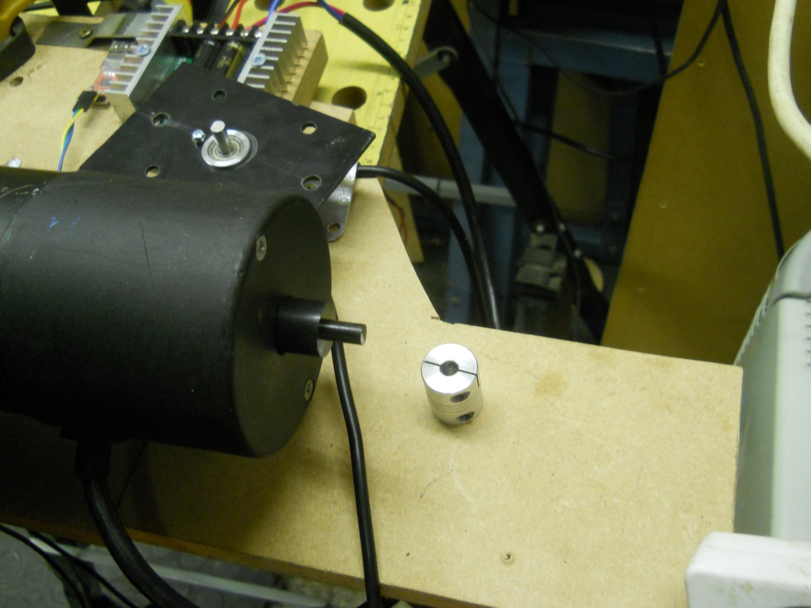

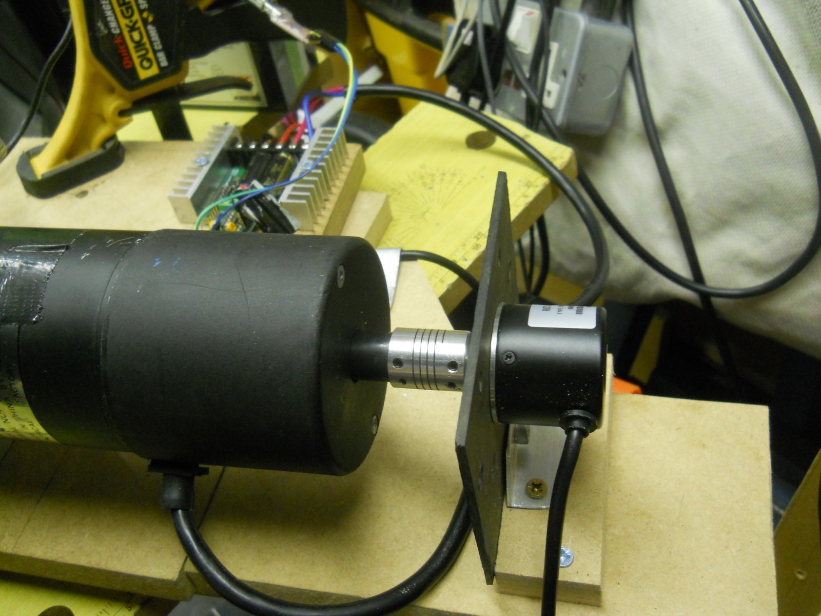

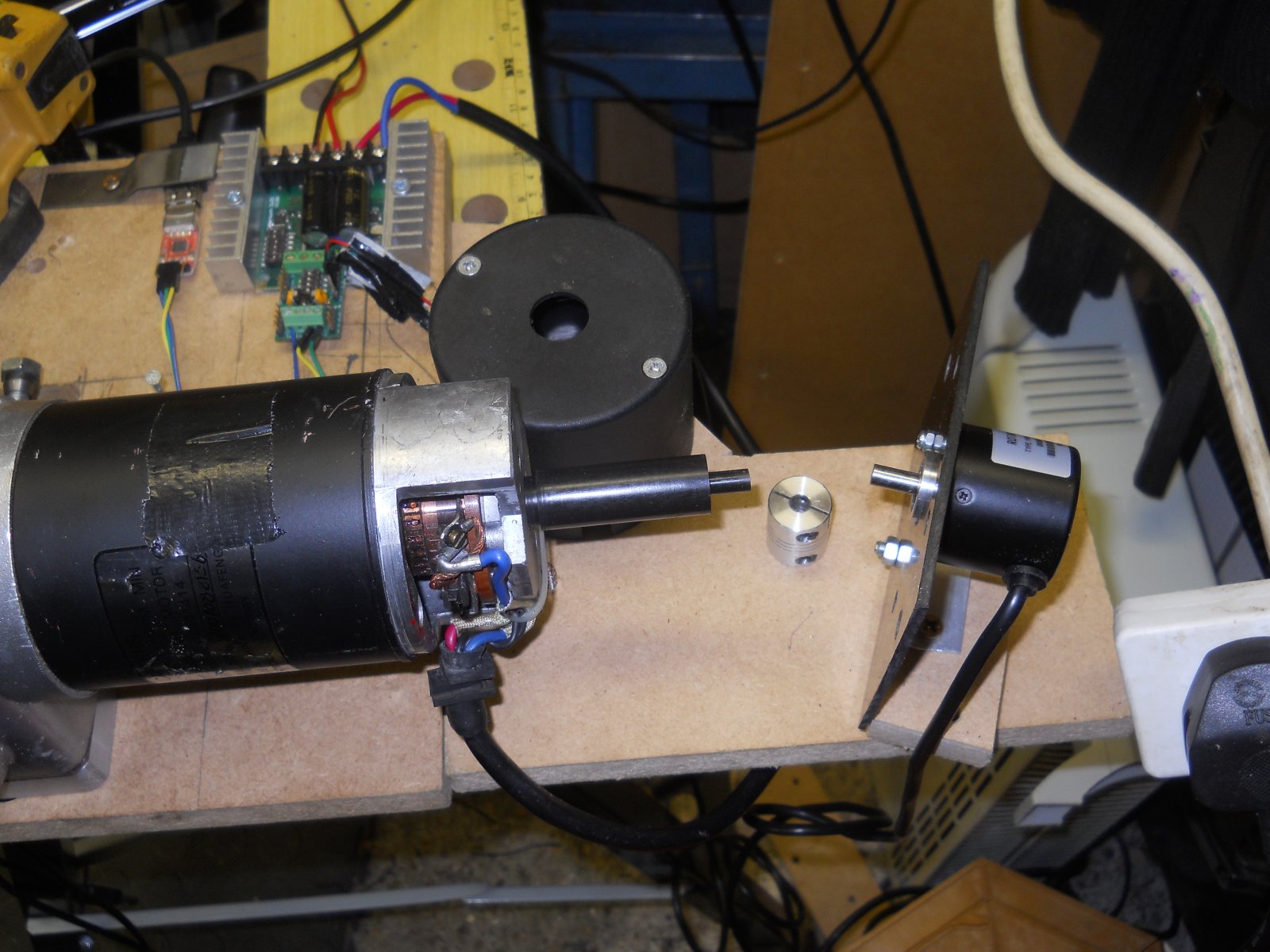

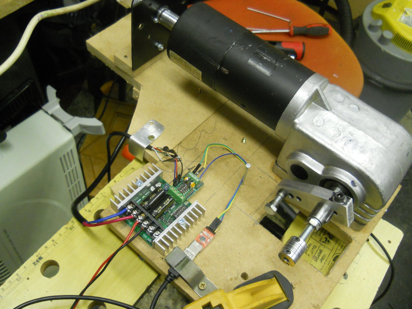

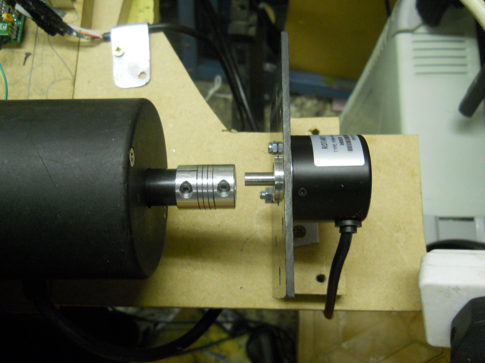

    Ohhh im in a happy place at the moment LOL , Just finished my test setup using Optical encoders ...what a difference , clean signal no noise on the Autotune and seems to be just what i needed to step up a gear on this project.
    i removed the brake assembly from one of my spare Wheelchair / Gearbox actuators and made an adapter so that i could mount the encoder directly to the motor shaft ( no Backlash to worry about) ,drilled a hole in the plastic cover and fitted a flexi coupler to the 600 Count optical encoder,, Connected it all up to Kangaroo and set dip swithces,, Reset Kangaroo to default and made some changes to Describe ,,,Powered up (No Smoke good, No Movement Good for this phase of test and No error lights on Both sabertooth and Kangeroo ( Bloody Great :) ) anyways the damn thing worked a treat so far my actuator was lifting 3 x 12V lead acid Car batteries at a leaver length of 40mm centers ,
    The result to my mind was impresive. I'm able to use the cursor in describe to control arm position and its spot on (no Hunting or Judder at set point ) rapid motion using 50% step function did not cause any issues ( so Far ) and even though i used a small 7 amp 12 Volt battery supply to my 24V Motor it lifted all 3 batteries no problem ( NO CONTROL ERROR reported ) now thats a YEEEEE Haaaa Moment if ever there was one) .. early days yet and it will mean i will have to tear down system to upgrade each of the 6 motors ...
    That'll be a small price to pay if this option does the trick . Tomorrow i'll see if i can mod another Motor and swap em out on the sim, Then i can test it using just 1 pair to see if it still performs in situ... Fingers crossed i will be at last able to give some decent info to you guys . The Kangaroo option may not be dead yet :)

    Hi Guys Good news Continues , Was able to Reconfigure one pair of actuators had to change location of the motors because they would not allow the Optical encoder Mod. Well nothing ever goes to plan with me Turns out the second Optical encoder has a fault ( Bummer )
    Bought 2 of them a while back but not opened the boxes seeing as how i was still battling with the Hall sensor option. Next time Test before storage ,
    Problem surfaced when i tried to Auto-tune the Other actuator. it went loopy and i thought "Gimme a break moment LOL" anyways after checking and rechecking the sensor fitting and wiring problem still there ( Scratching Bald spot time again:) then swapped the Optical sensor for the one that works and Bingo Tuned 1st Time and worked as i had hoped it would ( even with 25KG Bag of Sand loaded over the actuator , Great Stuff cos at least i know it works and the motors are good to go ,, also refitted the iffy sensor to the good working actuator and problem followed it there so Yep Sensor Problem ...
    Does any one have any tips for checking these Optical Encoders?
