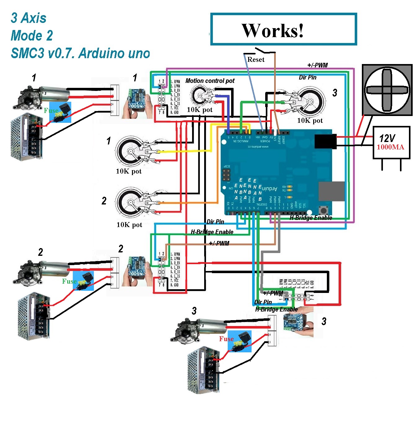

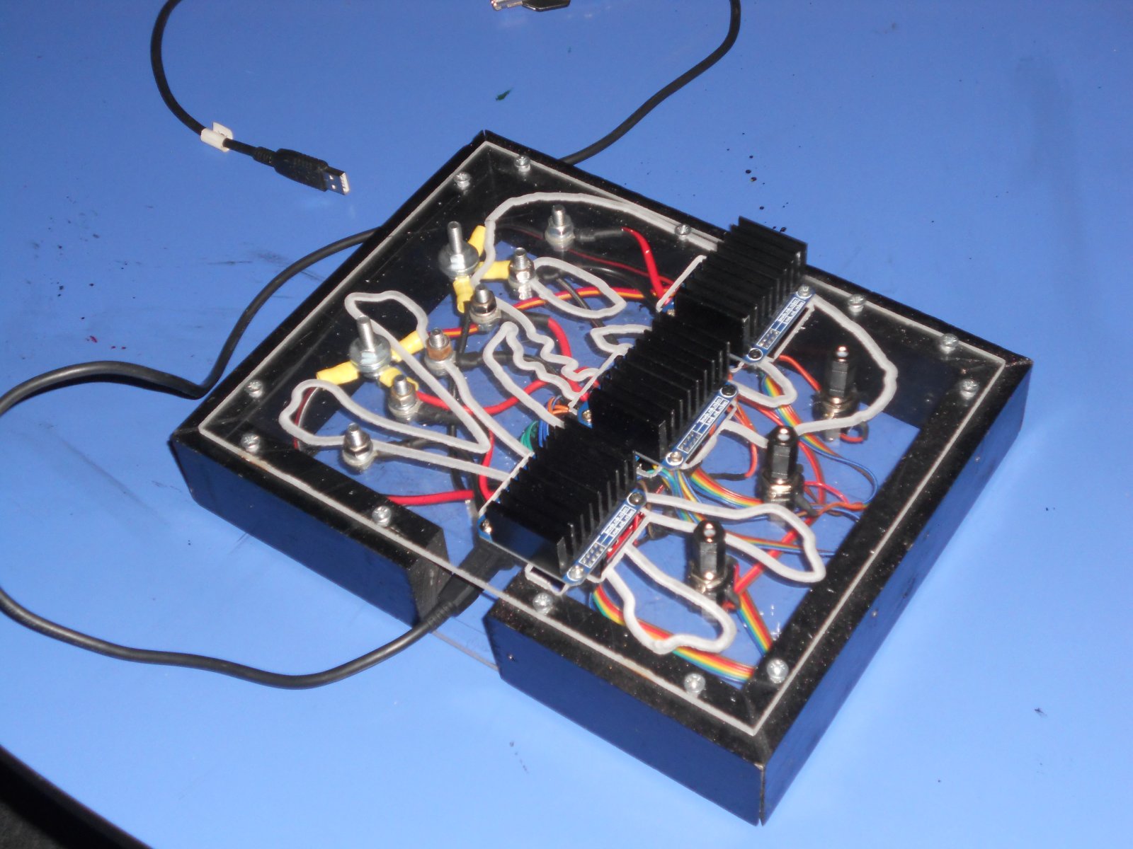

    Hello, someone has the correct arduino code for this image. I'm new to this. And I'm looking for it like crazy and I can not find it.
  2. grooste_lwd
    grooste_lwd Active Member
    Nov 20, 2015
    123
    Nederland => Friesland => Leeuwarden
    124Coins
    +91 / 0 / -0
    That's the painting I use for my simulators. This the code to use. Works easy.
    If you have trouble first time.
    - check arduino USB cable! (makes sometimes errors. Bay a good one!)
    - upload SMC3 arduino code to arduino. // check top rule! // IBT-Bridge is mode 2 // #define MODE2
    - repower arduino
    - EXTRACKT SMC3UTILS.zip
    - Edit the file: ===>>> SMC3Utils.ini
    # SMC3Utils.ini
    UDP_PORT=20017
    COMM_PORT=3 //<<<<=///////////Here your comport of your arduino. Check arduino software.
    IMG_PATH=c:\temp
    - Run SMC3Utils v1.01.exe. It must work!
    No need to connect the motors. First check your pots is moving lines. Make your self at home with the progam.
    Check all your axis! hours after hours. Makes sure arduino connection to pots is 100% good.
    - If its the way you like? Connect your motor. Motor go complete wrong way? Our out direct to max one way? Most common error of my. + / - on motors must be changed!
    I hoop it helps you!

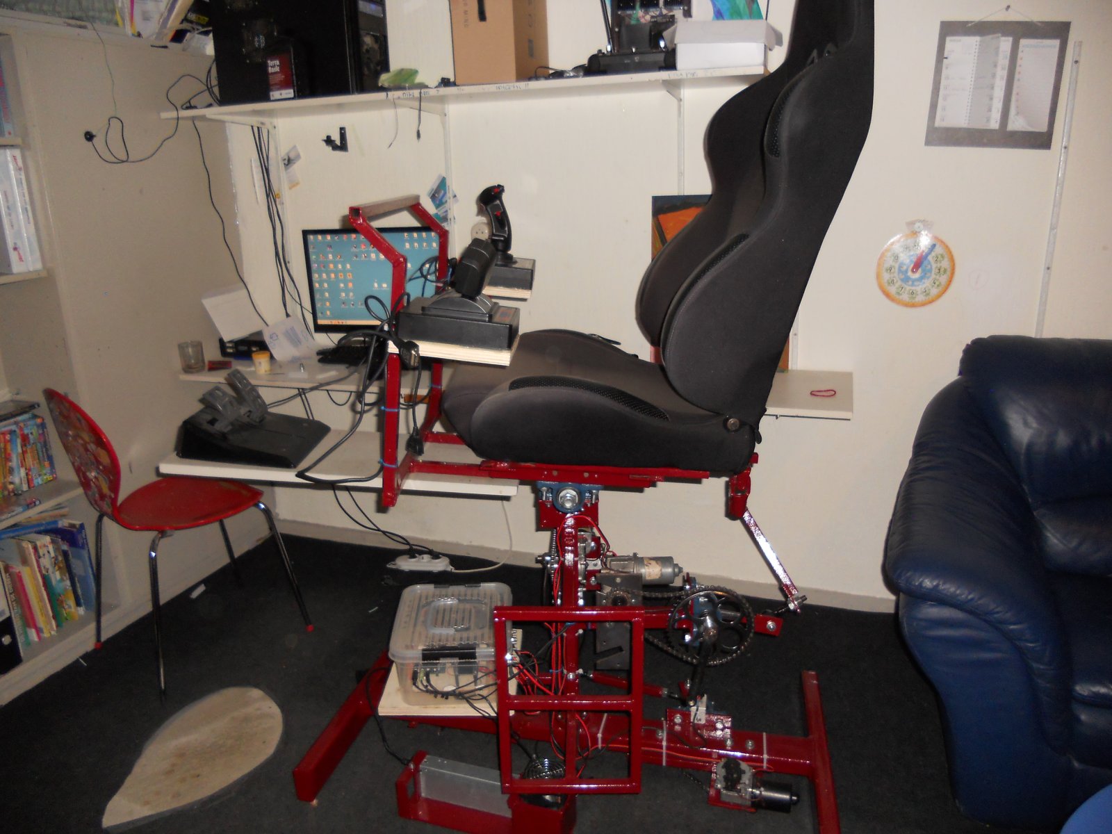

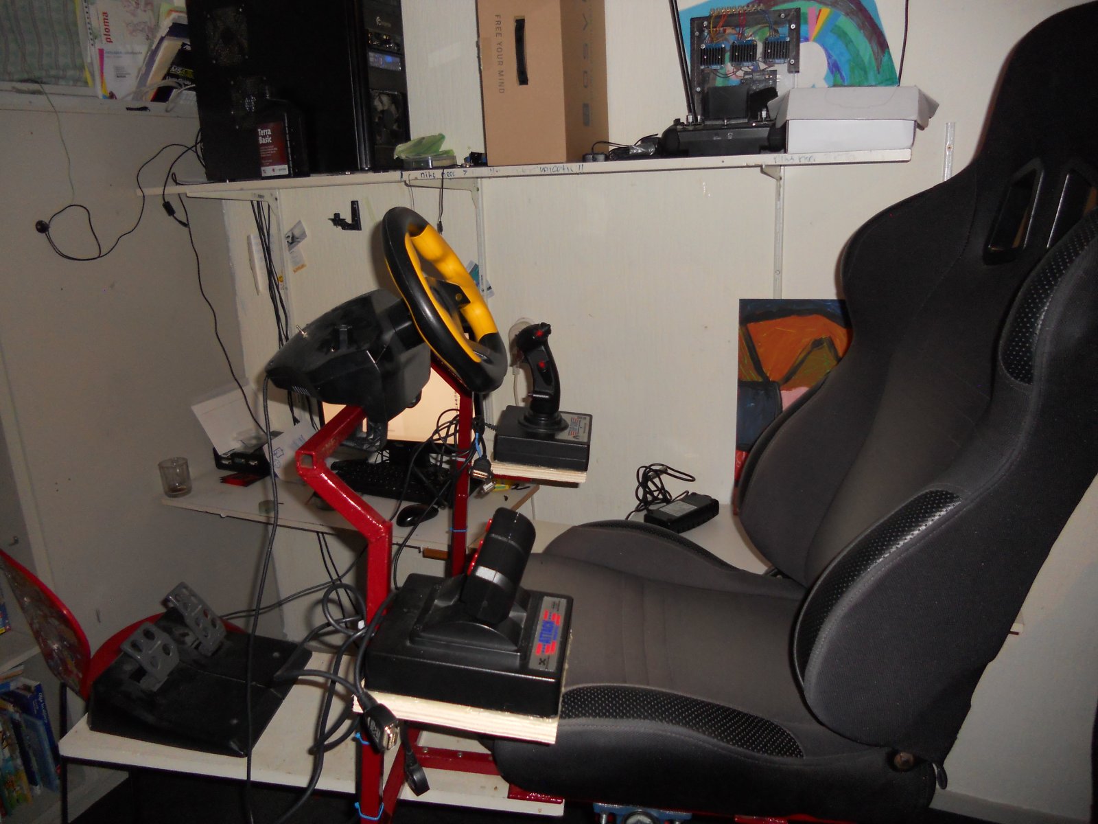

    Motion sim almost raddy.
    • Like Like x 5
  4. grooste_lwd
    Nov 20, 2015
    123
    124Coins
    +91 / 0 / -0
    All most ready.
  5. grooste_lwd
    Nov 20, 2015
    123
    124Coins
    +91 / 0 / -0
    Running Life for speed. no load. Surge, Sway, Yaw! :) Me so happy :)

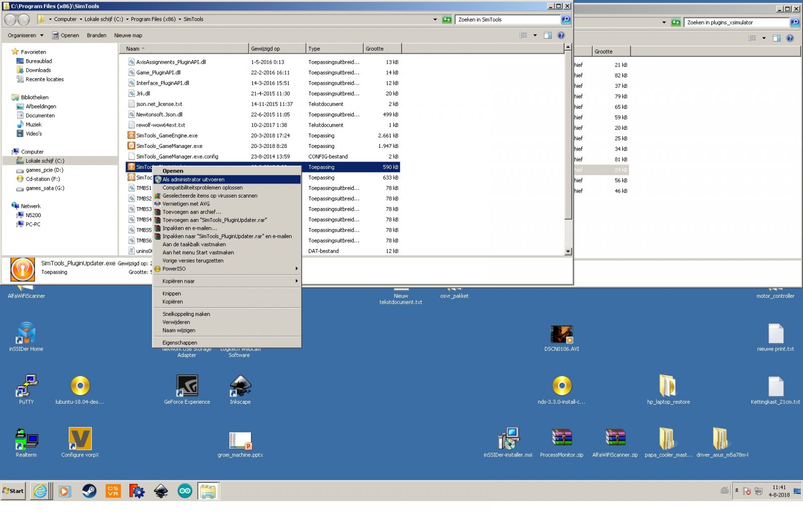

    My small girl racing VR :) Life for Speed,
    22,208
    154,711Coins
    +11,211 / 57 / -2
    You should not need to use admin privileges, as that can possibly mess up file access.
    What version of Windows are you using, as XP is no longer supported?

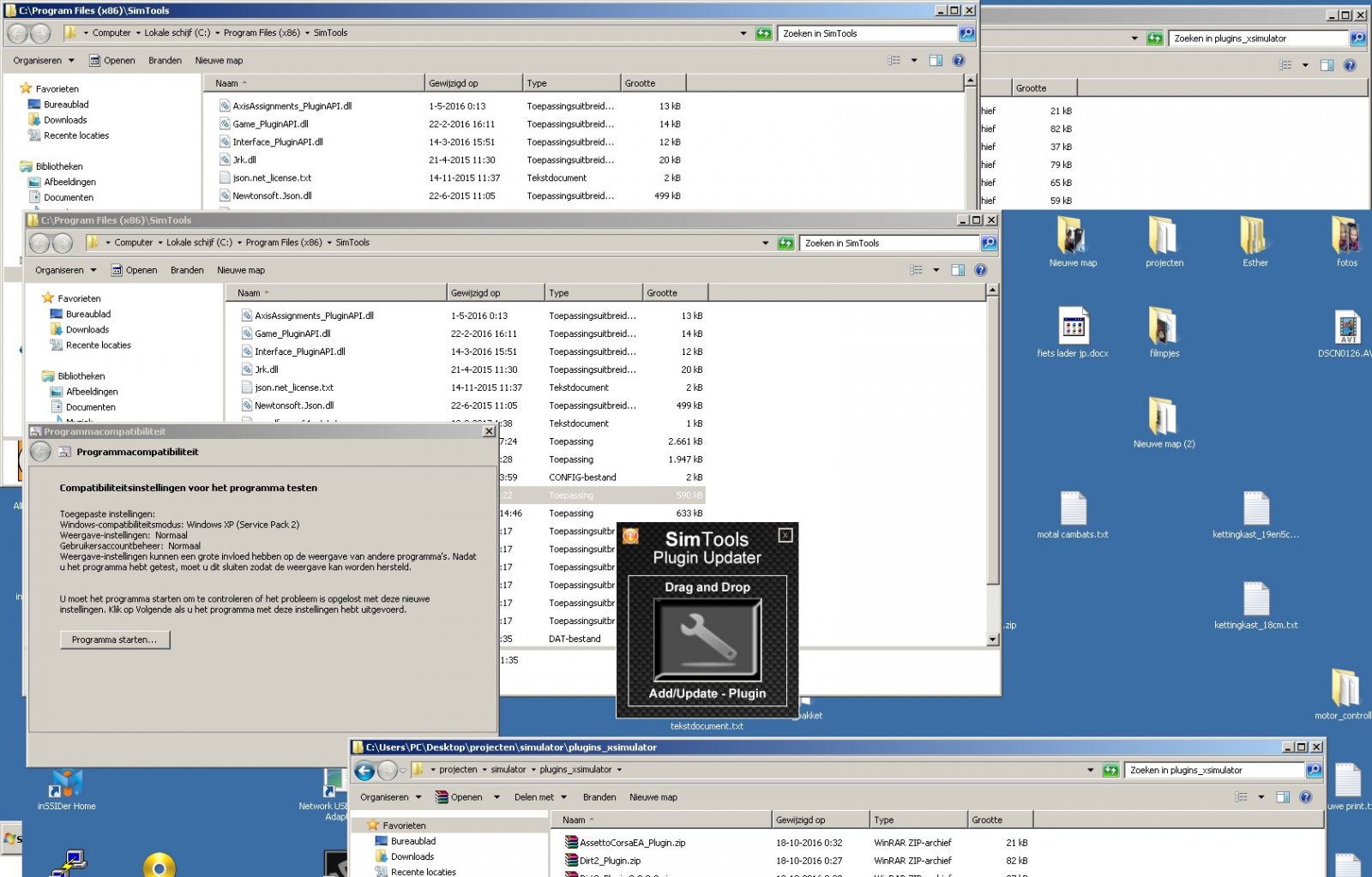

  12. grooste_lwd
    Nov 20, 2015
    123
    124Coins
    +91 / 0 / -0
    Win7 64bit, a good s new PC. I think I do something wrong. Virus scanner = down, :( ,,, Racing Life for speed! :).
  13. noorbeast
    22,208
    154,711Coins
    +11,211 / 57 / -2
    It sounds like you have a anti-virus false positive, SimTools has been submitted to some of the common ant-virus vendors: https://www.xsimulator.net/community/marketplace/motion-simulation-software-simtools.63/
    Game Manager has the abilities to scan a games memory space so we can get the telemetry from games that don't supply any.
    Therefore you may get a false positive with some anti-viruses.
    To fix this problem, just add it to the exceptions list for your antivirus.
    (windows defender example)
    https://support.microsoft.com/en-us...dd-an-exclusion-to-windows-defender-antivirus

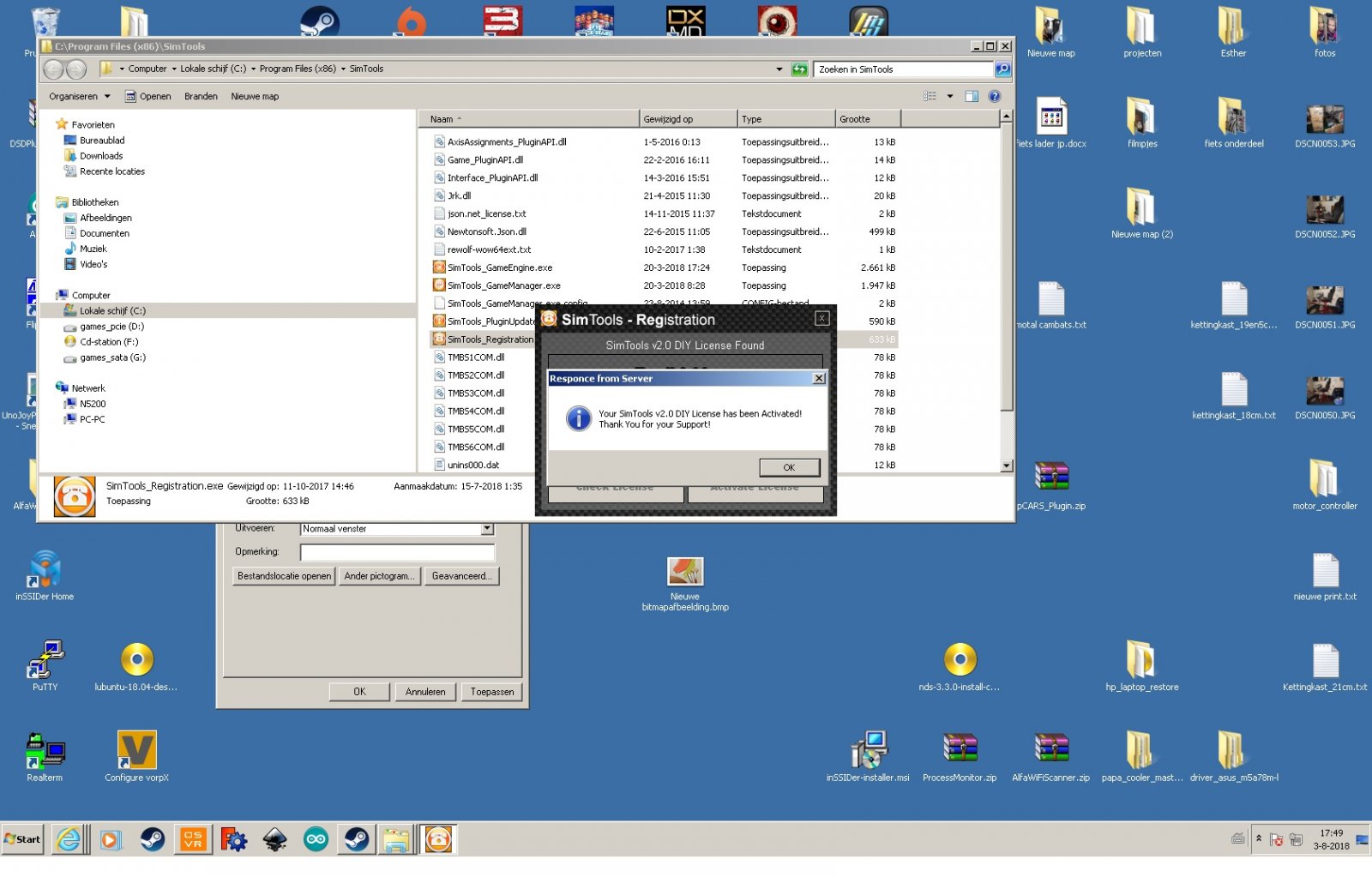

  15. grooste_lwd
    Nov 20, 2015
    123
    124Coins
    +91 / 0 / -0
    Problems fixed, running project cars! a friend of my fixed it. I had 2 simtools installed. 1 very old 2016. All plugin renewed. And works!

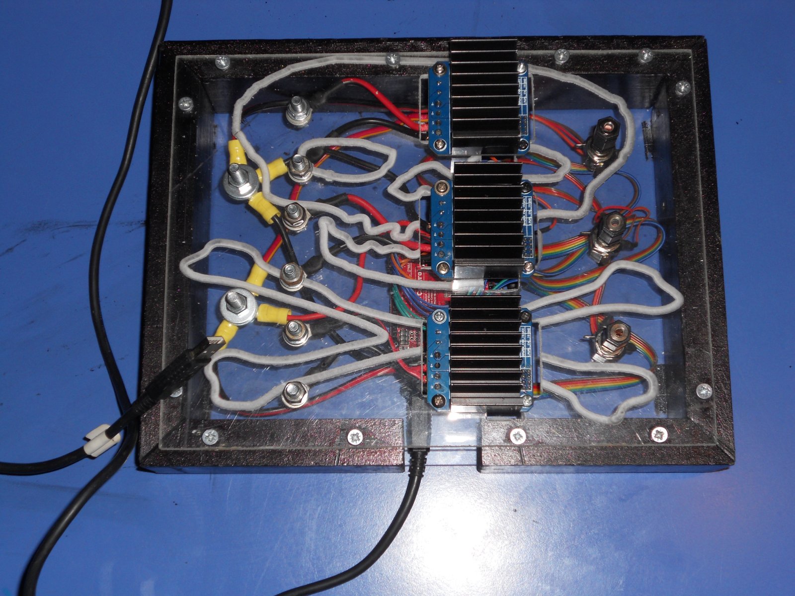

    Have made a new smc controller.

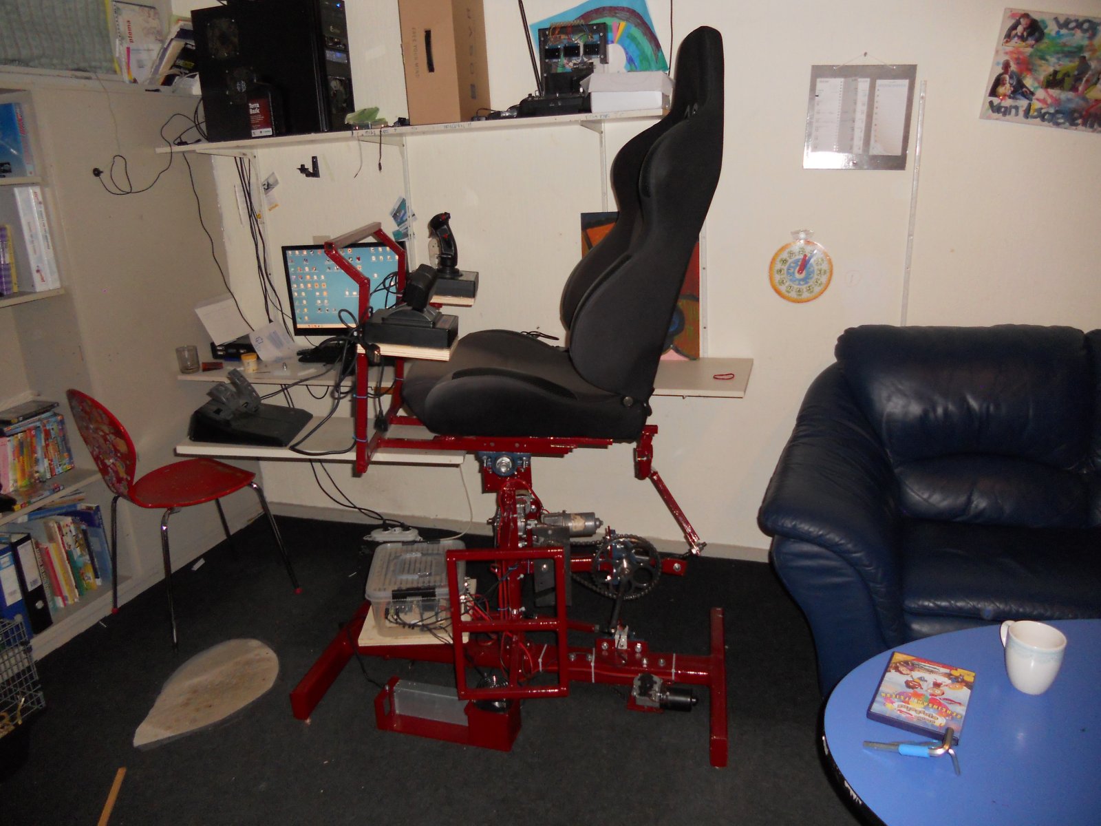

    I have completed my simulator. And raced with dirt rally. Want to show this. I drive Pike Usa.
