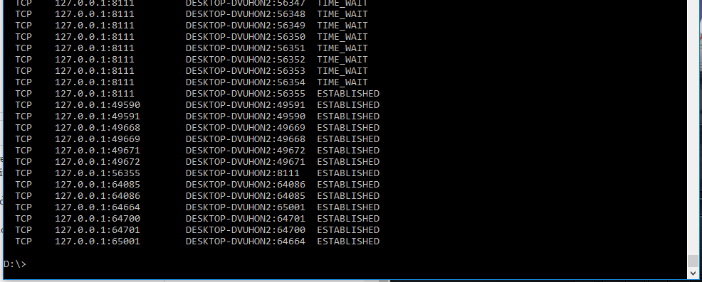

    Doesnt work for me. When patching it's not displaying "patch installed" after choosing the directory. Later it does recognise game, but no telemetry appear in tuning center. Tried to run everything in admin mode, no-go.

  5. Ville Pesonen
    Ville Pesonen Active Member
    Jan 13, 2015
    136
    871Coins
    +200 / 0 / -0
    the plugin gets its motion data from the dynamic map over network. run the game, open a browser and go to http//:127.0.0.1:8111
    there should be a map and some other information. that is the reguirement for this plugin to work.
    If you're using a firewall software (like the windows built in one), add an exception for simtools to have access to the network. a firewall might be blocking the communications.
  6. 4apaev
    4apaev Member
    May 19, 2016
    82
    Media
    Moscow, Russia
    486Coins
    +39 / 3 / -0
    There is a map and some figures on this address. I've tried to disable firewall altogether. Everything running in admin mode. Still no info in tuning center. Can it be that patch not installed correctly? Removed-repatched several times, still no "patch successful" message.
  7. Ville Pesonen
    Jan 13, 2015
    136
    871Coins
    +200 / 0 / -0
    I looked at the plugin source and noticed that there is no code for showing that the plugin was installed correctly, so you will not get a message saying it was installed correctly. I should probably fix that sometime.
    when you start war thunder, does Simtools tell you that WarThunder is running? if so, the patching should be ok.
    Here's one thing you can check to see if the SimTools is communicating with war thunder.
    start SimTools as normal
    open command prompt (no need to run with elevated priviliges)
    start war thunder
    in the command prompt type:
    netstat | find "127.0.0.1"
    and hit enter.
    if everything is ok, you should see a long list of connections to localhost (127.0.0.1). Most of them are in TIME_WAIT state. Couple of the last ones should be in ESTABLISHED state.
  8. 4apaev
    4apaev Member
    May 19, 2016
    82
    Media
    Moscow, Russia
    486Coins
    +39 / 3 / -0
    Here is screenshot to sum it up - everything should be working, but it isn`t. Except that "heave -1" nothing pops up in tuning center. No idea what to do next.
  9. Ville Pesonen
    Jan 13, 2015
    136
    871Coins
    +200 / 0 / -0
    Sorry it took me a while to respond, as I've not had a time to look into this. I made little changes to the plugin and compiled a new one for you. Test if this one works.
  10. 4apaev
    4apaev Member
    May 19, 2016
    82
    Media
    Moscow, Russia
    486Coins
    +39 / 3 / -0
    Hooray, it works! Thanks heaps!
