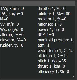

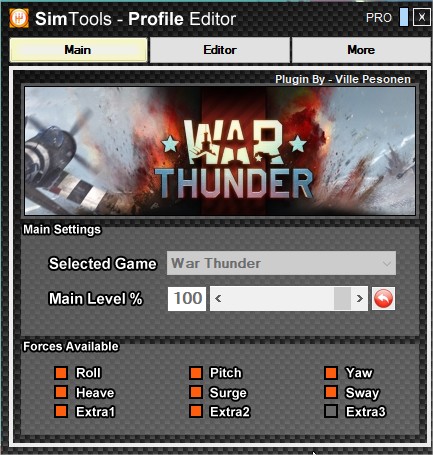

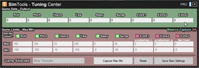

    I have just tried it, no luck :
    Game patched, game manager launched as admin, I can see the webpage when on a mission, I hear my simulator trying to adjust over the heave effect, which go from 0 to -1, but nothing move on the tuning center.
    What do I miss ? Is there some configuration to tick in the confuscating menus ?

    Best to post pictures of all of your settings.

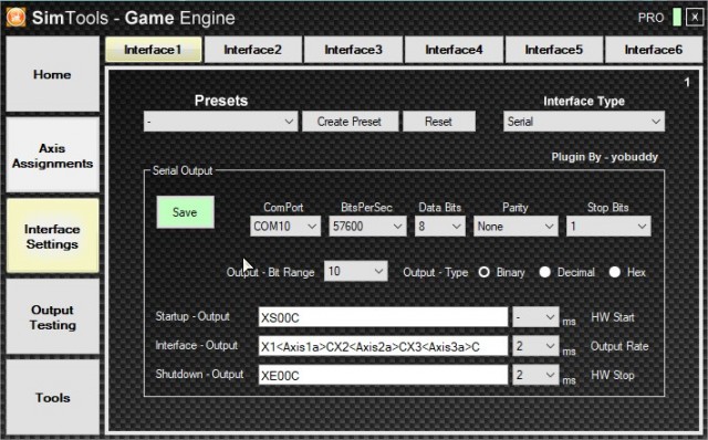

    here you go :
    As you can see, I have info on the 8111 port, but nothing on the tuning center.
    Game is detected as running.

    Well... It seems a trouble in DCS is the same here : it start working ! (But still no luck in DCS, I will retry tomorrow.
    I changed the region decimal separator to a dot, instead of a comma.
    Now to tweak these values !

    What hardware are you using and what arduino code is being used?
    Your axis allocations should be around 100% total, yours is like 395% total, which is easy too high.

    I have a simukit sk3, so serial connexion, wanegain arduino code for the moment.

    Ignore my silliness, I was looking at your TC on my phone and meant the values were likely too high, but mixed that up with Axis Allocations.
    Does the sim respond correctly in Output Testing: https://www.xsimulator.net/community/faq/which-way-to-set-simtool-axis-movements.230/
    If so does Game Manager turn blue when the WT is running and do you then see values in the TC Game Data - Output?

    yes, the sim respond correctly in Output Testing, also in game, I have it running successfully on a few games (assetto Corsa, ProjectCars, trackmania turbo).
    The Game Manager turn Blue and there is now data flowing un the TC.
    I think the culprit was the decimal separator on my region settings. That is not cool, as there is a lot of ripple effects when altering this value, on many other programs.
    Anyway, it work, and I have to adjust settings, it was more of a wooble soup than a feeling of what happen on screen !
