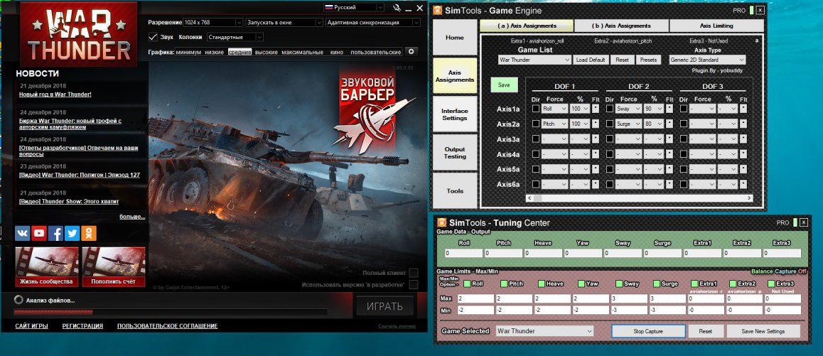

    What version of simtools? 2.2.3 or 2.2.5? what version of the plugin? what can block data? I get them but not all!
    22,209
    154,717Coins
    +11,212 / 57 / -2
    Use the latest version of both SimTools and the WT plugin from the Downloads section.
    Anti-virus and firewalls can somtimes be an issue, in either interfering in proper installation of plugins or in blocking data.
    But first please post pictures of all of your settings.

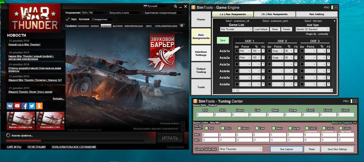

    The plugin does work, but something on your system is likely interfering with it.
    What are your Interface Settings?
    Have you tried temporarily disabling your firewall and antivirus off, then reinstall the plugin, then try it.

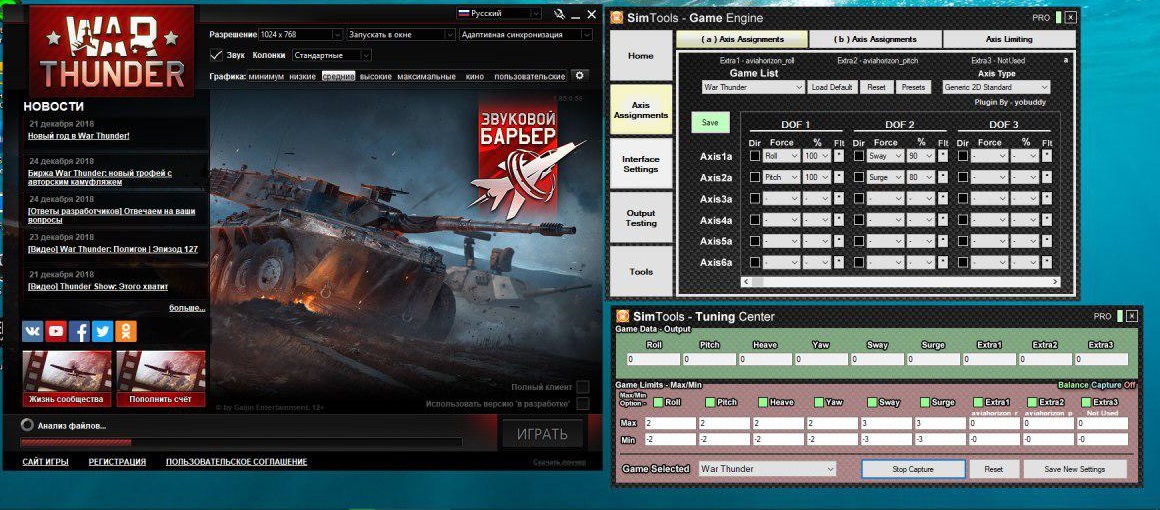

    I installed the plugin, it recognizes the game and I get every force data but roll and pitch, what's wrong?
  17. noorbeast
    22,209
    154,717Coins
    +11,212 / 57 / -2
    Have you captured the Tuning Center Max/Min values?

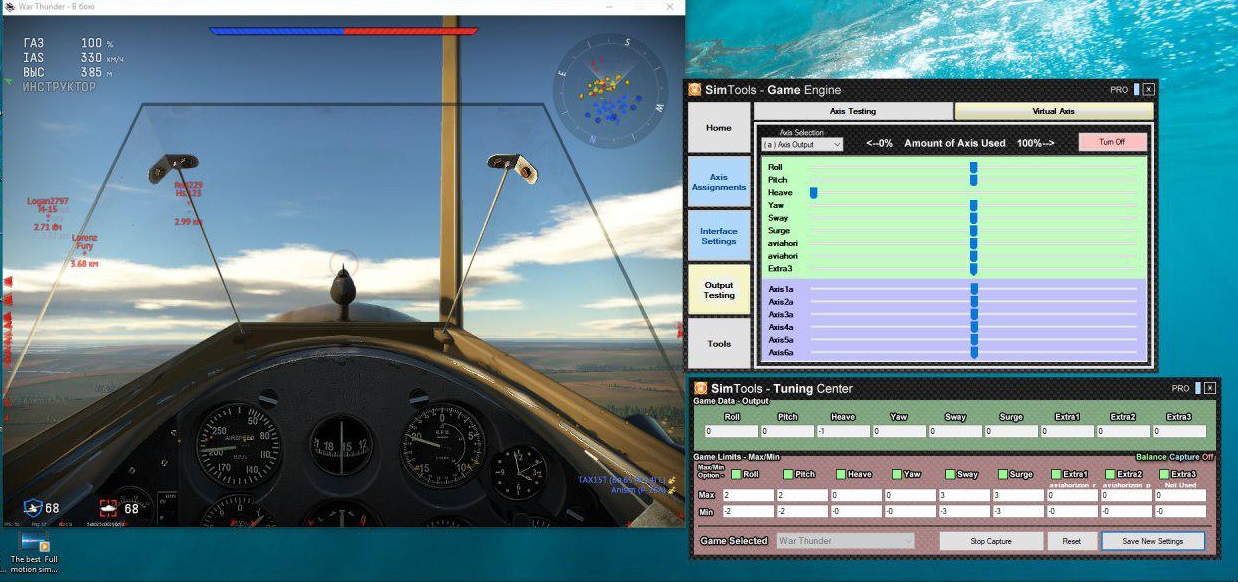

    Hello! I need a hand here.
    I have a 2dof sim and for this game I can't make the sim to emulate the plane's position because it goes back to the center (which I think is perfect for space ships but not WW planes) Well this only happens if I set "Extra1" and "Extra2" forces.
    If I set "Roll" & "Pitch" the sim does not go back to center position, but, it only reacts when the plane moves from + degrees to - degrees then sim moves from one extreme to another.
    I'm on last SimTools version and it happens on every WarThunder plugin that has been released.
    Thank u guys
  19. noorbeast
    22,209
    154,717Coins
    +11,212 / 57 / -2
    Extra 1 and 2 should return when the joystick returns to its neutral position.
    Roll and Pitch are the alternate traditional forces, but like with any flight sim you will need to use Filters and Anti-rollover to get the most out of the profile and rig.
