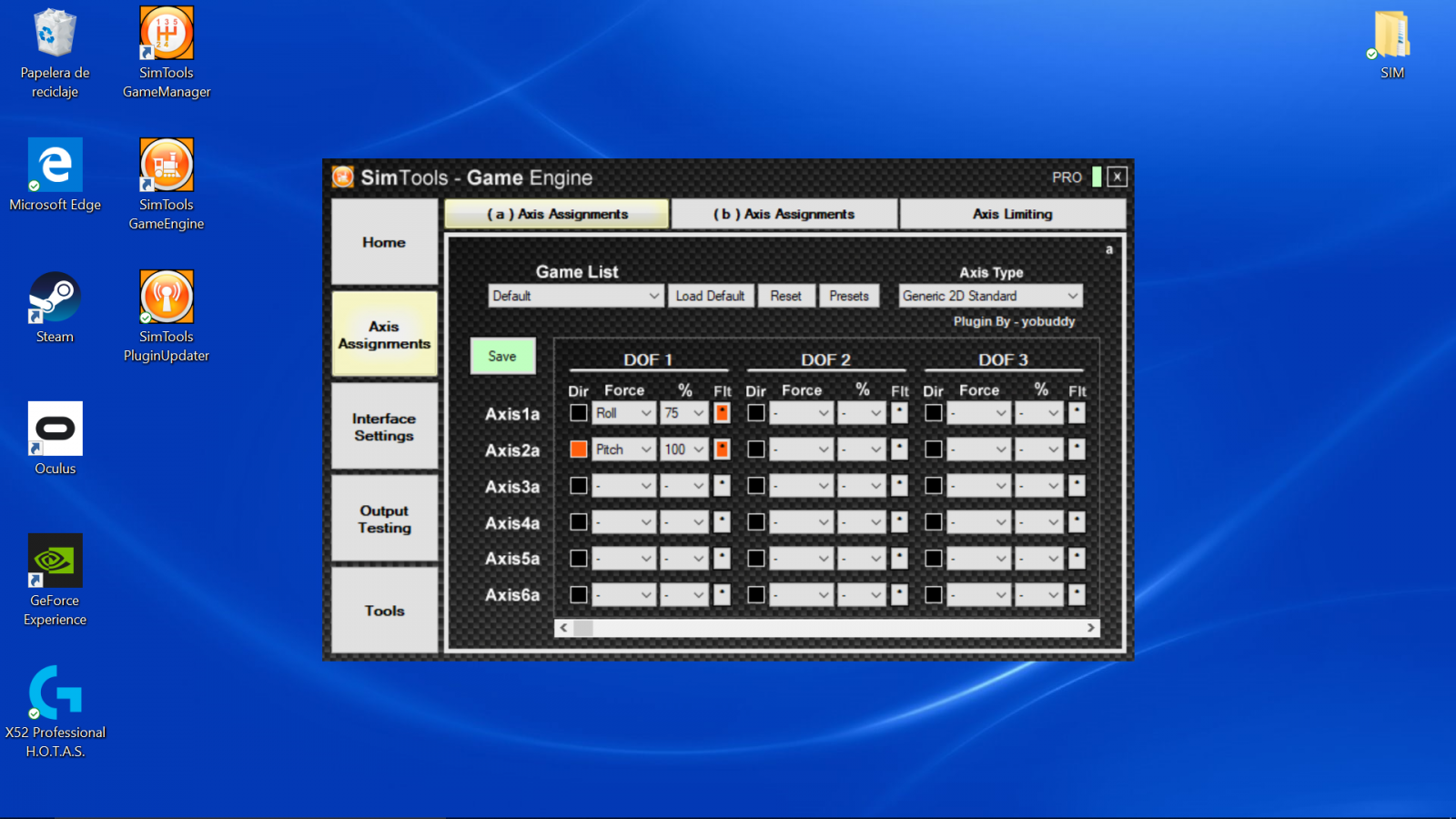

    Here are my settings:

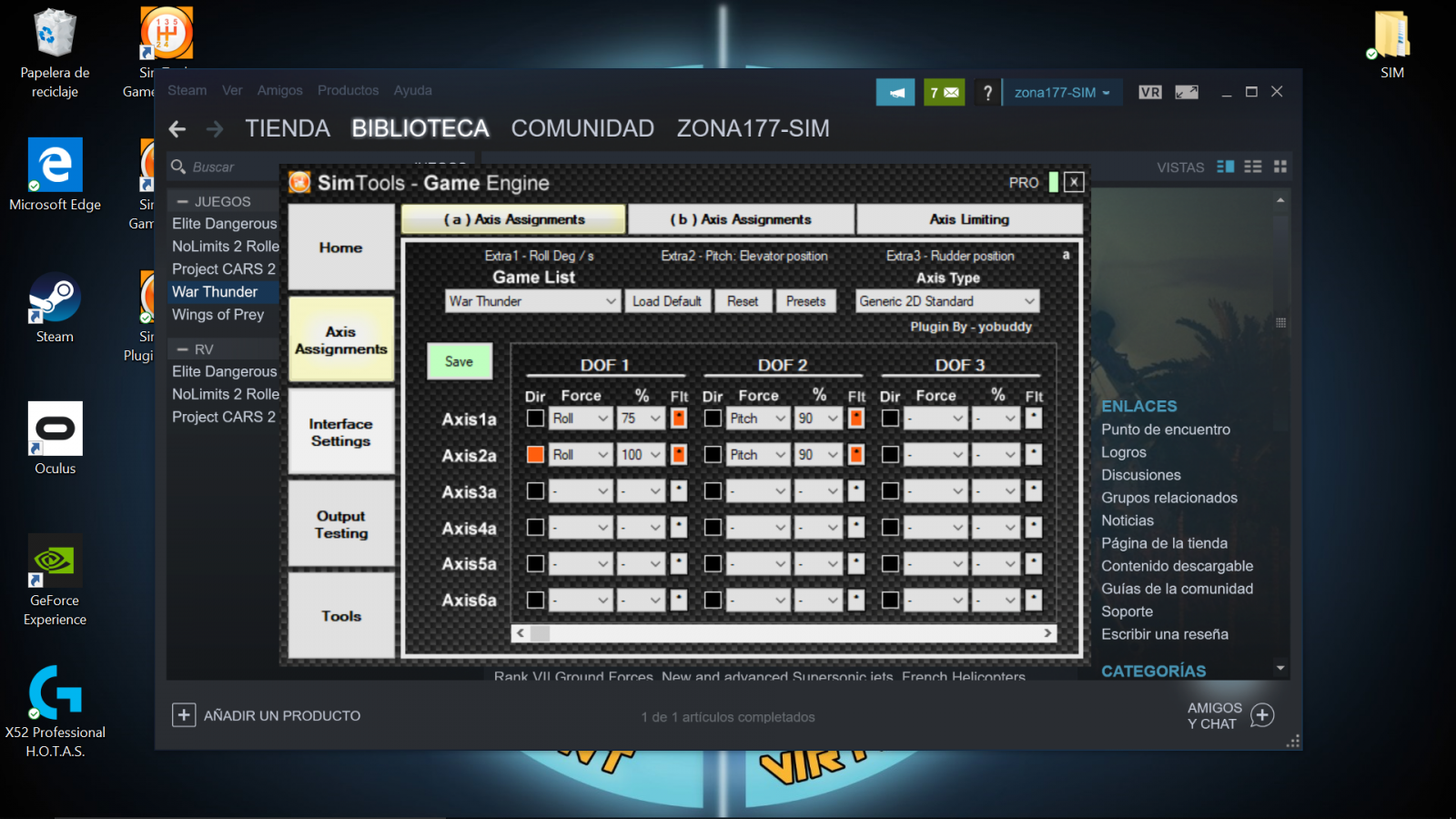

    Thanks, it is now as it should. But I still can´t get the simulator to move in war thunder

    Every data is recorded, but pitch and roll

    Your % allocations for Roll are still odd, I would expect them to be the same value.

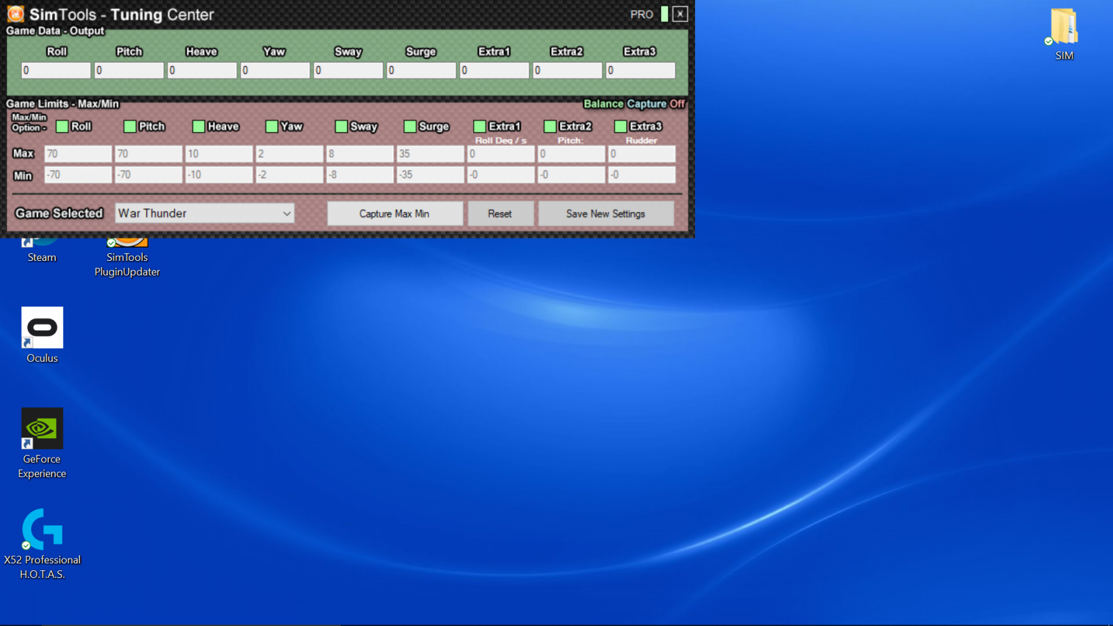

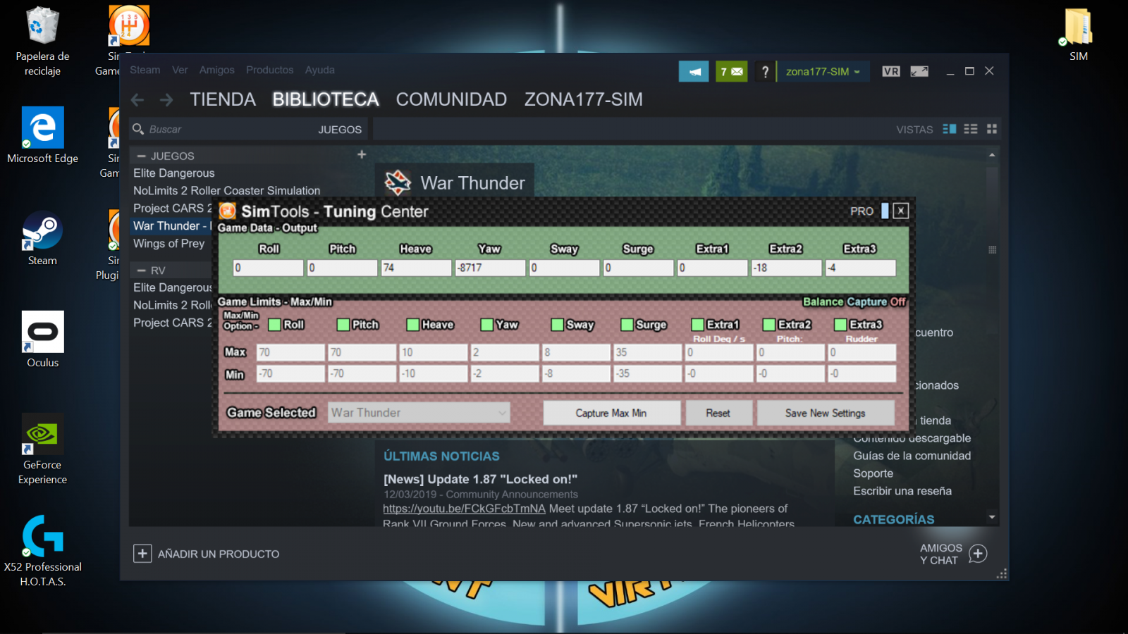

    The Tuning Center picture shows data for Heave, Yaw and Extra2 but not any other axis, can you please confirm that there is data in the Tuning Center for all the other Axis.
    Have you gone through the steps for refining the motion profile, in particular capturing the Max/Min values in the Tuning Center: https://www.xsimulator.net/community/faq/steps-to-create-a-motion-profile.228/
