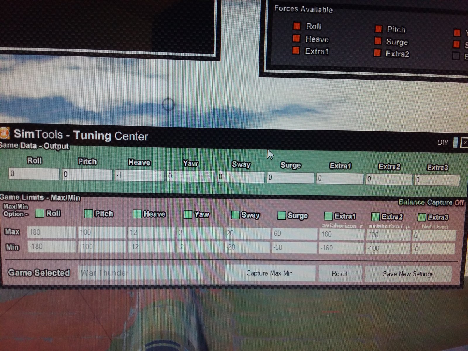

    Hello ! I have a simtool V2 from September and I download your plugin yesterday. When I launch the game, my motion plateform move a little in the home screen. I'm tested with the tutorial Combat and Landing and in game my plateform doesn't work. Game Engine and Game Manager are in the administrator mode, patch is ok. I don't understand. Can you help me ?

    It sounds like you need to refine your motion settings profile: https://www.xsimulator.net/community/faq/steps-to-create-a-motion-profile.228/
    It would help if you posted pictures of all of your settings and a video showing the movement of the rig and the game screen play at the same time.

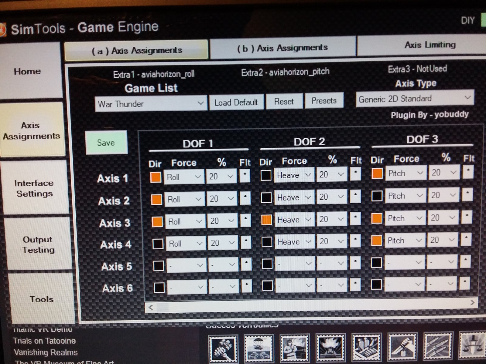

    Hello ! Can you tell me what you think ? The game is patched, heave, pitch, roll, surge, sway are activated in 20%. Assetto Corsa works perfectly for your information. Game manager and game engine are in administrator mode. Just a very very little move heave to launch the game at home hangar menu. After when i launch the tutorial mode or combat mode any movement. I don't understand ?! I have windows 10 and i use steam. Best regards. Cédric

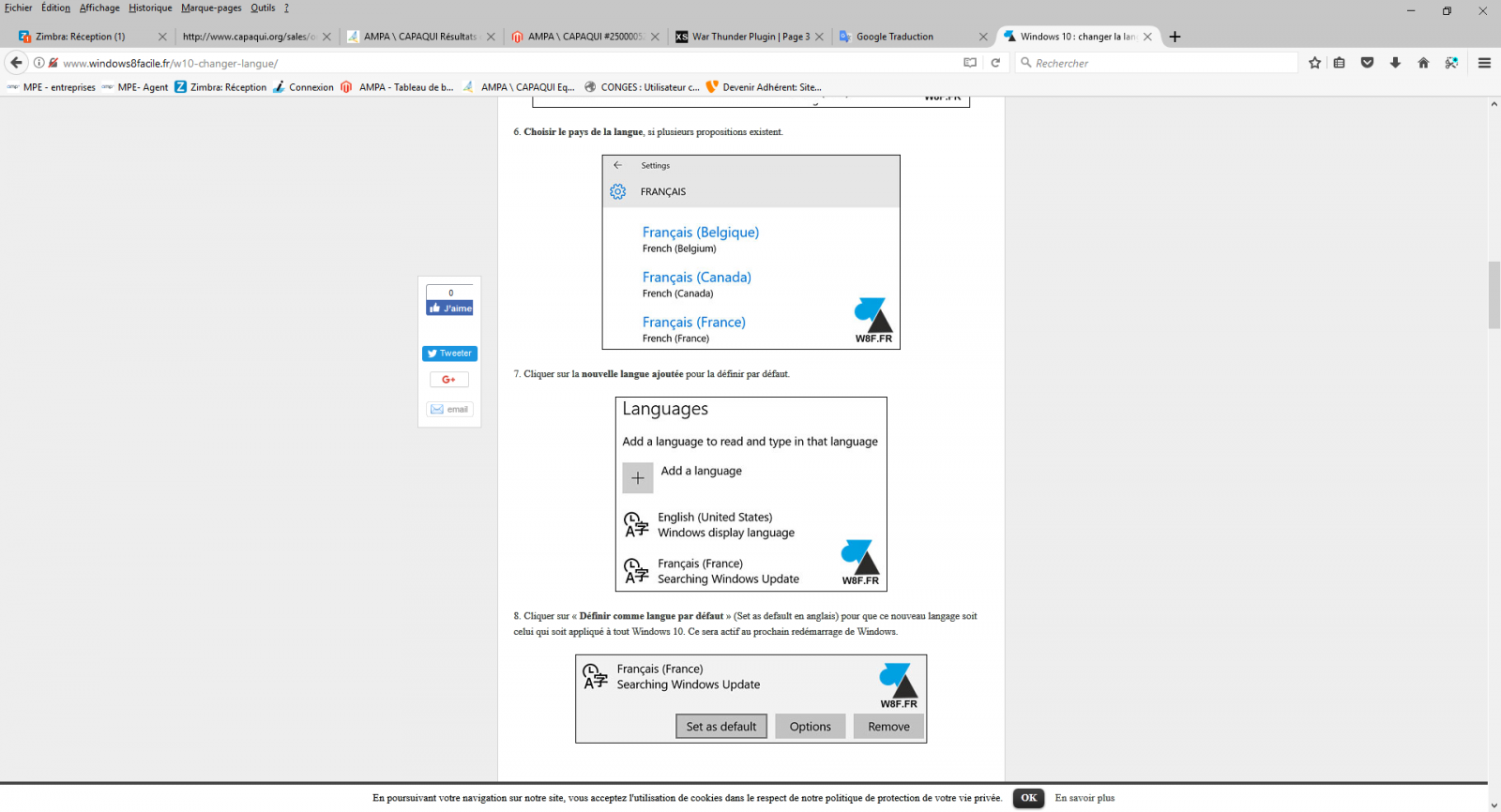

    last night i change in the windows 10 parameters region to united states (local) but windows stay in french. I change windows 10 in english for all the application ?
    22,230
    154,849Coins
    +11,229 / 57 / -2
    If you click on English (United States) under Languages @cedric33 you should have the option to set it as the default. Then reboot the computer.

    I'm disappointed, I changed the language in English, restart my computer and it is the same result. Any movement. I installed the plugin joystick for test, followed the procedure and doesn't work either. I dont't understand ?! Just the plugin assetto corsa work ! Thanks for help
  10. yobuddy
    51,780Coins
    +5,206 / 19 / -0

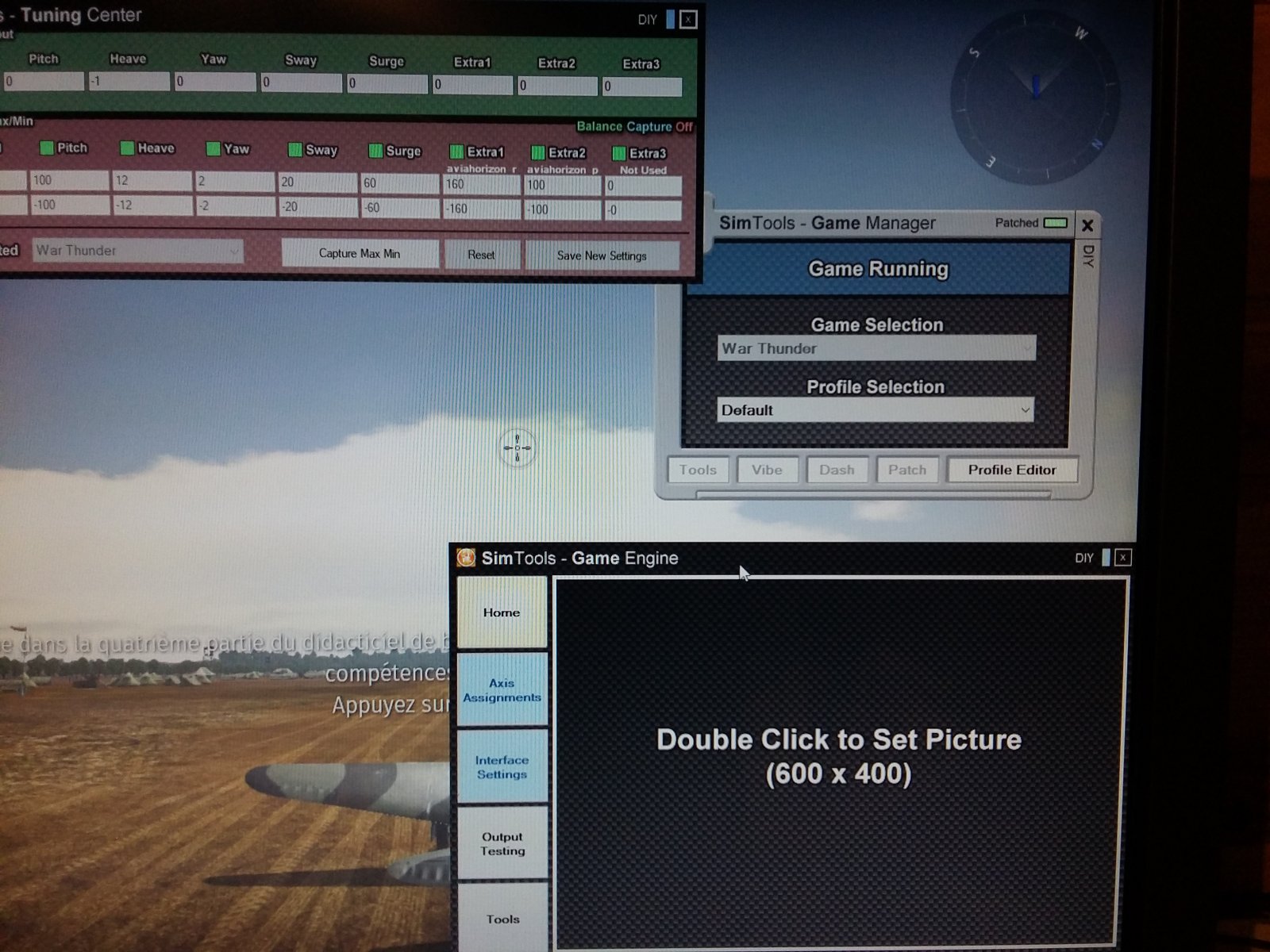

    @cedric33,
    Try recapturing the Max/Min values for the game.
    In the pic the roll and pitch are way higher than you sim can do for example.
    I bet it will really help buddy,

    I understand but the valor are at 0 in game - data output in tuning center when in game started. Any movement vs assetto corsa tuning center. Kind regards

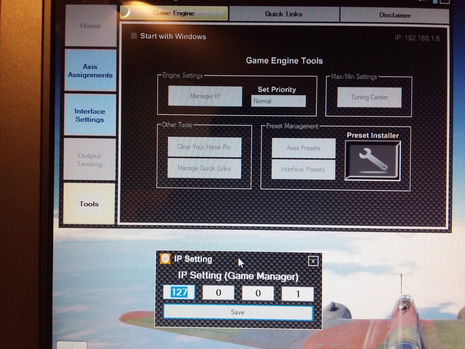

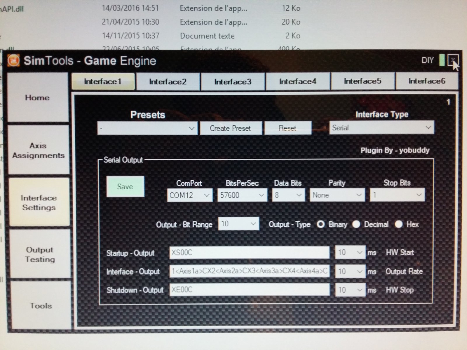

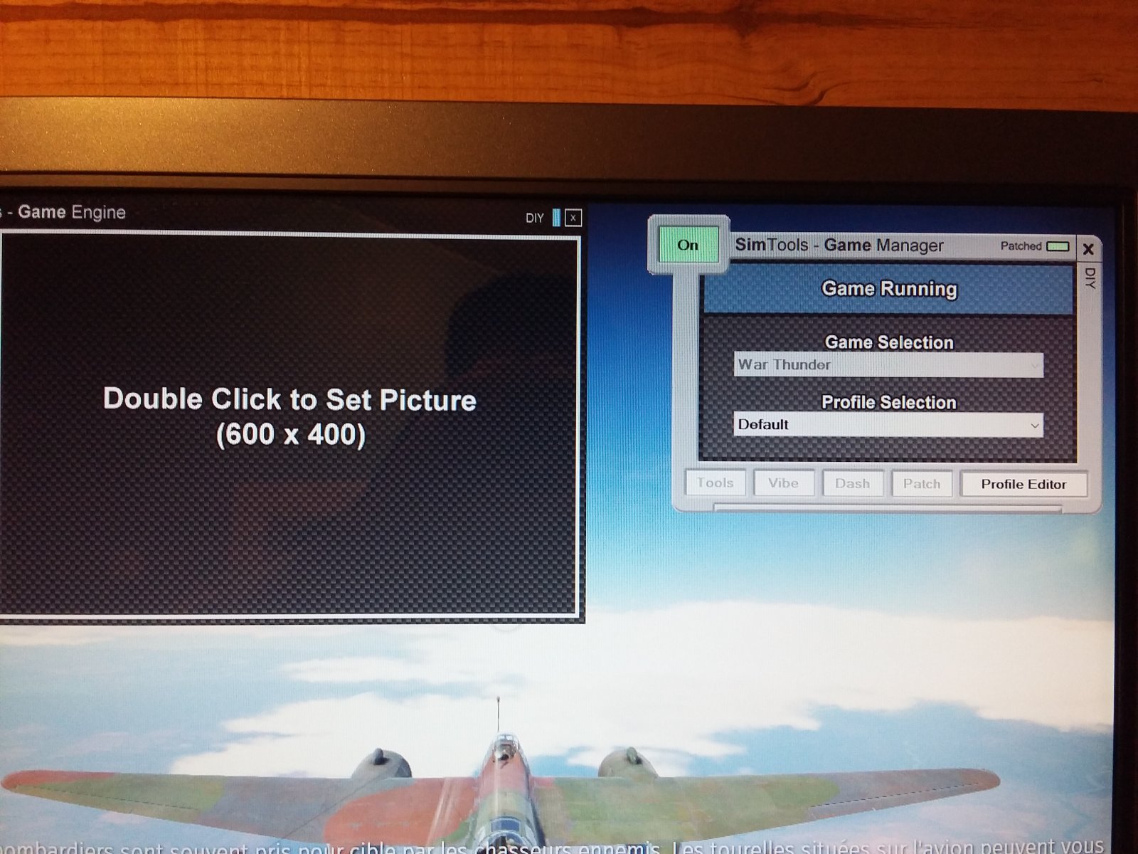

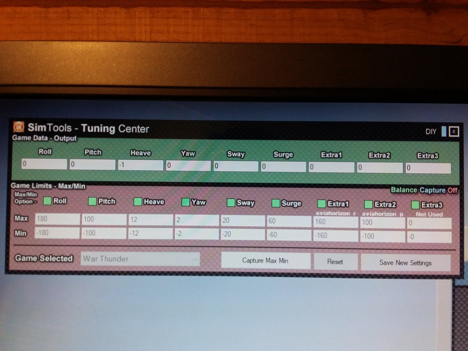

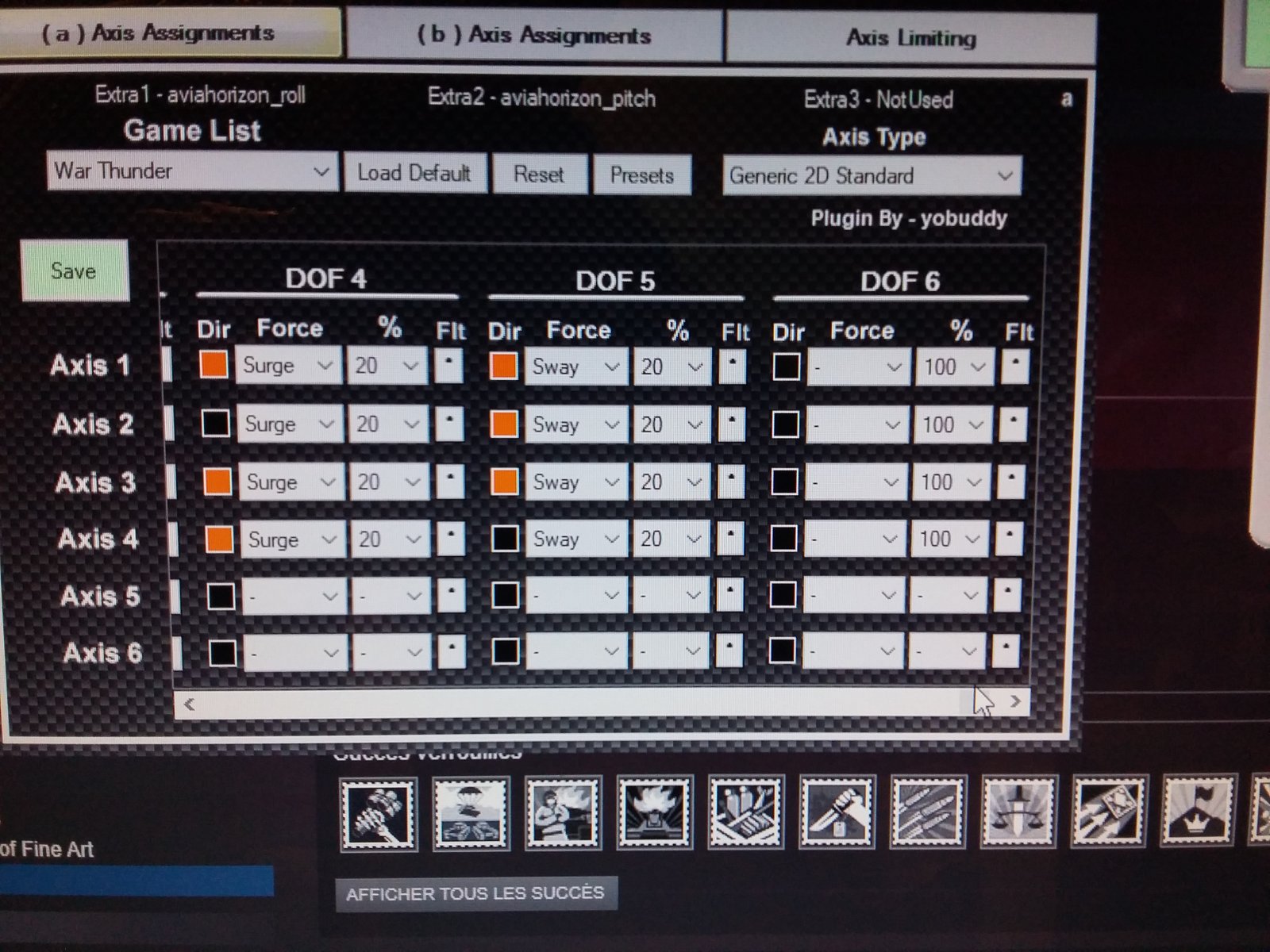

    Ok you check this pictures, I make a picture of interface setting this afternoon and after tell me please your opinion, this pictures are in game tutorial bombardier. thanks a lot 20171018_214049.jpg 20171018_214106.jpg 20171018_214930.jpg 20171018_214854.jpg 20171018_214809.jpg

    Don't use the tutorials @cedric33 use one of the existing planes and use the Test Fly option.
    Do you have a 4DOF motion simulator, which is what your settings suggest? My understanding was that you have a 3DOF SimuKit.
    Does your simulator properly follow these conventions of movement in Output Testing: https://www.xsimulator.net/community/faq/which-way-to-set-simtool-axis-movements.230/
    Again as per my earlier post I believe that this is an issue related to your setup or configuration, not the plugin. Hence it belongs in its own thread, so I will ask @Pit to move the relevant posts when he gets a free moment.

    Yes i have a simukit 3dof with 4 engine. Sorry, I'm a beginner and I try to find a solution. Where to post my request for technical parameter ?

    Does your sim move correctly in Output Testing?
    And can you please post a picture of your Interface Settings.

    yes my sim move correctly in output testing. As i said the plugin assetto corsa works perfectly for exemple. 20171019_213234.jpg

    Your latest picture still shows French is set as the language @cedric33.
    Do you have any firewall running and if so can you please turn it off to check if it is interfering, because if Output Testing works something is getting in the way of the information transfer.

    I changed the language in English, turned off the firewall, restarted the computer and it did not change anything. After that i changed into French because assetto corsa plugin works. So I don't understand why this one doesn't work. I have windows 10 there may be something else blocking ?
