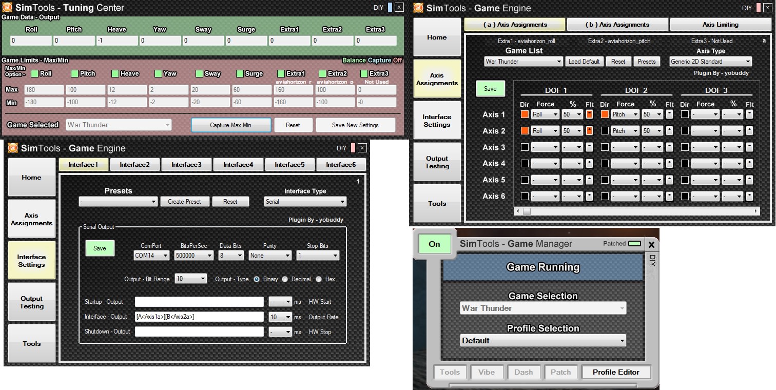

    It would help if you post pictures of all of your settings and a description of what you have or have not done, like capture Min/Max values in the Tuning Center.

    noorbeast,
    Ok, here are my settings:
    I have installed War Thunder plugin is v2.1.0.3. At tuning center seems to be nothing to capture as at output testing/virtual axis
    also no datas.
    If I change my local settings to USA english, all of my previous plugins working bad, resulting -strange movements,
    but War thunder plugins still not working. If I change back local to my lang, simtools and the other plugins
    working well, as before.
    Another strange thing: Now I'm using simtools 2.0. If I update simtools to v2.1, the same issue detected, so strange movements with plugins
    and with output testing/manual axis testing also. downgrading back to 2.0 resulting working well as before. but still no War Thunder movements.
    Any ideas???
    Thanx,
    George

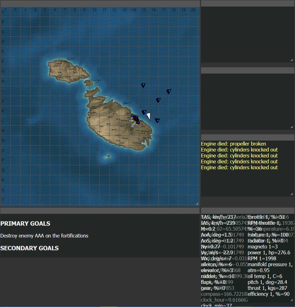

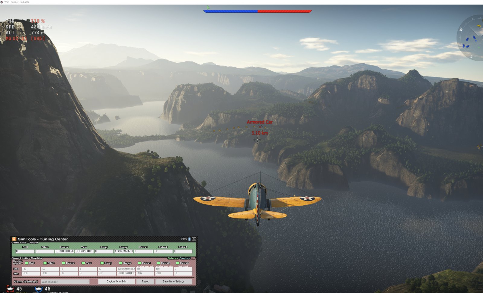

    Hi guys.
    First, big thanx to try to solve my problem!
    yobuddy,
    I have done that you suggested, uninstalled AVG free with your uninstaller, as everything has gone from the registry also.
    I have also turned off windows firewall totally. No changes, still not working. I tried to change local settings to US, resulted the same as before,
    strange movements as one motor gone 20% right (as with simtools 2.1), but still not working with the plugin.
    I have downgraded back to 2.0. Then I have tried to start the game in non VR mode also, -'coz in Elite Dangerous we have to
    use different plugins for VR, and non-VR versions- no success. It doesn't want to work in any modes.
    Ville Pesonen:
    Here is my screen capture of the site when playing:
    Cheers,
    George
